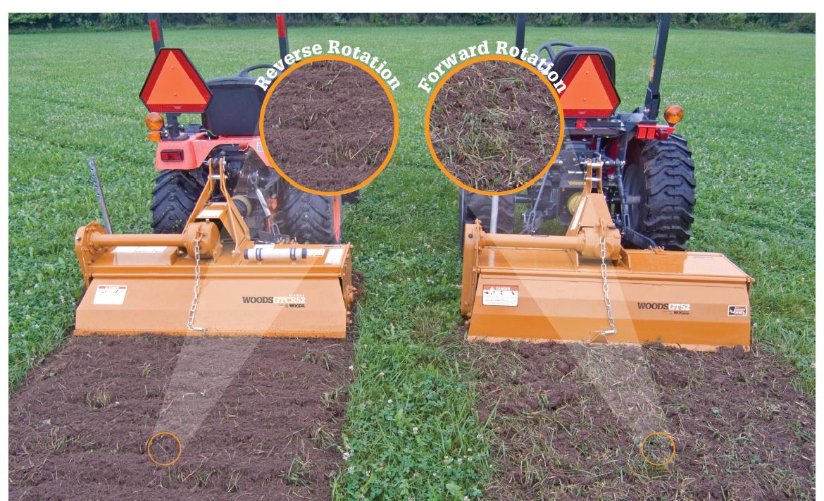

I am looking at starting a garden this spring, and a reverse rotation tiller from Woods is the same price as the forward rotation tiller.
I am looking at a GTR-52.
Anyone have any experience with reverse rotating tillers here?
I have a small tiller and it is MUCH more effective in reverse than going forward.
Also, this picture is hard to argue -- !!
eric

I have used it both ways on a tractor. If you are in clean soil meaning little or no rocks then they are great. if you have rock with a tractor then bad idea. You have a lot more power behind them then say a small walk behind. In the case of what i was using it was about a 55 Horse power tractor. When it hung a rock it was a total pain to get out sometimes and they would hit you. Bad experence on that one. also you will work the tractor harder on a CCWR instead of a CWR in hard ground. The ride is a little smother but it standes a better chance of thing breaking to when the rocks lock it up with that much torque. Just my 2 cents worth:):)
/ Woods reverse rotation tillers -- #5
I have used a 50 inch reverse tine tiller with a 24 hp jd2305 for two years. There only down fall is rocks and horse power. Baseball size and smaller get buried so you can not find them to throw out of the garden. Softball and larger will roll along in front of the tiller or they may wedge them selves in the tines. I have very few gardens that have any rocks so it is not a big deal to me.
Then there is horse power. It takes every thing the 24 hp diesel has. In an established garden these truly are the "one pass tiller" they are advertised but they will not save you any time. Because they need so much power your speed is reduced. I could make two passes with a forward tine tiller in the same amount of time as one pass with a reverse tine tiller.
The thing I like best about them is they don't push the tractor. This makes it easy to get close to a house or fence for a flower garden and not have to worry about being pushed into anything.

A KK gear drive forward rotation tiller in 60" width is $1100 - 1300. If you are able to get a reverse rotation tiller (and have the HP to use it) for about the same $, then go for it. They do a better job in rock free soils.
