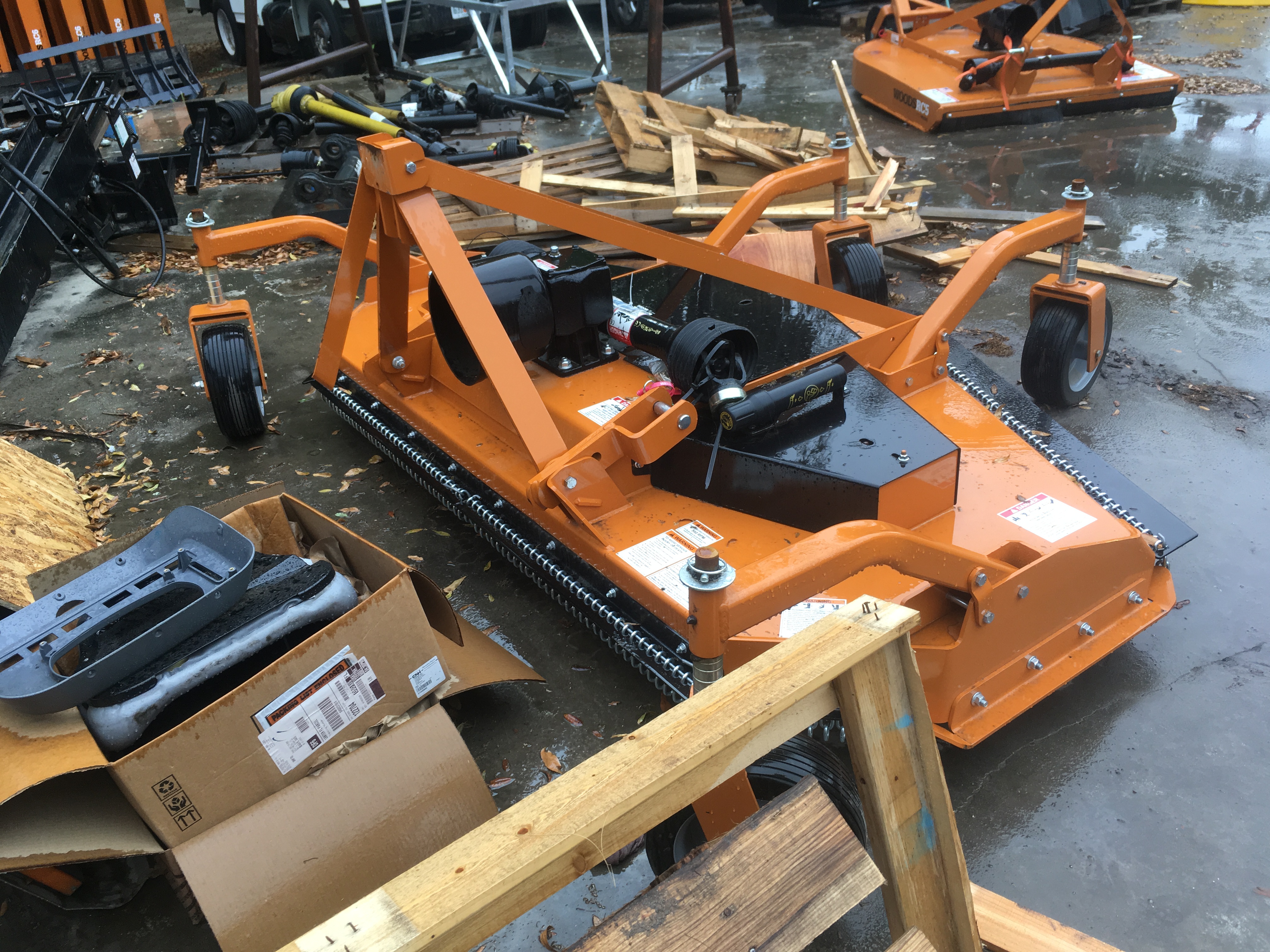

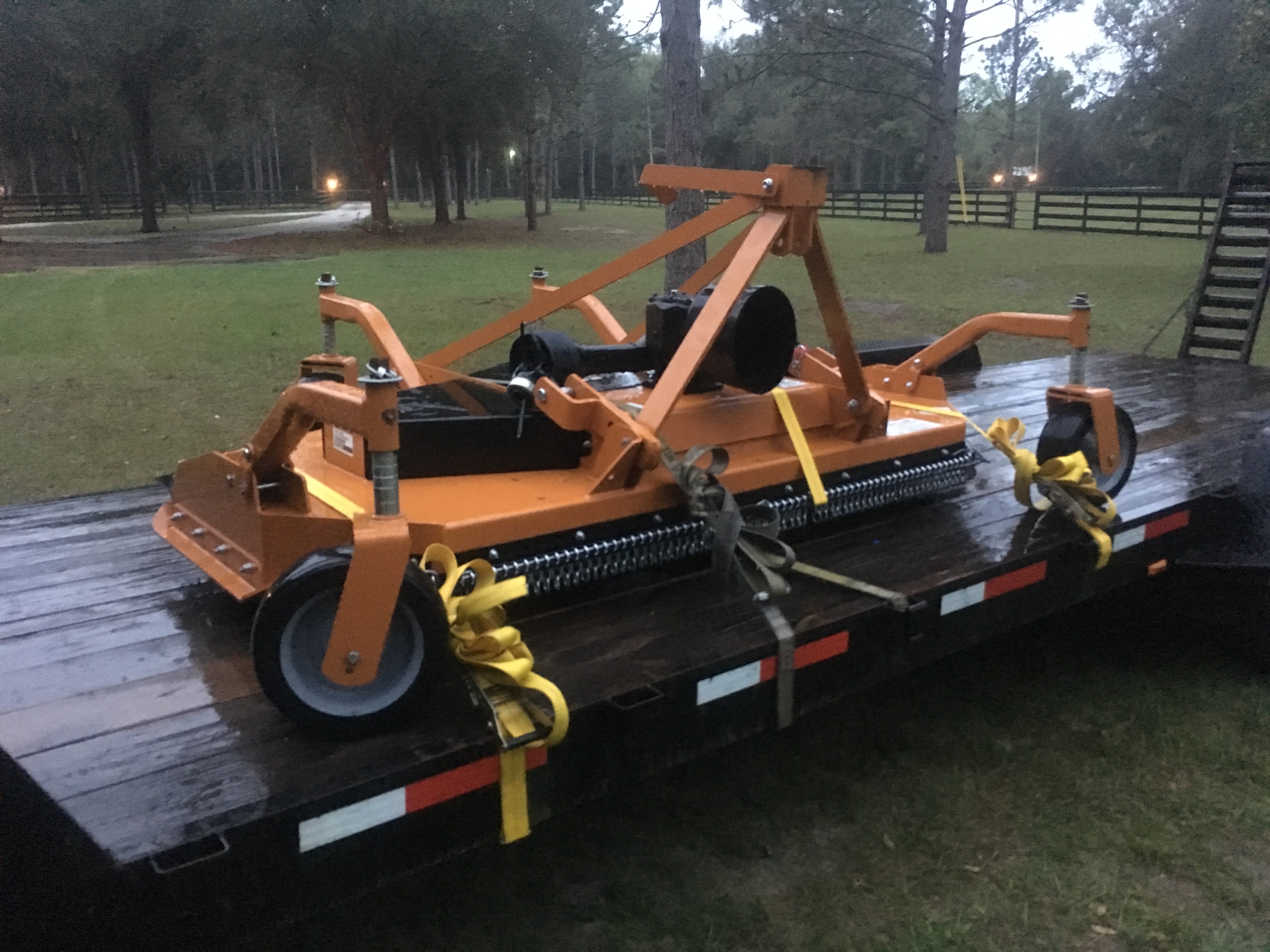

I picked up a new 990-X mower this week! There are a few threads talking about them but no reviews. I thought I would create a thread with some thorough feedback in case any one else out there is looking at one. I went with this mower for a few reasons - swing blades, higher HP rating, cutting height. I'm using a 70hp Kubota so most finish mowers cannot handle that much power. I'm mowing horse pastures and road sides around my home. I've been doing it with a zero turn mower but if I don't do it every week its easy to get bogged down with a zero turn mower.
Here's a few pictures of the day I brought it home. I'm hoping to break it in this weekend. That's one of the perks of living in Florida - pasture are growing on March 1! lol More details to come

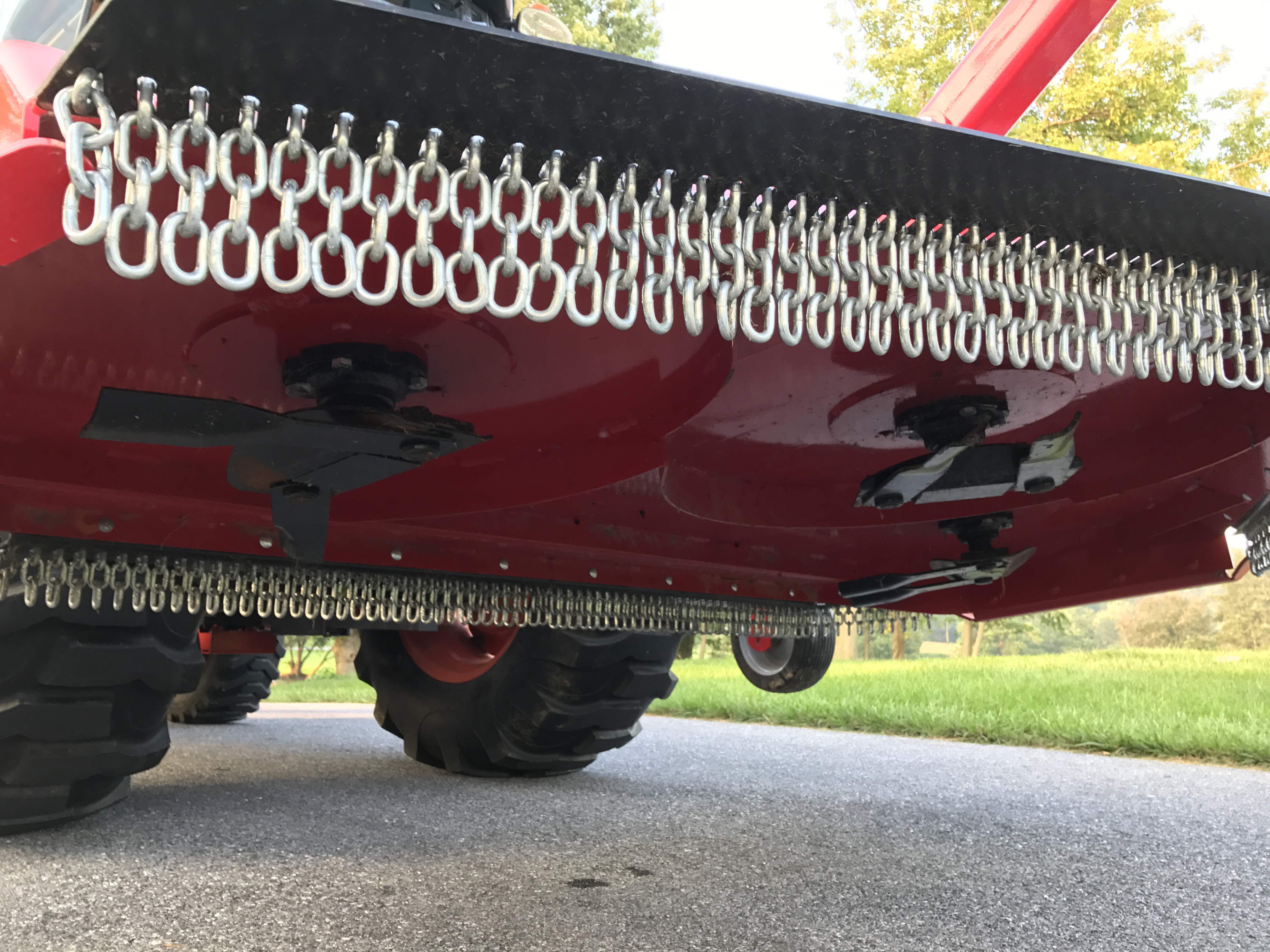

Here's a bottom view. My BIL test drove this one. He bought one just like it in orange to match his L4740.
