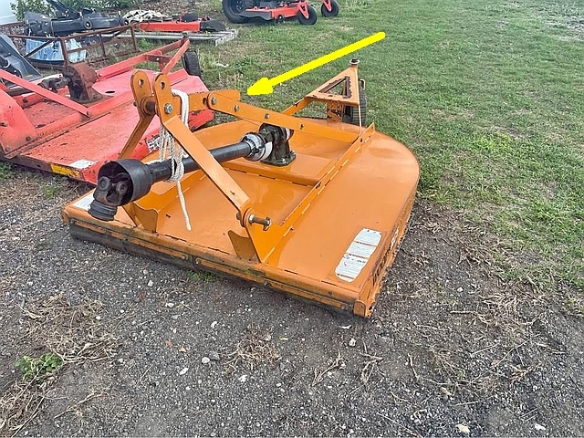

Mar 9, 2025 / Woods RC5 #1 dinoedwards Silver Member Joined Nov 15, 2021 Messages 149 Tractor kubota Was told I do not need a FLEX Link for this cutter that the arms move and eliminate the need for one? Also, round shaft so no slip clutch will work, must change out shaft. Just gonna get a few extra shear pins. Attachments woods.jpg 609.9 KB · Views: 120
Mar 12, 2025 / Woods RC5 #2 TMGT Elite Member Joined Jul 31, 2015 Messages 3,465 Location Stafford, VA Tractor Kubota L3240, BX2680, ZD21, W5021 They make slip clutches for round shafts so most likely you can add a slip clutch if you want. Does the top of the A frame slide in the brace? I have an older Woods mower that had a flex joint built into the A frame for the 3pt.
Mar 12, 2025 / Woods RC5 #3 Tinhack Elite Member Joined Jul 3, 2020 Messages 3,601 Location Lytle, TX Tractor Ford 3910, John Deere 420C, Kubota G32XKS, IH 2606, Bad Boy Maverick-60" Yes, round shaft clutches are available. This is your Flex Joint. It allows the rear wheel to rise and fall with the terrain. Edit: Added link to clutch. Last edited: Mar 13, 2025
Mar 13, 2025 / Woods RC5 Thread Starter #4 OP dinoedwards Silver Member Joined Nov 15, 2021 Messages 149 Tractor kubota Yes figured it out Tinhack, thanks, dealer told me have to change out gear, I'll be looking for a slip clutch go this going forward. Thanks again!
