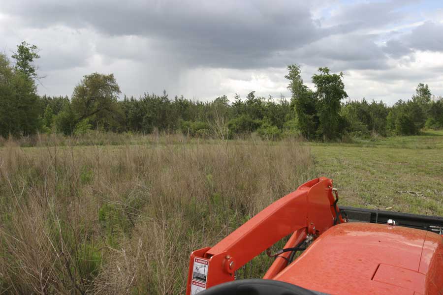

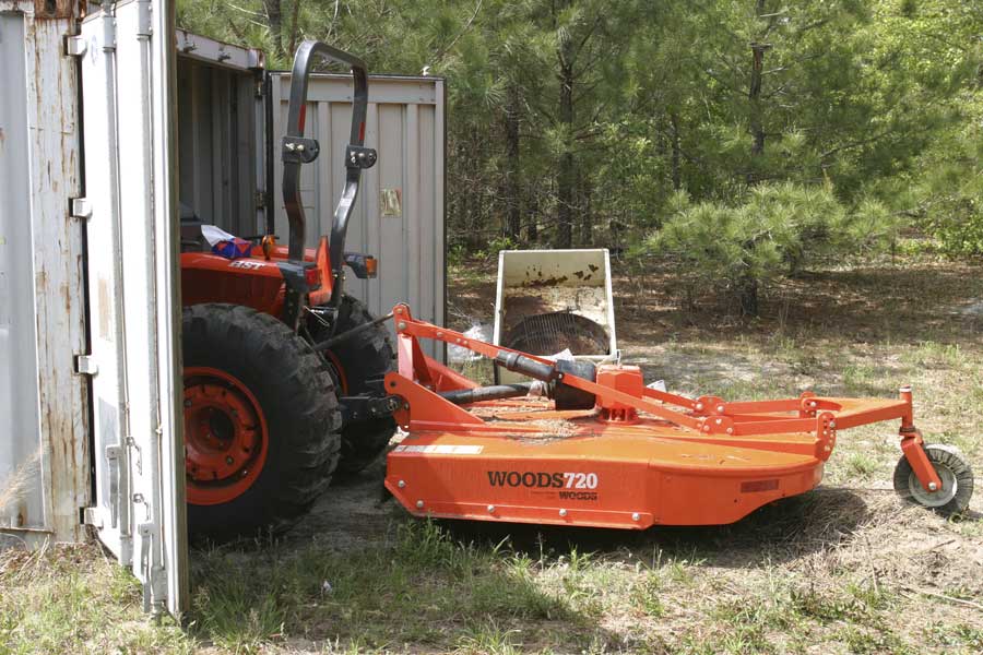

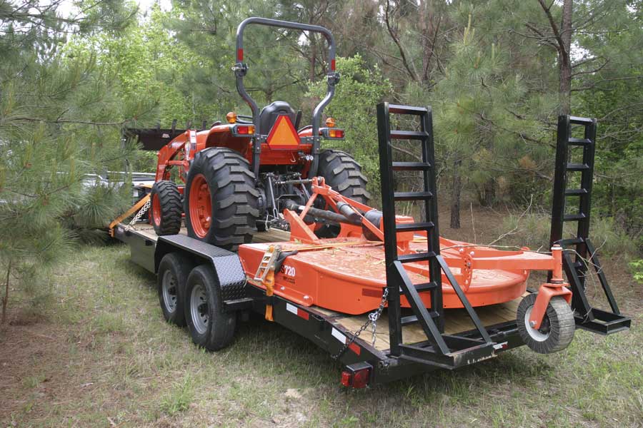

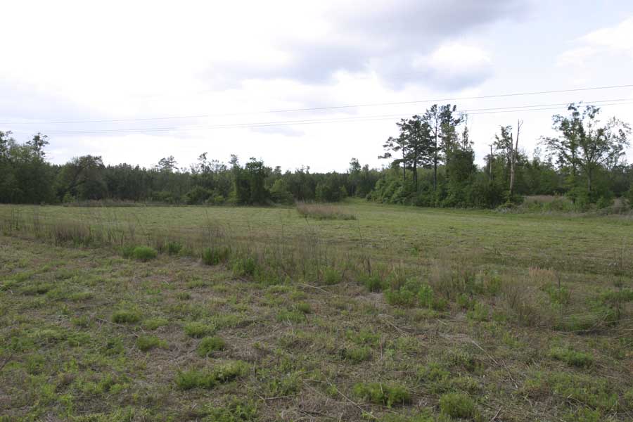

Finially have the internal baffle flipped and moved to the front. I am waiting on front and real chains so for now running the front rubber guard, front relocated baffle and removed the rear metal band since I am working out in open field. My BB720 has 2 positions to accommodate class 1 and class 2 hitches. The dealer set it up for class 2. I am trying the class 1 position now. Other than moving the baffle forward I think I am really going to like the bh. I tried several operating speeds from 540 (2600 rpm) to 300 pto rpm....cut just fine at a lower speed and did not bog at all 15-1800 rpm engine speed.
