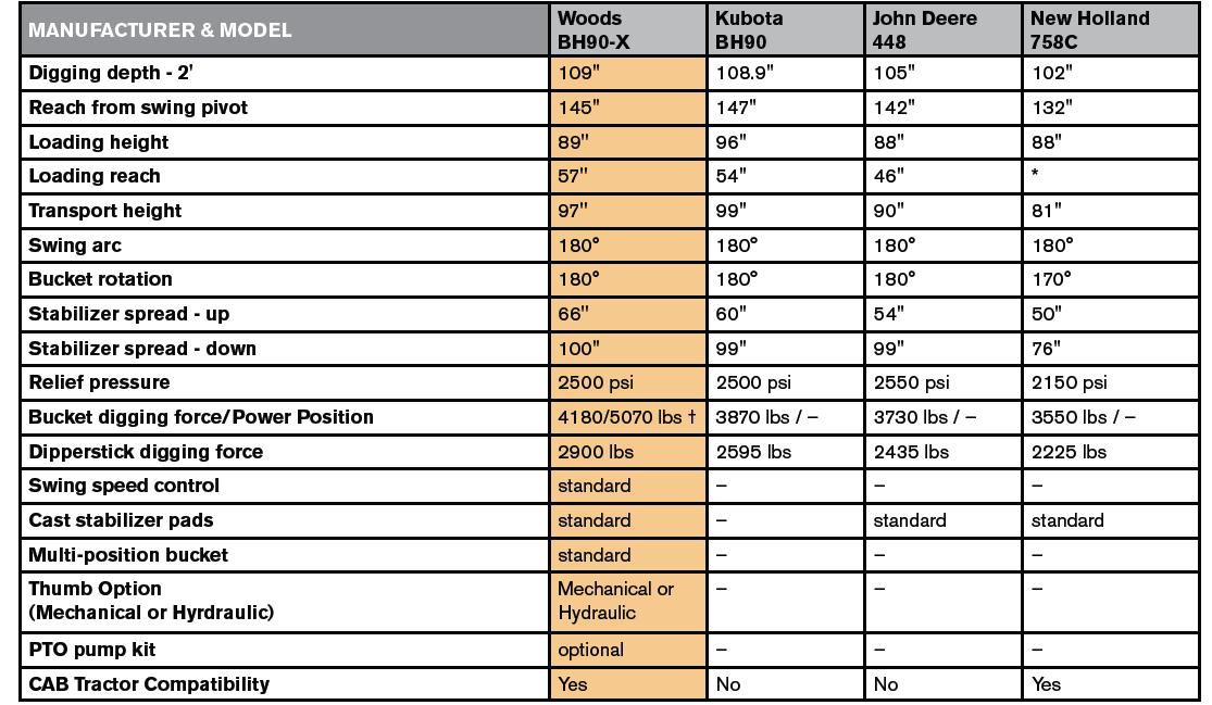

The quick specs on the Woods and BradCo are:
Digging depth: Woods - 9' 1", BC509/609 - 9' 8", BC511/611 - 11' 1"
Digging force: Woods - 5070 lbs, BC509/511 - 5676 lbs, BC609 - 5908 lbs, BC611 - 6167 lbs
Operating weight: Woods - ?, BC509 - 1425 lbs, BC511 - 1594 lbs, BC609 - 1702 lbs, BC611 - 1847 lbs
It appears that the BradCo stuff has a bit more capacity, but I think it is more pricey as well. I think Hayden mentioned that the BC511 setup was around $11,000, including mechanical thumb.

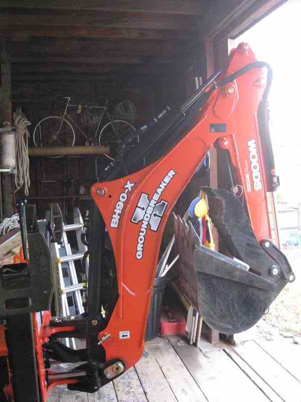

I have the BH90x with mechanical thumb and really like it. It is a well built BH and well designed. I've used it mostly for digging stumps so far. Other than a couple of difficult to reach zerks, I have zero complaints about the BH. Not certain I could buy the thumb if I were to do it again however. Nothing wrong with the thumb and if you don't have a grapple or grapple bucket it is certainly useful for moving stumps and rocks around but I find I don't use it as I have a grapple which is much more efficient for that purpose.
I think the price quoted is reasonable too.

/ Woods BH90-X Backhoe #6
I would recommend the thumb, (I have the 80x with thumb) though I have the excellent millonzi grapple on Island Tractor's recommendation. The reason is, when I have the backhoe on, I usually have the bucket on full of logs or stones to counterbalance the backhoe, so I don't have the grapple.
I'm looking into getting a hydraulic setup for the thumb, which I think will improve the utility considerably, as well.

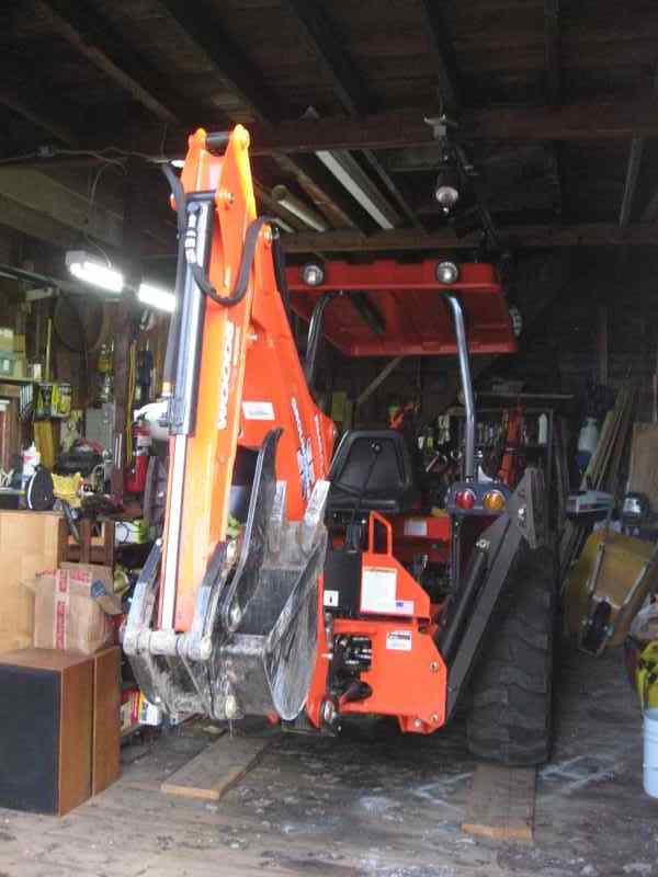

That would get you one of these: (photos)
Looks like we have the same taste in both flail mowers and backhoes.:)

Woods does not make a 9 inch bucket for the BH90x according to a local dealer I called. The 18 inch bucket is a good match for the 90x and is what I have. I dig up stumps mostly and my only complaint is that the holes are unnecessarily large. The BH has plenty of power to do stumps with the 18 inch bucket, I just don't wnat to dig a big hole every time I pull up a 6 or 8 inch stump.
I am investigating a ripper tooth. Woods doesn't make one. Brotek is willing to make one but their standard ripper is kinda small (meant for the BX24) and I haven't seen anything they've done for a bigger BH. Bradco stocks a ripper for Bradco hoes but I don't know if it is easily adaptable to Woods pin mount. Many companies make rippers for big excavators but no one seems to make one for the Woods.Going to a metal fabricator is a possibility but that could get pricey. Iron Horse (from down under) had a nifty one fabricated to his own design (see his photos on TBN) but he mentioned it cost about $900 to have fabricated. It would be a fun project to make one but I just don't have the time or skills to take that on. I think there is a market for an effective ripper design for tractor size backhoes, maybe some manufacturer like Markham, Millonzi, WRLong or even an aggressive dealer will take that project on (Rick are you listening?).
Regarding the thumb, I have the mechanical thumb but as I also own a grapple I don't use it much. I do think a hydraulic thumb would be more useful. I suspect it would be more expensive to try to add the hydraulic kit after taking delivery. It is not a trivial install (there is a control foot switch and a slew of lines to run). Personally, if I were to do it over I'd leave the thumb off but I admit that most people like them a lot.
