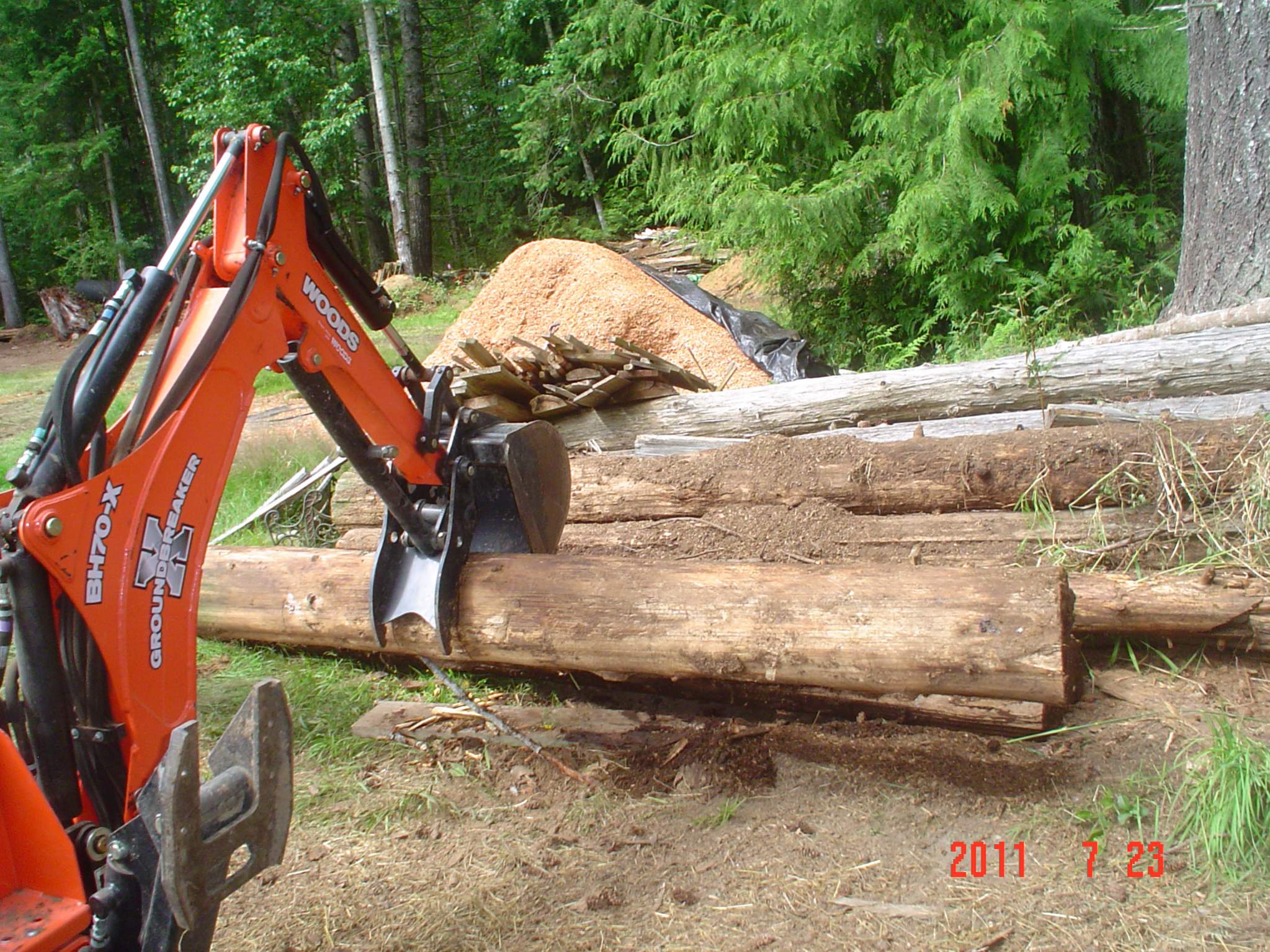

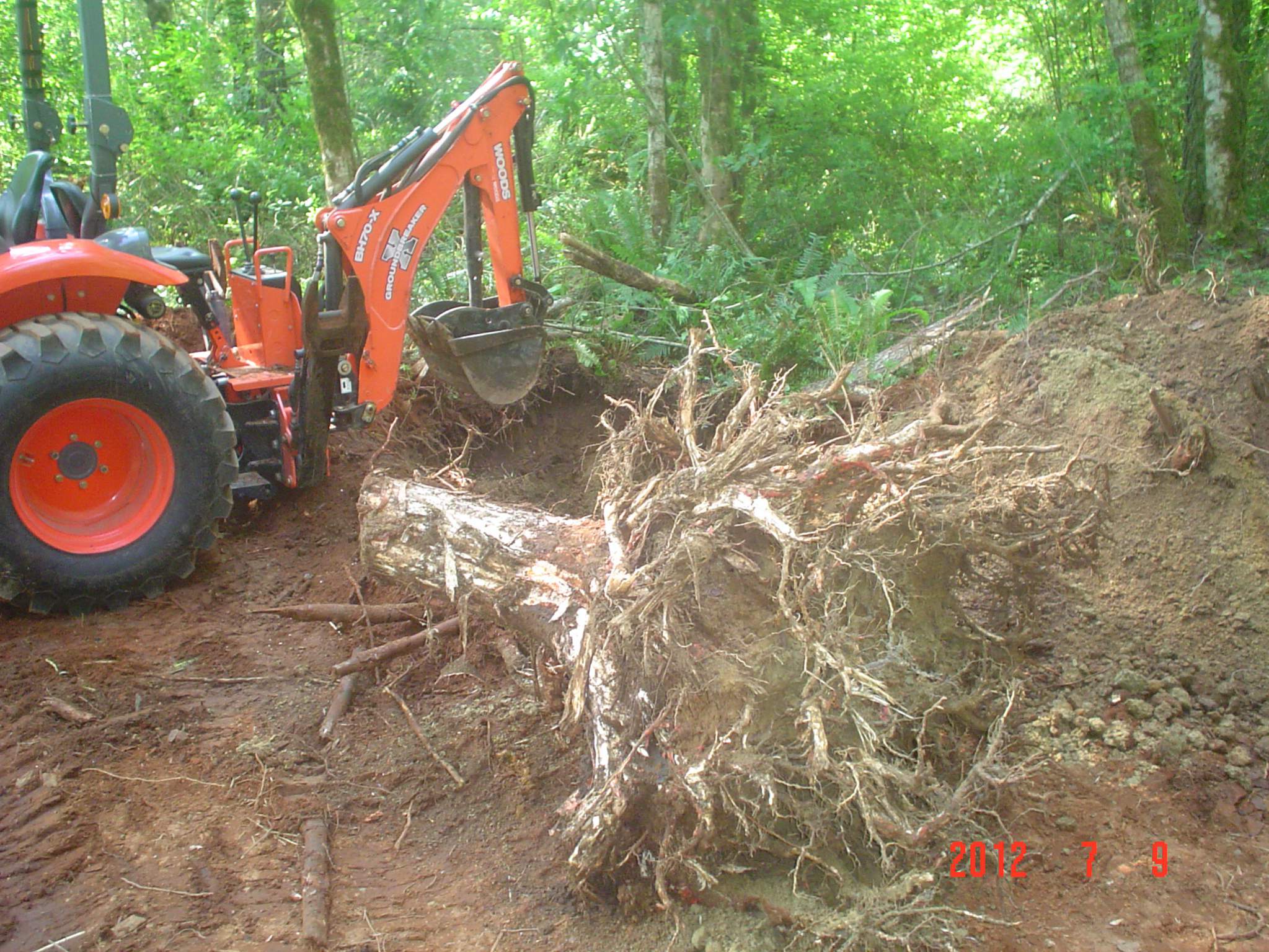

I have the Woods BH70-X, with thumb, on my CK35. Works great, as mentioned by an earlier poster you do not need high revs to run.
I am usually around 1700-1800 RPM.
