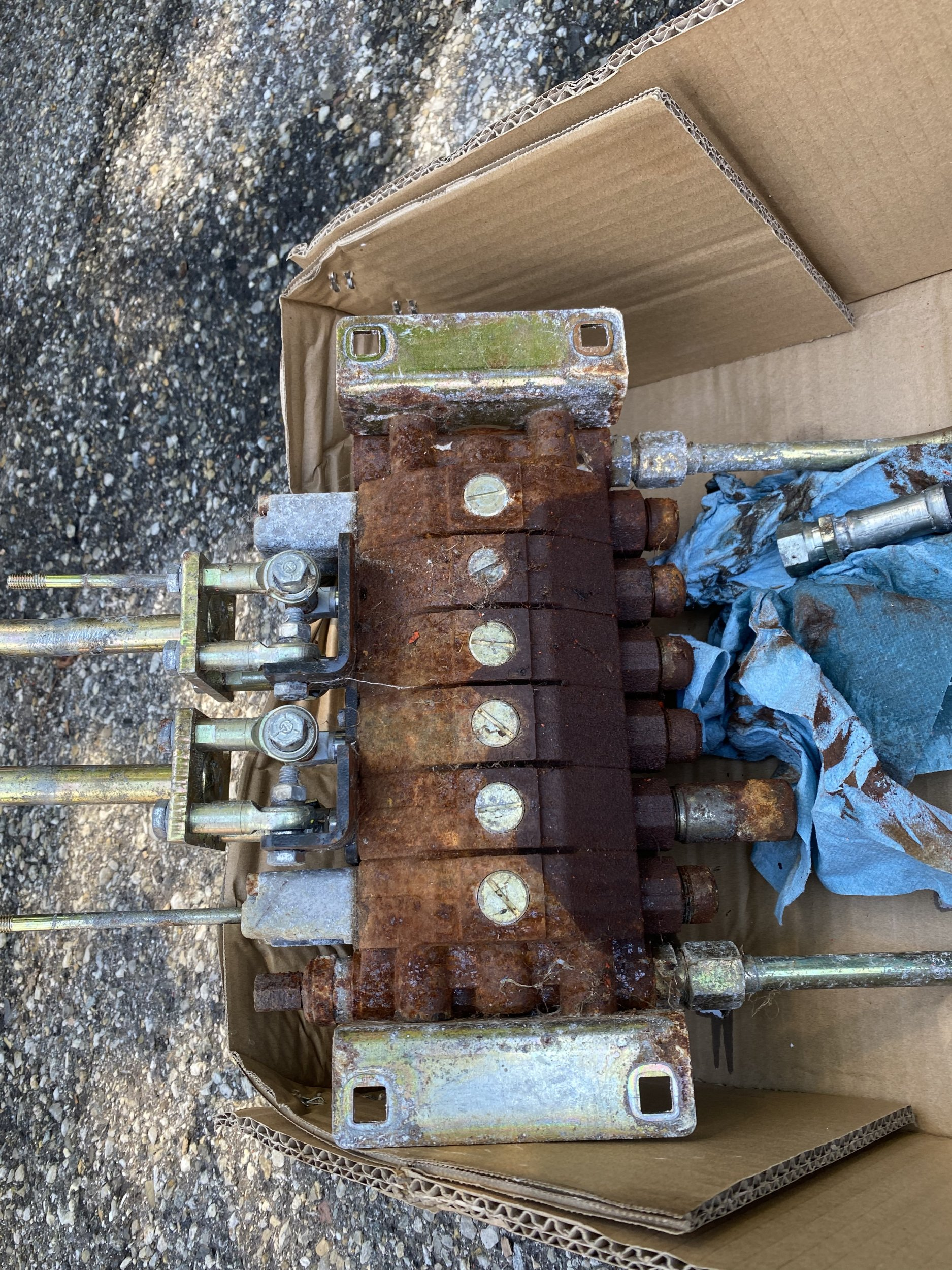

I’m in a process of painting my backhoe and the console valve is pretty rusty (see attached photo). Replacing it would cost me over $2K so that’s not an option but I was wondering if there is anything I can do to help and protect it. Is there any sealer/paint I can apply to stop or slow down the rusting process?

Those valves might not have ever been painted. CorrosionX spray last about a year. Keeps my mounting pins easy use by hand. Wasp and mice don’t like it either.
/ Woods 7500 backhoe- Console Valve
I'm glad I asked because the rust volume just didn't make sense to me. I don't think it was ever painted and on that note would it make sense to apply CorrosionX to clean the rust, clean it as much as I can (not the easiest object to clean), apply primer and paint? I just don't know what will CorrosionX leave on it and if that will make the painting more challenging or not?
/ Woods 7500 backhoe- Console Valve #4
CorrosionX might not be the best if you are going to paint. Paint can interfere if you ever have to take apart hydraulics to repair. CorrosionX will stop the rust. One of the few products to fog aircraft to prevent corrosion. Friendly to electrical and hydraulic systems. CorrosionX is a boat owner’s best friend and finds a welcome spot on the farm. Since I’m the head mechanic appreciate using the product. Particularly when having to take apart equipment again 5,10, 20 years later.

Do not use Corrosion X, or any similar product!
Use OSPHO as a primer, and then apply two thin coats of oil base enamel to the entire the assembly.
Use Corrosion X, Fluid Film, Boeshield, or LPS-3,.... AFTER painting, to seep into the spaces between the valves.

I didn’t see your reply before I went the Corrosion X route. All looks good and next time I’ll look into the paint option you mentioned. Thanks
