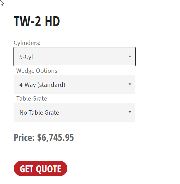

I like the TW but I would need a TW-3HD and 6k is just too much for 6-8 cords/year.
I think the SuperSplit is more in line with my wallet and needs.
   / Wood splitters #46
Have you looked for a better price? They can be bought for less than full price.
I've had mine for a while, but I'd be surprised if they doubled in price since I bought mine for about $3,300.. Even that may be more than what you want to spend though...
   / Wood splitters #47
My mistake. I would need the 29T TW2-HD.
Way over my budget to cut 18" oak at 8 cords/year
   / Wood splitters #48
Yeaaa, the price they put on them is really high, but not what you have to pay if you look around for one...but probably still higher than what you are wanting to pay.
SR
   / Wood splitters #49
I have oak and maple up to 20". What TW do I need? Their website has no suggestions.
The present model TW-2 is more than enough machine for Oak and Maple. (beech and black Birch too ;-) for me.
Perhaps a bit large to move around by hand, but with a grunt, it can be turned or pushed back and forth.
Cycle time is fast at full engine speed. So fast, I usually wait untill the cylinder has pulled the splitting head back only as much as is needed to split the length. (Again, I cut everything to 15 inches this year)
The crotches and tough stuff is easily coped with by removing the slide on 4 way. The two speed pump will drive the wedge through most any wood cross grain! Splitting knots is just a matter of a few seconds more cycle time for that piece,
The TW-2 I bought this summer was priced about 1/2 of the price shown for the TW-2HD on this thread.
I looked at a 3pt mount TW-2 offered used in my area. But I use the bucket and tongs to lift the rounds I can't budge. The normal "big rounds" are lifted using the B7200 mounted carry all. Puts the rounds right a splitter height ;-)
I think you will be pleased with a TW-2 but do have a look and compare for your own purposes.
