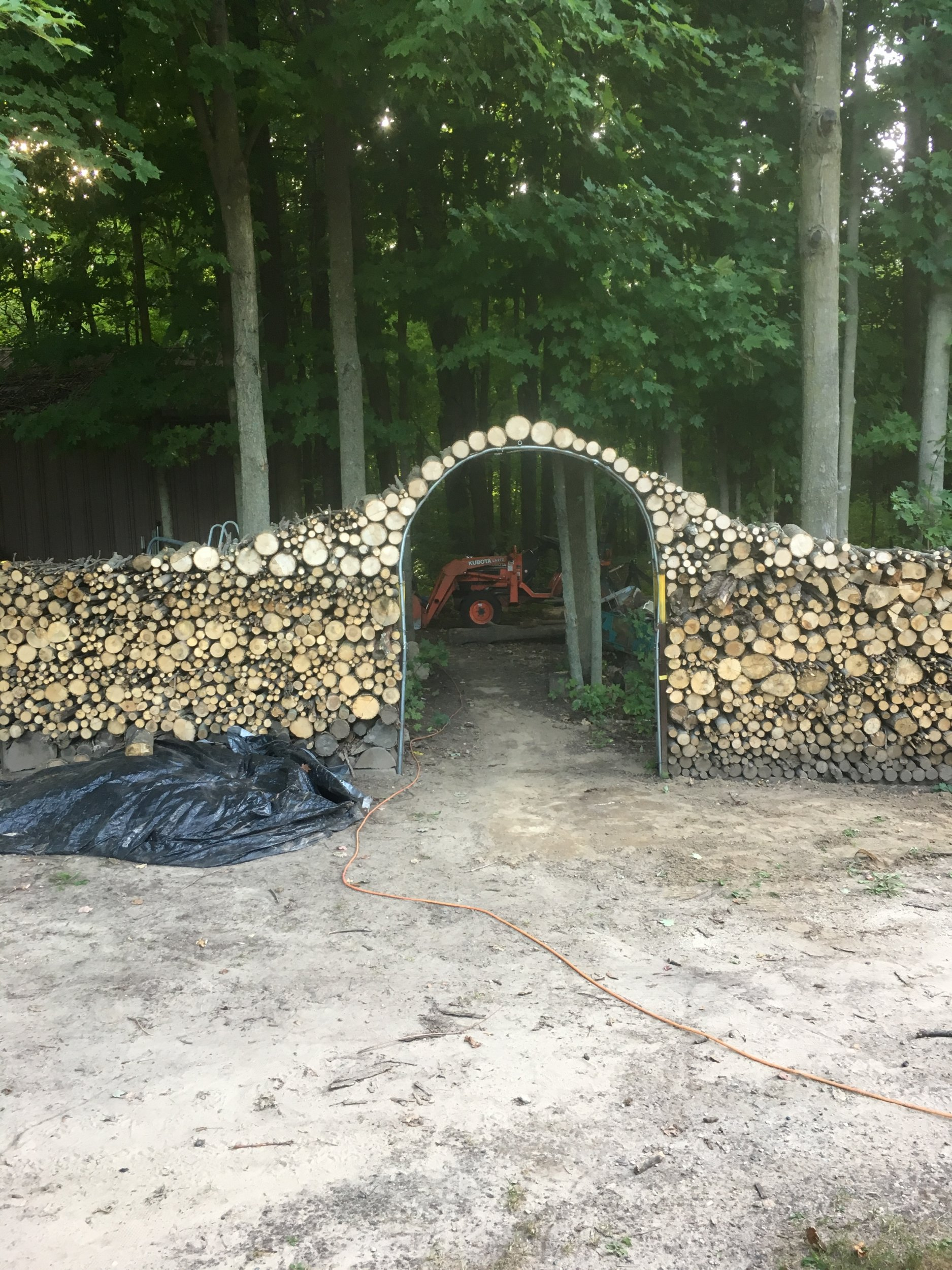

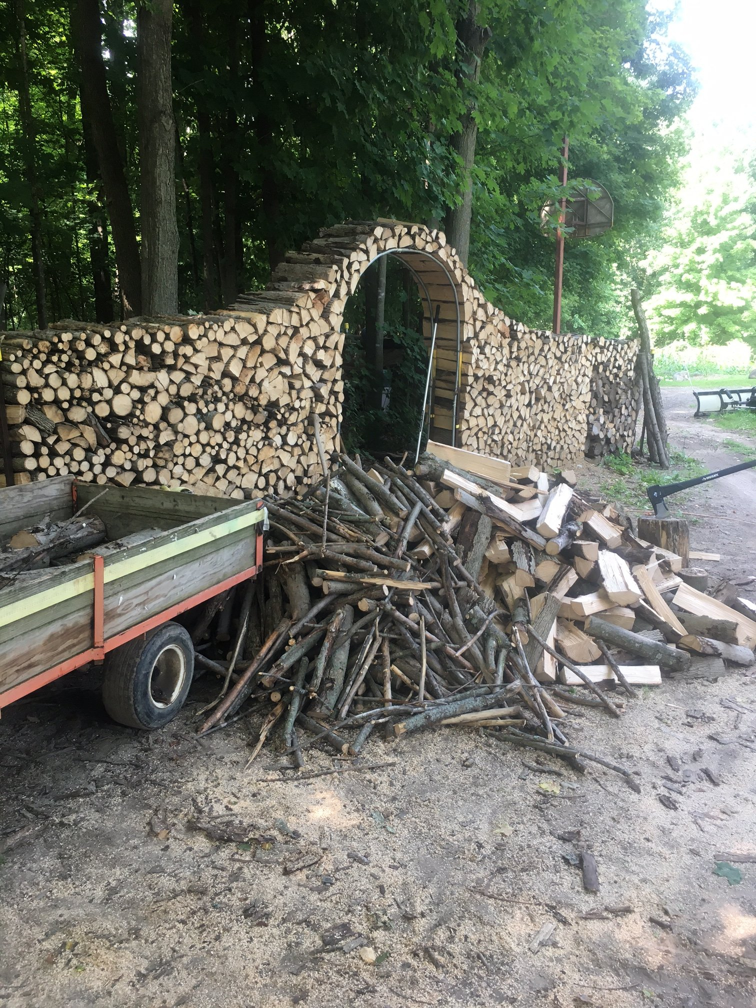

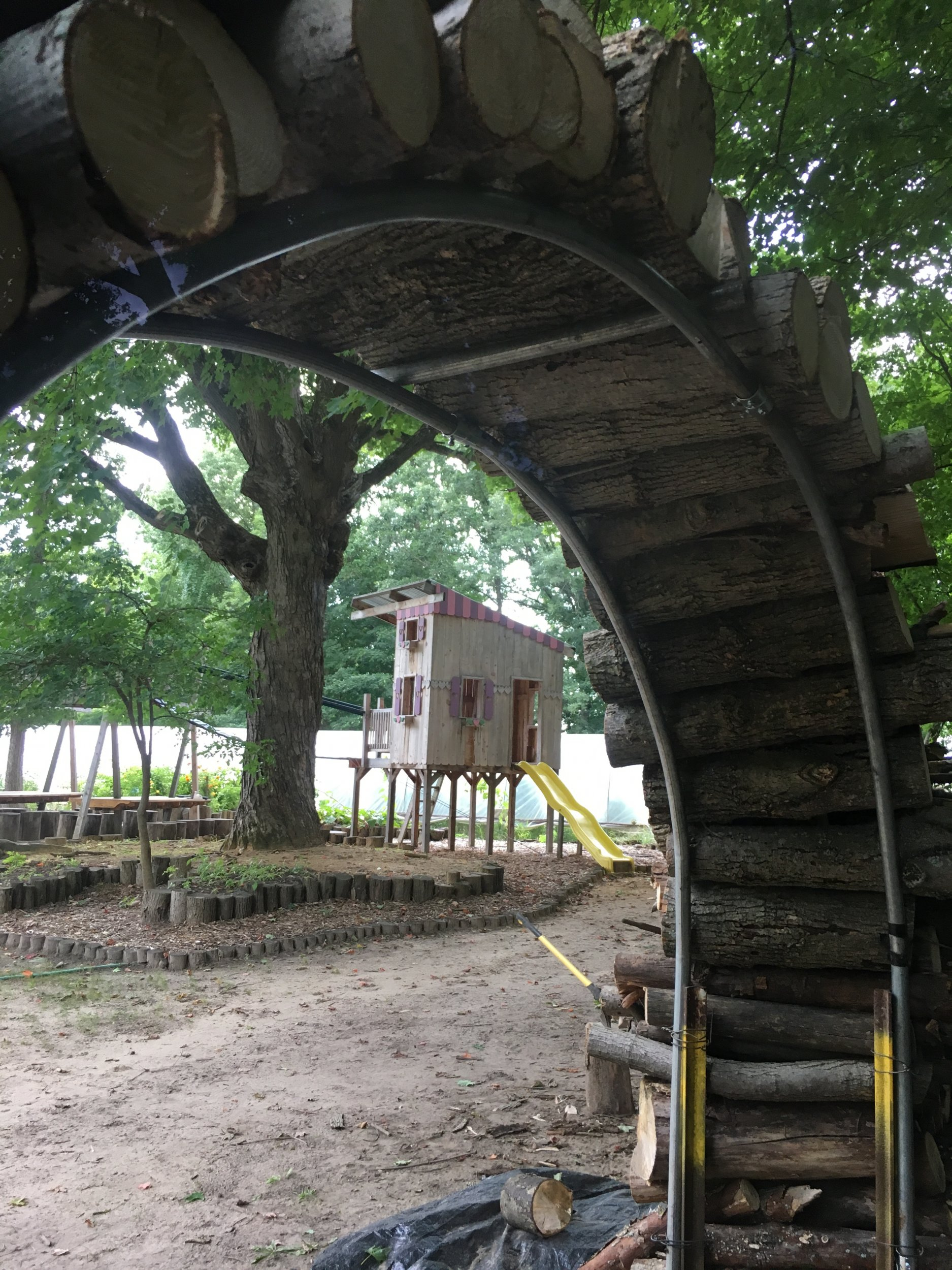

If you have health issues use a splitter? Maybe, but I think many machines promote obesity and health issues with many of us. You spend a lot of money to still lift and stack logs and physically move them out of the way, then to move more logs out of your way all around a big noisey machine. I prefer a 4 pound, $40.00, splitting axe for many reasons, here the top 10: 1. Faster than most hydraulic splitters. 2. No yelling while working. Shouting over motors moving wedges is dangerous. 3. Most who have splitters use 2 people to do a one person job. 4. Teaches you to read your wood which comes in handy for felling trees and bucking logs stuck between trees in the woods 5. Absolutely great cardio and general exercise. If you can't split with an axe then why get a splitter? 6. Grandkids love trying to outsplit grandpa creating healthy, quiet outdoor family time. 7. Quieter by far and non-polluting, no breathing fumes. 8. Listening the the whack of a log splitting around an axe head and thumping the splitting log in early morning, a one of a kind sound (I tap log, lift, flip over and let weight of log hitting axe on stump split the log). 9. It heats you up doing the work, true heating you 3 times. 10. Satisfaction of the fruit of your labor, heating your house for the winter.
Showing how arch was made.
Part of 4 full cords of wood, used as a privacy fence during the year.
Gate to the barn, EMT tubing lashed to t-posts.

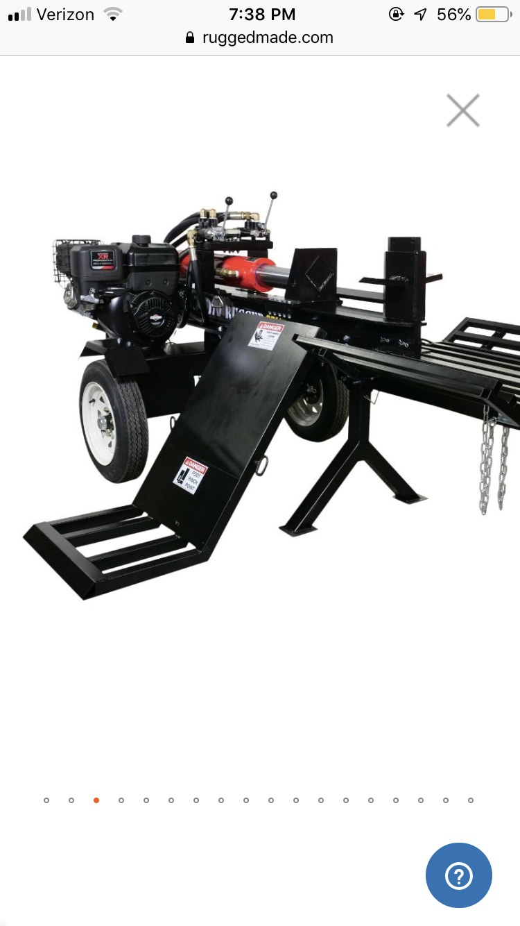

What are you guys using for splitters with faster cycle times?
Split-Fire 2265.
3 to 4 second cycle time each direction on straight wood. Knarly stuff takes longer, but don't process much tuff wood. Split hardwoods when they are freshly cut. Split softwoods when the rounds have dried.
Run the engine a half rpm most of the time, will run all day on a tank of gas.

If you have health issues use a splitter? Maybe, but I think many machines promote obesity and health issues with many of us. You spend a lot of money to still lift and stack logs and physically move them out of the way, then to move more logs out of your way all around a big noisey machine. I prefer a 4 pound, $40.00, splitting axe for many reasons, here the top 10: 1. Faster than most hydraulic splitters. 2. No yelling while working. Shouting over motors moving wedges is dangerous. 3. Most who have splitters use 2 people to do a one person job. 4. Teaches you to read your wood which comes in handy for felling trees and bucking logs stuck between trees in the woods 5. Absolutely great cardio and general exercise. If you can't split with an axe then why get a splitter? 6. Grandkids love trying to outsplit grandpa creating healthy, quiet outdoor family time. 7. Quieter by far and non-polluting, no breathing fumes. 8. Listening the the whack of a log splitting around an axe head and thumping the splitting log in early morning, a one of a kind sound (I tap log, lift, flip over and let weight of log hitting axe on stump split the log). 9. It heats you up doing the work, true heating you 3 times. 10. Satisfaction of the fruit of your labor, heating your house for the winter. View attachment 715756
View attachment 715754 Gate to the barn, EMT tubing lashed to t-posts.
Well...
Most of your wood is not split.
Wait until you cannot split wood without your hands going numb.
Enjoy your good health while you have it
I used a maul and wedges until I was 62, but it would be very difficult to split the quantity of wood I use now.

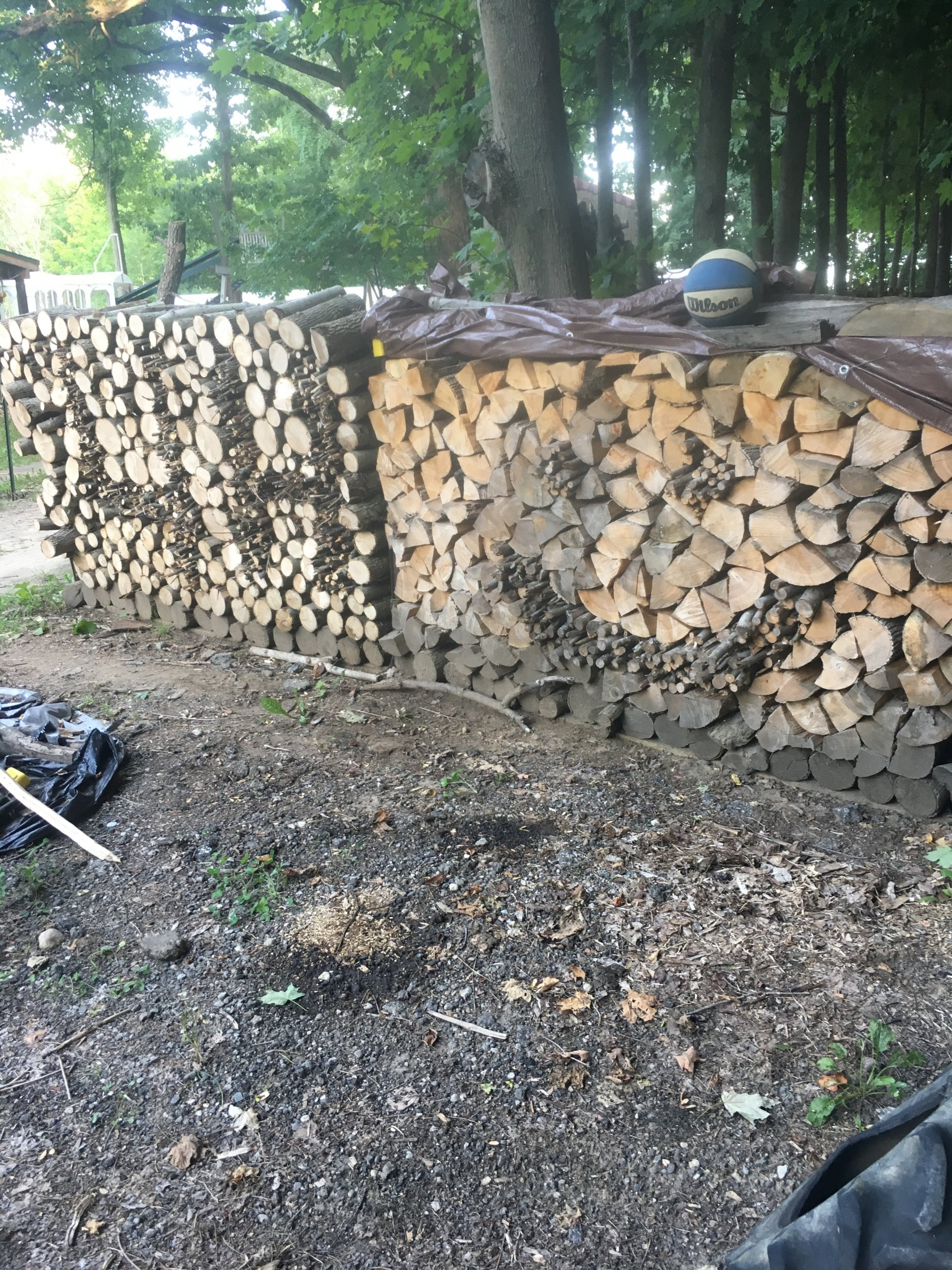

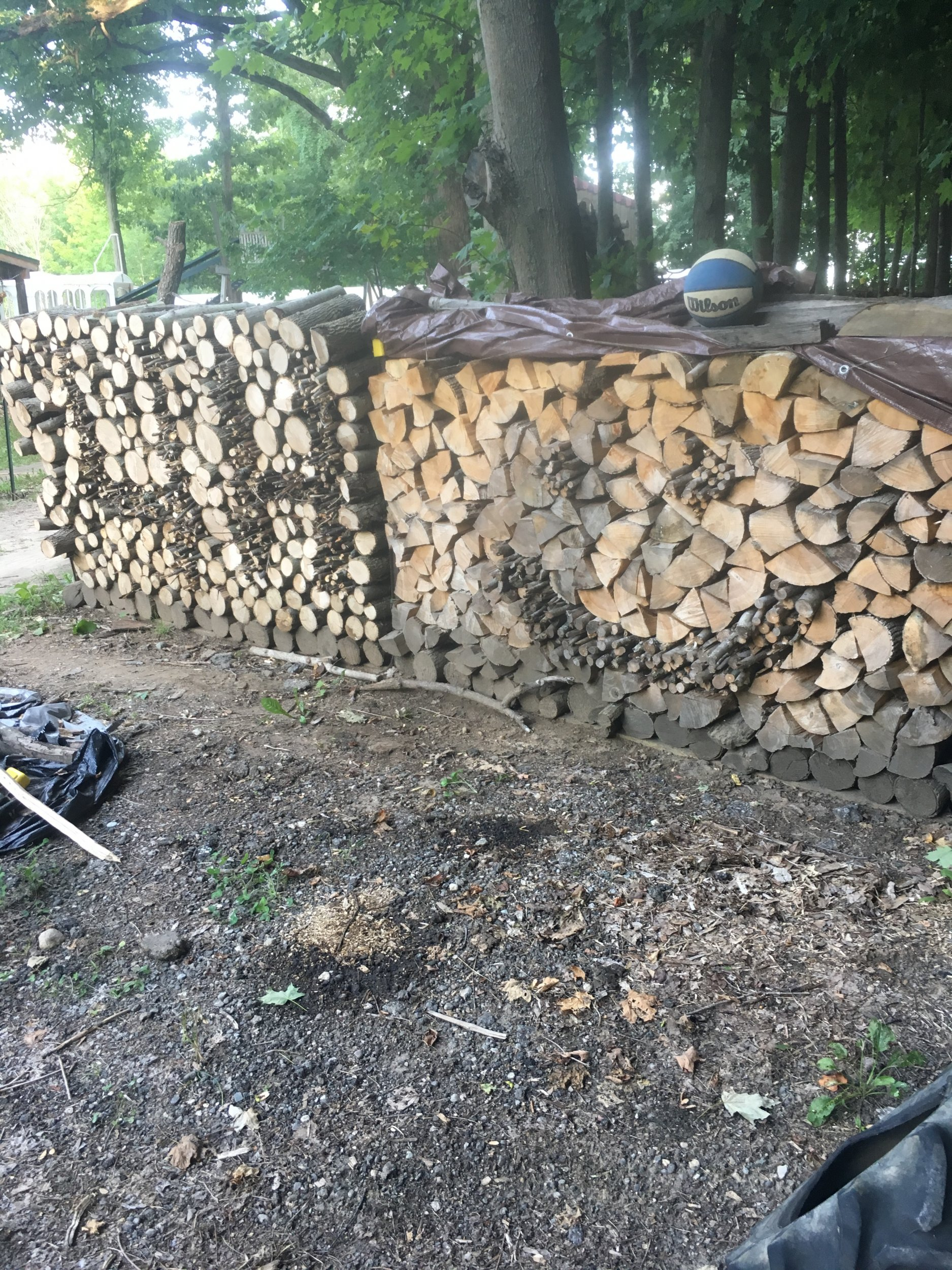

Sorry, was showing part of the volume of wood we use , Images are from last year. Here is an image from this year, July, you can see my splitter in the image (axe) on the stump. Nearly all is split with the exception of what will fit in my wood burner without splitting. Every year is different and depends on what is available, but all that is split is with an axe. I find this version, copied from swedish versions, is the best yet as I have had several over the years. The heavier mauls are too bulky for how I split wood. 100% is cut with Stihl electric chainsaw and split with the axe. If you zoom in you will see most is split. I am 66 years old, by the way and believe this exercise helps keep me the 4 year old I am inside, rather than sitting on the couch. Hard work is good for all, and sometimes the simplest ways are still the most productive. Thanks for pointing out the "unsplit" in the images I used.

Sorry, was showing part of the volume of wood we use , Images are from last year. Here is an image from this year, July, you can see my splitter in the image (axe) on the stump. Nearly all is split with the exception of what will fit in my wood burner without splitting. Every year is different and depends on what is available, but all that is split is with an axe. I find this version, copied from swedish versions, is the best yet as I have had several over the years. The heavier mauls are too bulky for how I split wood. 100% is cut with Stihl electric chainsaw and split with the axe. If you zoom in you will see most is split. I am 66 years old, by the way and believe this exercise helps keep me the 4 year old I am inside, rather than sitting on the couch. Hard work is good for all, and sometimes the simplest ways are still the most productive. Thanks for pointing out the "unsplit" in the images I used. It is easy to outsplit nearly every hydraulic splitter out there if you split often. Not bragging, FACT due to the time spent on recycles and moving wood out of the way that requires 2 people to beat the splitter.
/ Wood splitters #32
Sorry, was showing part of the volume of wood we use , Images are from last year. Here is an image from this year, July, you can see my splitter in the image (axe) on the stump. Nearly all is split with the exception of what will fit in my wood burner without splitting. Every year is different and depends on what is available, but all that is split is with an axe. I find this version, copied from swedish versions, is the best yet as I have had several over the years. The heavier mauls are too bulky for how I split wood. 100% is cut with Stihl electric chainsaw and split with the axe. If you zoom in you will see most is split. I am 66 years old, by the way and believe this exercise helps keep me the 4 year old I am inside, rather than sitting on the couch. Hard work is good for all, and sometimes the simplest ways are still the most productive. Thanks for pointing out the "unsplit" in the images I used. It is easy to outsplit nearly every hydraulic splitter out there if you split often. Not bragging, FACT due to the time spent on recycles and moving wood out of the way that requires 2 people to beat the splitter.View attachment 715761
Maybe if you’re splitting 6” rounds that you can split in one hit. If you throw anything challenging into the mix and you’re loosing your lead quickly. You’d be hard pressed to outwork a cheap hardware store spitter. You have zero chance of out splitting a semi commercial splitter with a 4 way like the OP is considering. I don’t really see the problem with moving the splits either. You might as well stack them as they come off the splitter.
