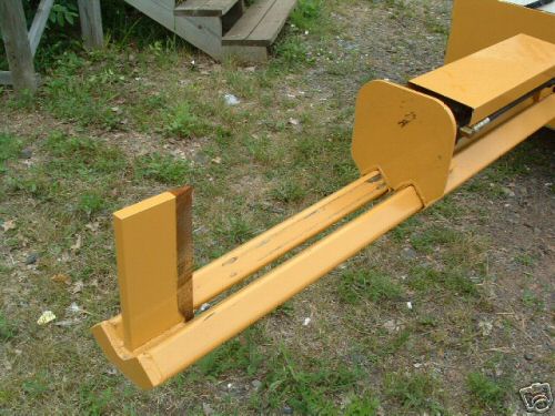

Check this one out.
I think that I would add more bracing.

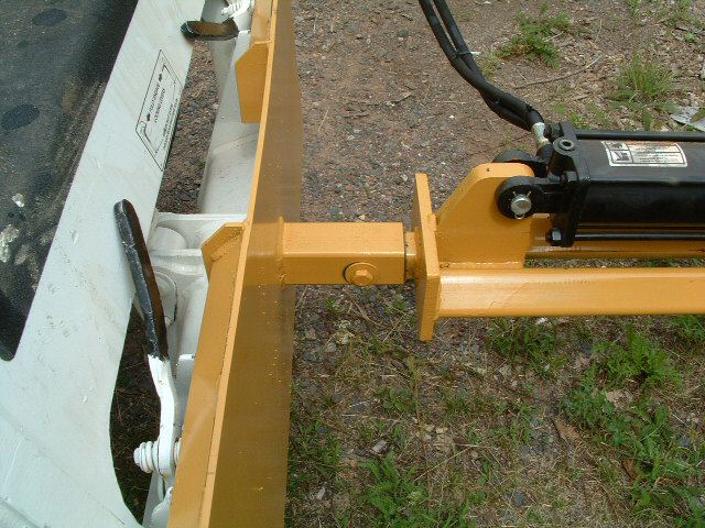

This is the other end.

/ Wood splitter #77
Thanks J.J.
I saw that one on ebay, but did not notice the trailer hitch type attachment, good catch!
I agree that I would brace the tube coming out of the adapter plate and also make the connector on the main tubes a little longer with more bracing. That's why I thought welding it to the bottom and side of the I-Beam (on the other) would create more strength?
If I used the Northern Tools version, I would probably relocate the valve to the side of the I-Beam so that it never ends up on the bottom like when I flip it 180 degree.
I just called the guy, (Don), and left a message for him to call me back. I am curious how much it weighs too.
Stray: This is very close to what I was thinking of to be able to rotate the splitter.
(come up with an idea and it's most likely that J.J. has a picture of it!) /forums/images/graemlins/wink.gif
