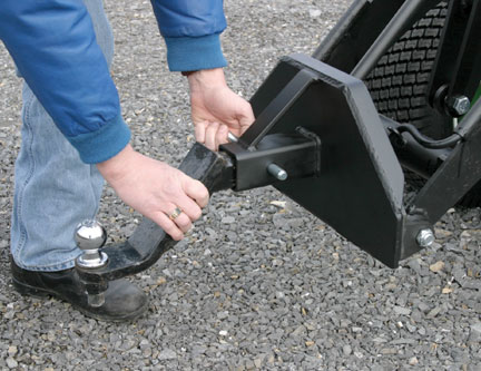

J.J. I was looking at the Northern splitter and it is pretty light at 290 lbs. I am welding a heavy duty trailer hitch receiver for my 425 and wonder if I could mount this splitter with a square tube welded to the beam that would allow me to rotate it 90 or 180 degrees? I wonder if the hitch would hold it, let alone with a log in place?
The attached pic shows the PT adapter. Mine will have some heavy gussets on all fours sides of the tube.

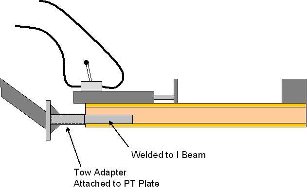

Here's a drawing showing how it would mount to the tow adapter. I am concerned about the strength of this type of setup?
The idea is to be able to rotate the assembly.

It looks like that would work just fine. You might sacrifice some lifting power in the upside down mode but I’m sure it would carry the weight of the splitter. In lifting the splitter around with a log in its bite one might be concerned with bending the bar or tubing going into the receiver. I even though of building a ripper that goes into the receiver but elected not to. I didn’t say I didn’t think it would work I just elected not too. Could be I was just into building Quick plates.
One thing that is obvious the closer you build the bite of the splitter to the tractor the more you will be able to lift.

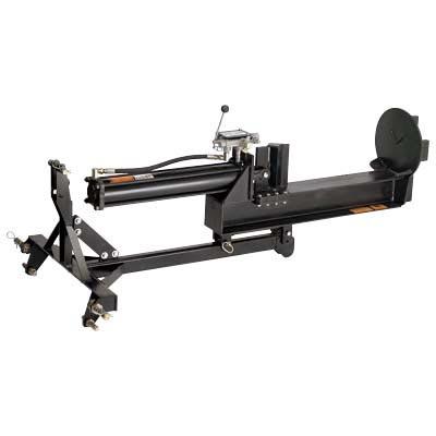

That splitter you had posted looks like a good one to adapt to the Pt. Where did you find it? Just put a receiver bar on it, slide it into the receiver you are making, pipe the hydraulics into the PTO and away you go. Should be a fairly simple job.

Some of those hitches are rated for about 500 lbs tongue weight. I think it could carry it just fine. Were you going to cut vertical and horizontal, and upside down. On a simple rig with the valve located up by the operator, one might be able to pull the unit from the receiver and rotate it to 45, 180, 270 degrees. My hydraulic cylinder is laying on the I-beam, which gives it a shorter profile. The square receiver is a good idea, but I would use a solid 2 in bar to weld to the log splitter
