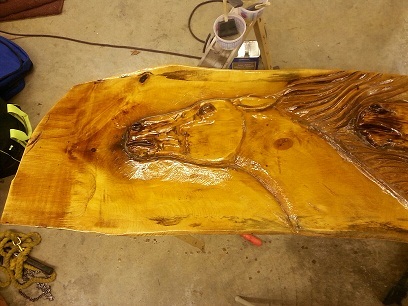

cedar would be a good choice. I would go the distance and add an epoxy. I am a fan of the West system (105 and 207) and use it quite a bit. They have an awesome metering kit for doing smaller batches. My latest project is getting epoxied to seal it plus a couple coats of Schooner Gold varnish to add uv protection.
WEST SYSTEM | The 105 System of Epoxy Resins and Hardeners
http://www.yachtpaint.com/usa/diy/products/varnishes/schooner-gold.aspx

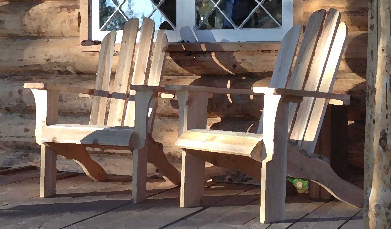

There are lots of different kinds of "Pine". Ponderosa pine won't last more than a few years, for example. Pine shelf boards from the store could be Ponderosa.
There are differences in Cedars too, some better than others for ground contact, but Cedar is generally good for outdoor chairs. If you don't want them to be too heavy, that's another huge benefit of Cedar. I have some cedar Adirondaks on my wood porch and they get moved around whenever we squeeze more chairs out there. They have a LOT of wood in them and could be very heavy if made of a heavy wood. If too heavy would beat up the porch too.
There are a lot of "chair plans" available but they are not ALL comfortable, you need to sit in them before committing to build. I found some Adirondaks, at a dept store that "fit" real nice (very comfy) bought one and copied the pattern (made 4 chairs).
I made changes here and there such as:
- used 1" thick Cedar
- widened the armrests
- "beveled" each slat
Beveling the slats increased the comfort a LOT. I convexed the horizontal slats & concaved the verticals with a tablesaw. Just slightly, just enough to make the corners go away. Mine are more comfy than the pattern chair from the store.
I made these to last, I bet they're still good when I can't get out of one anymore, and that may be awhile. ;) Mine need a little lateral bracing though, I might add that someday (maybe hide some braces underneath, made out of a hardwood).

ddbackhoe.
That is beautiful! Is it cedar after the West epoxy and varnish?

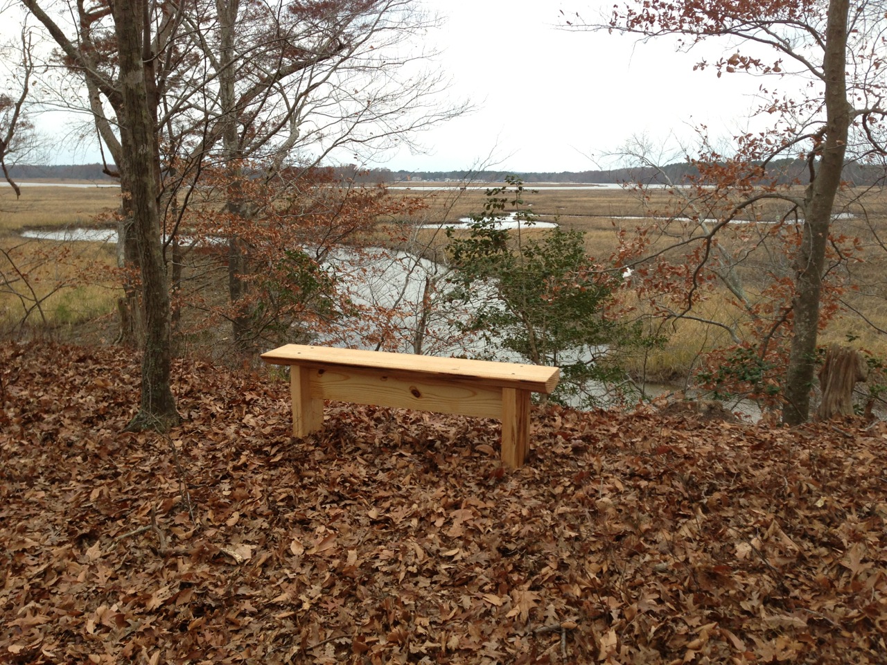

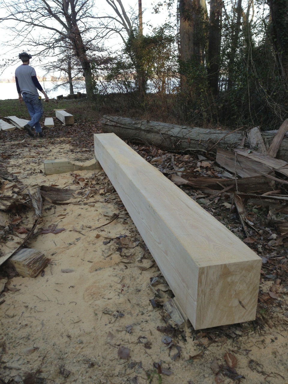

I use cypress for outdoor furniture. Have a bench that's been outside for 3+ years and is still looking great. Cypress trees grow like weeds around here, but I can't cut a live one since they are bald eagle habitat trees. But when one falls during a storm, the chainsaws come out. Best are ones that get "topped" in storms. Let them stand for 2-3 years and when I cut the tree down, the wood is already dry and seasoned. It mills, saws, and works like butter, with nice tight grain. Here's a freshly milled beam that was cut from a standing dead tree:
Here's a bench made from cants and scrap pieces of cypress that came off the beams:
Next on my list would be cedar. But don't overlook using synthetic lumber -- like that trex type decking. I see a lot of outdoor furniture made from that stuff now.

ddbackhoe.
Thanks. That will be the back for a bench I'm putting together. It's a 2" slab of white pine. Locally, it is really tough to find a cedar that isn't full of nails, staples or fencing.
