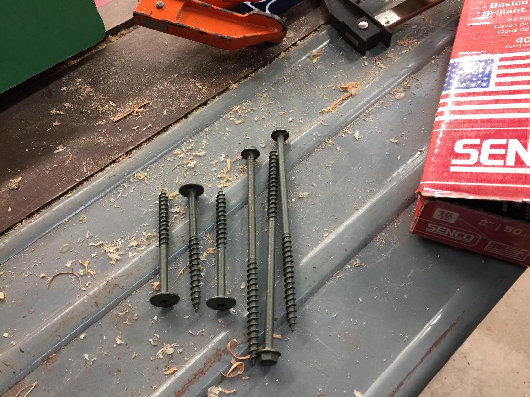

I use these Spax screws in lengths from 2-1/2" to 6". Pretty much same as Ledger Lock and GEK I think. As noted they are light-years better than old style lag bolts. They have either a torx or hex head, both with built in washer.
