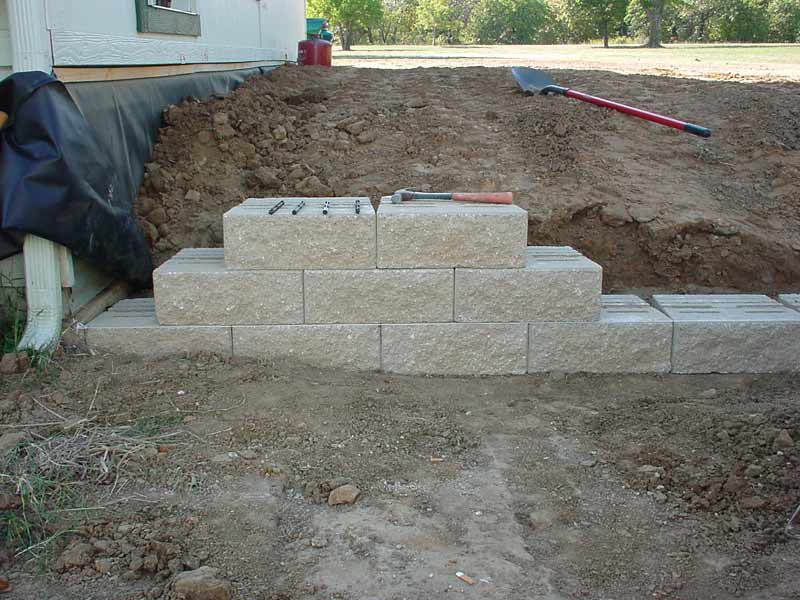

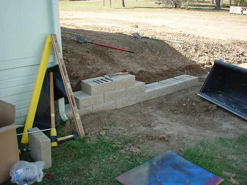

/ Wood Retaining Wall Help
#19
Well, I saved my pennies and went with Versa-Lok retaining wall system. The blocks lock together with pins making the entire wall one piece so to say. Here are a few pics of the start of the project. I will post more when the project is finished.
/ Wood Retaining Wall Help #20
Glad to see you went with the block. It's gonna really look nice when you get it done, and the best thing is that it will never rot out on you!!!!
Thanks for the update and don't forget to post more pics as you progress and especially the finished shots.
