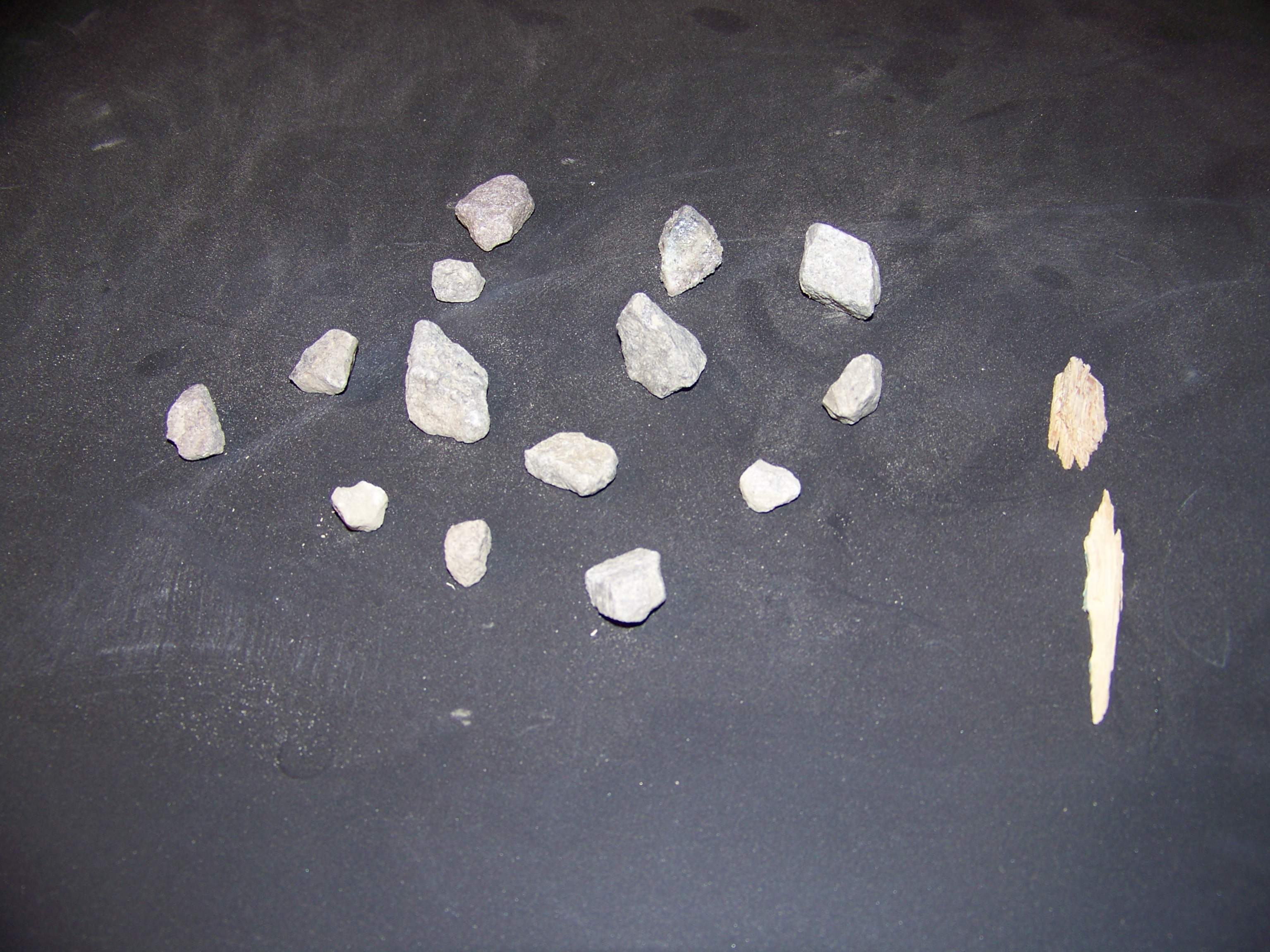

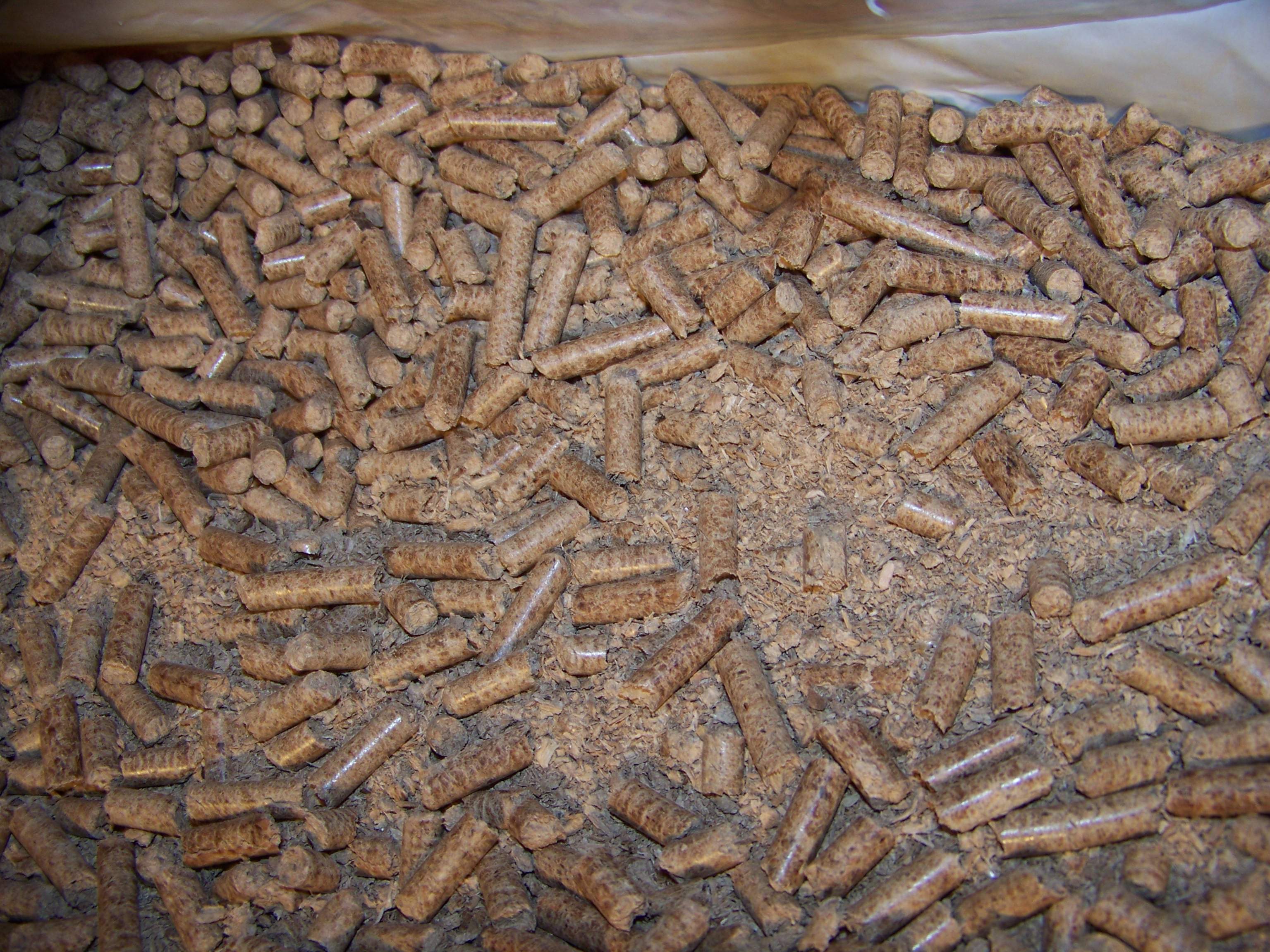

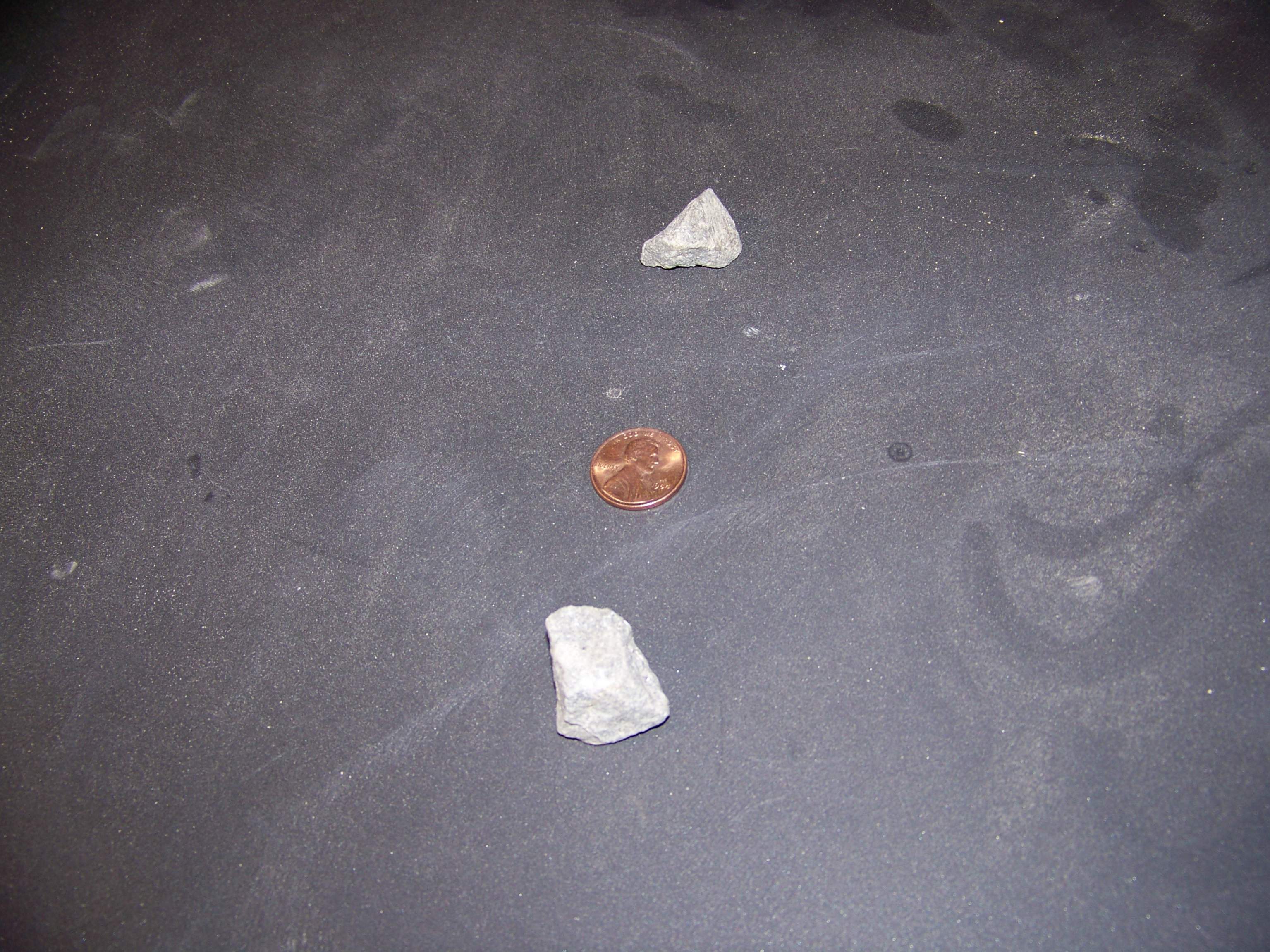

Kens..... last year was my first burning pellets. I bought three ton of Pennington's at the Depot. You wouldn't believe the crap i found in their bags..... shards of wood, ROCKS (!!!!!!!!!), etc. I posted this info with pictures over on the Hearth forum. I was NOT the only one with these problems. I tried repeatedly to get satisfaction from Pennington with no luck. Unfortunately, i had bought them during the summer to beat the winter price gouging, and since it was beyond 90 days when i found rocks in my pellets..... the Depot refused to take them back and give me a refund. They would only refer me back to Pennington.... who refused to stand behind their product.
I had decent luck with the pellets made over in Jaffrey (though they were more $$), and also had good luck with three different brands i bought through TSC (if i recall the names, i'll post them).
Best i can figure...... Pennington uses the same bagging equipment for landscape stone as they do for their wood pellets. I've done my best to warn everyone i could as to the (lack of) quality of Pennington's pellets. Here are a few pictures. Imagine these running through the auger in your $2000 pellet stove. Also.... the amount of 'fine' (loose sawdust) in the bags was unbelievable !

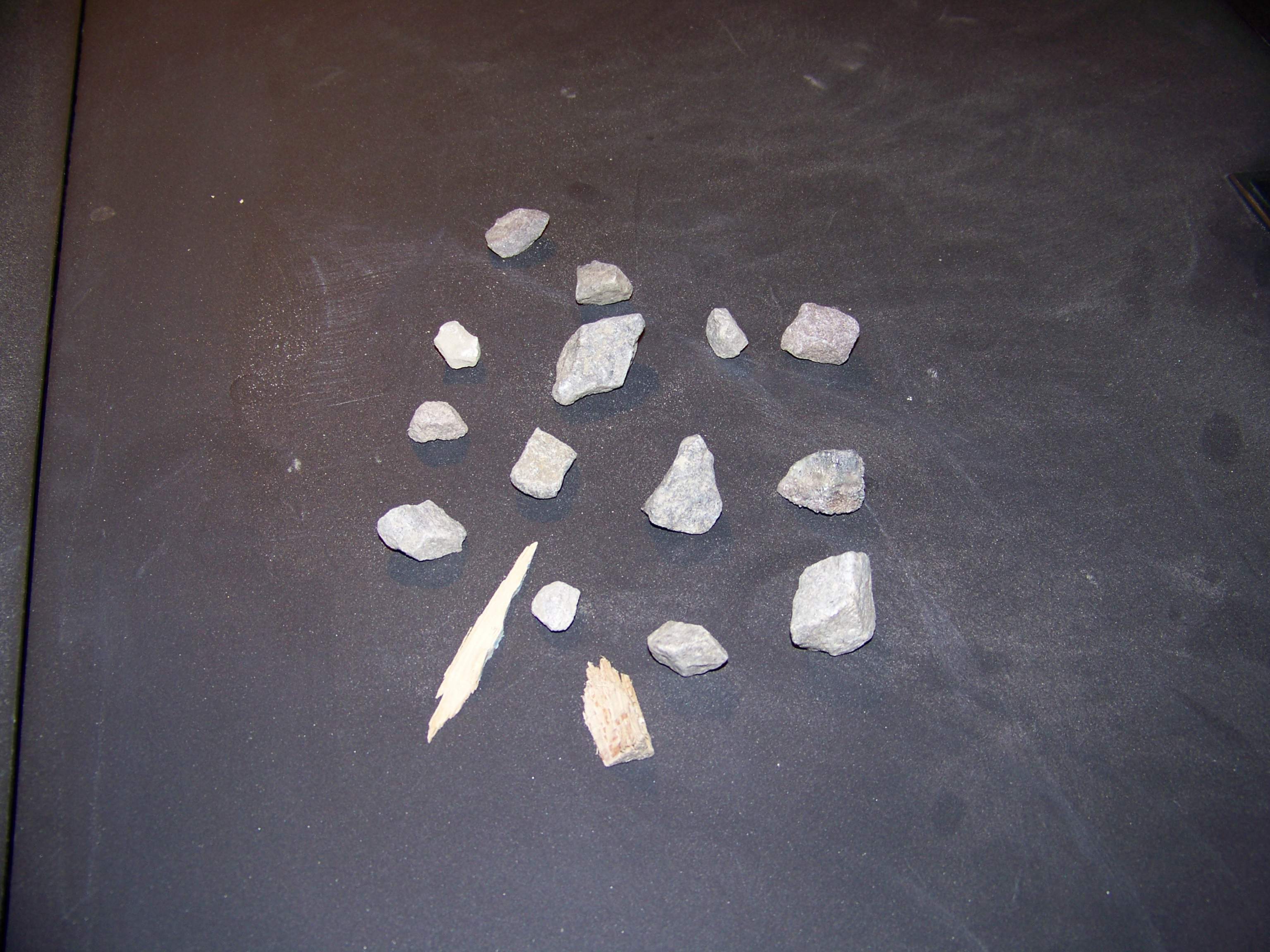

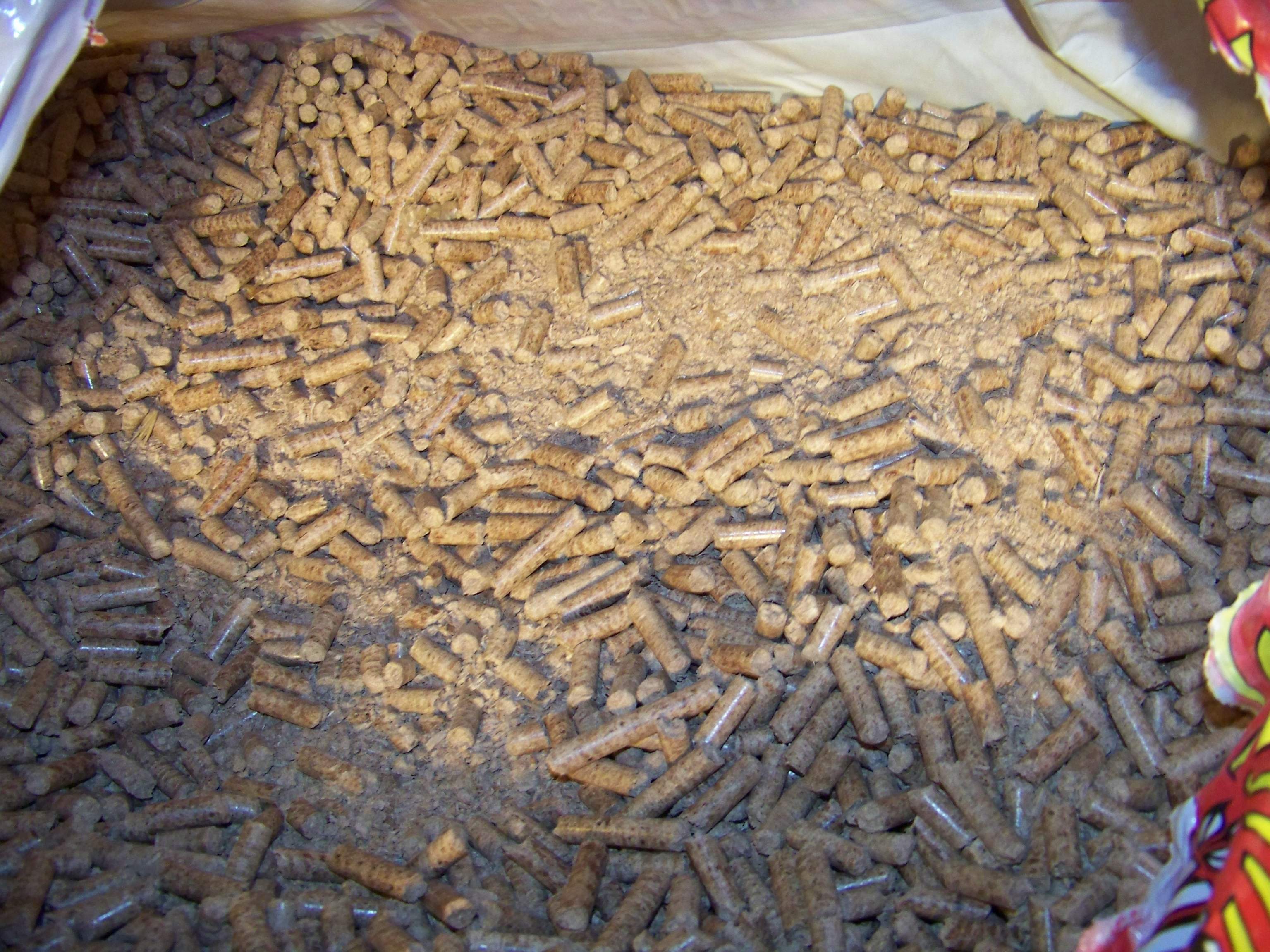

/ Wood pellets what do you use? #19
More.......
