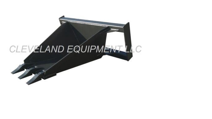

It doesn't hold much, but I've used my stump bucket to 'pour' (rocks) into a small opening.

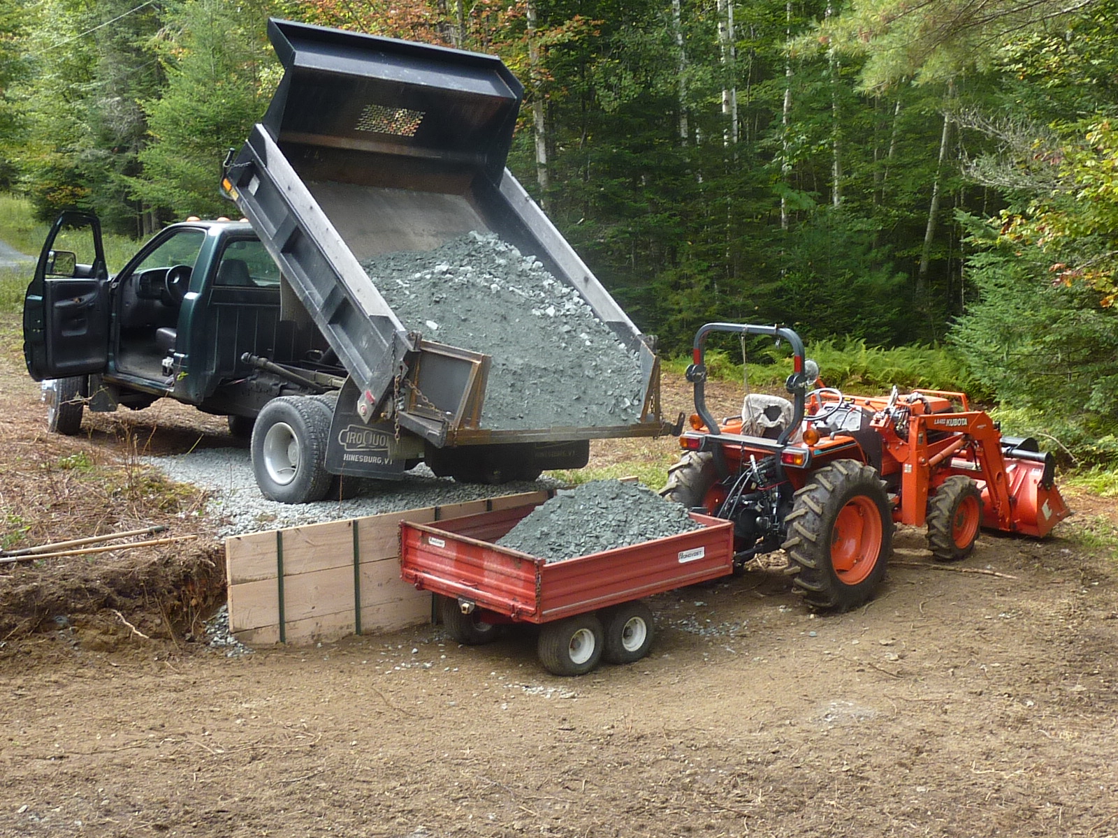

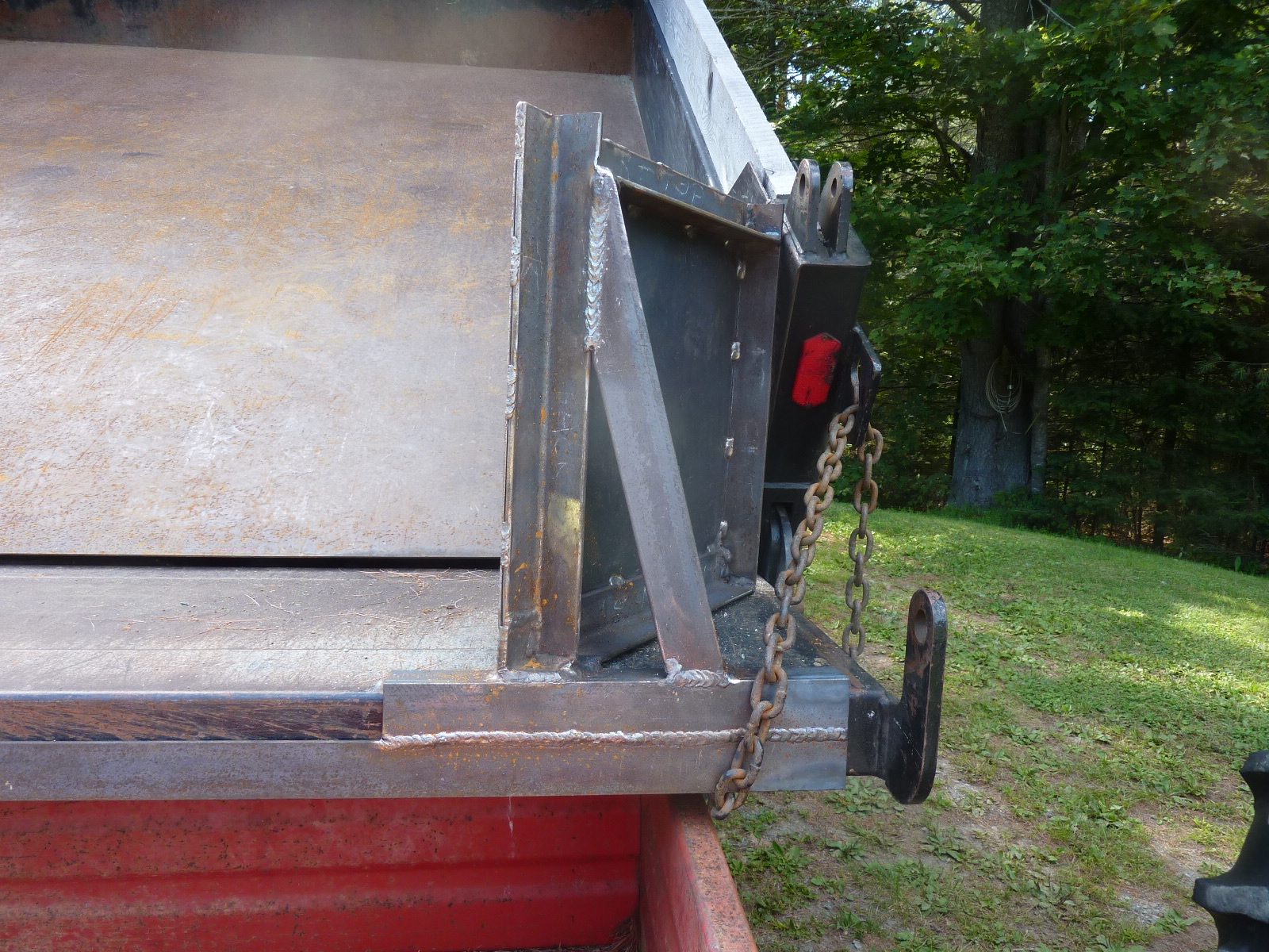

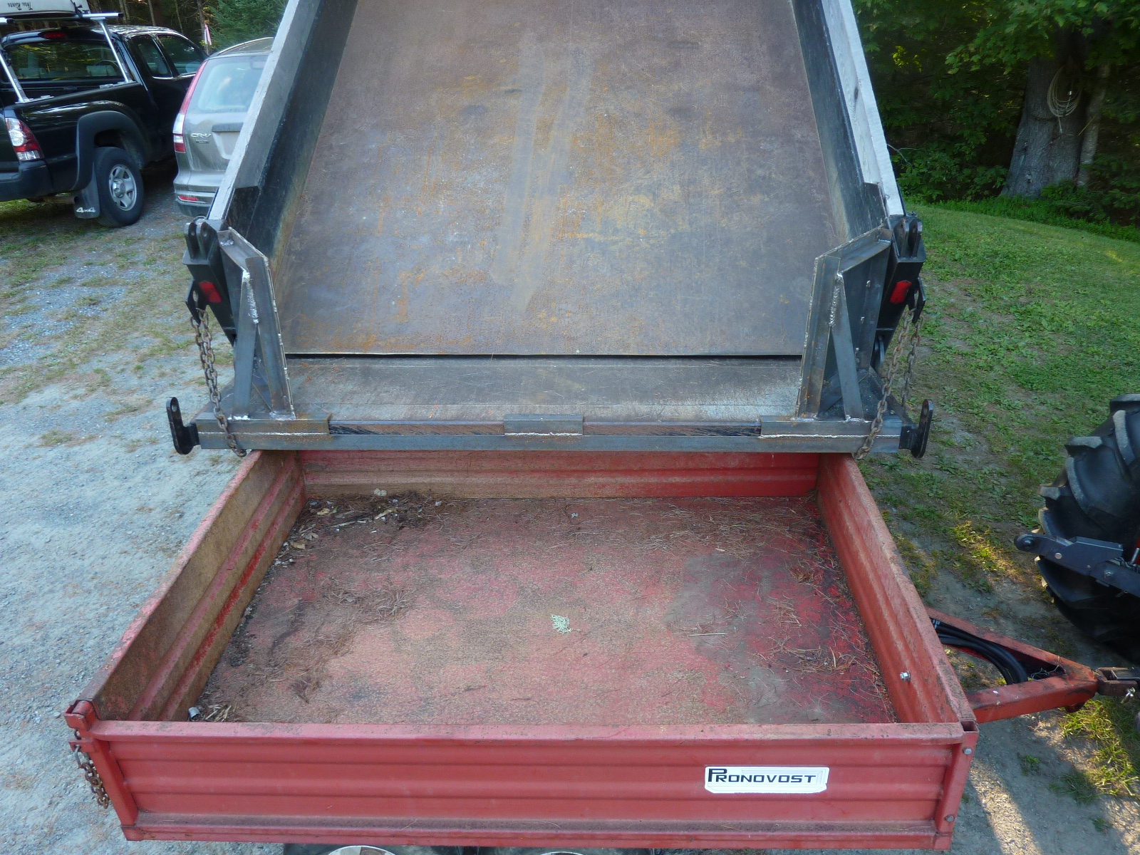

I made a chute for my one ton so I could transfer gravel into my dump trailer. It might give you some ideas ?? It is held on by the trail gate chains.
