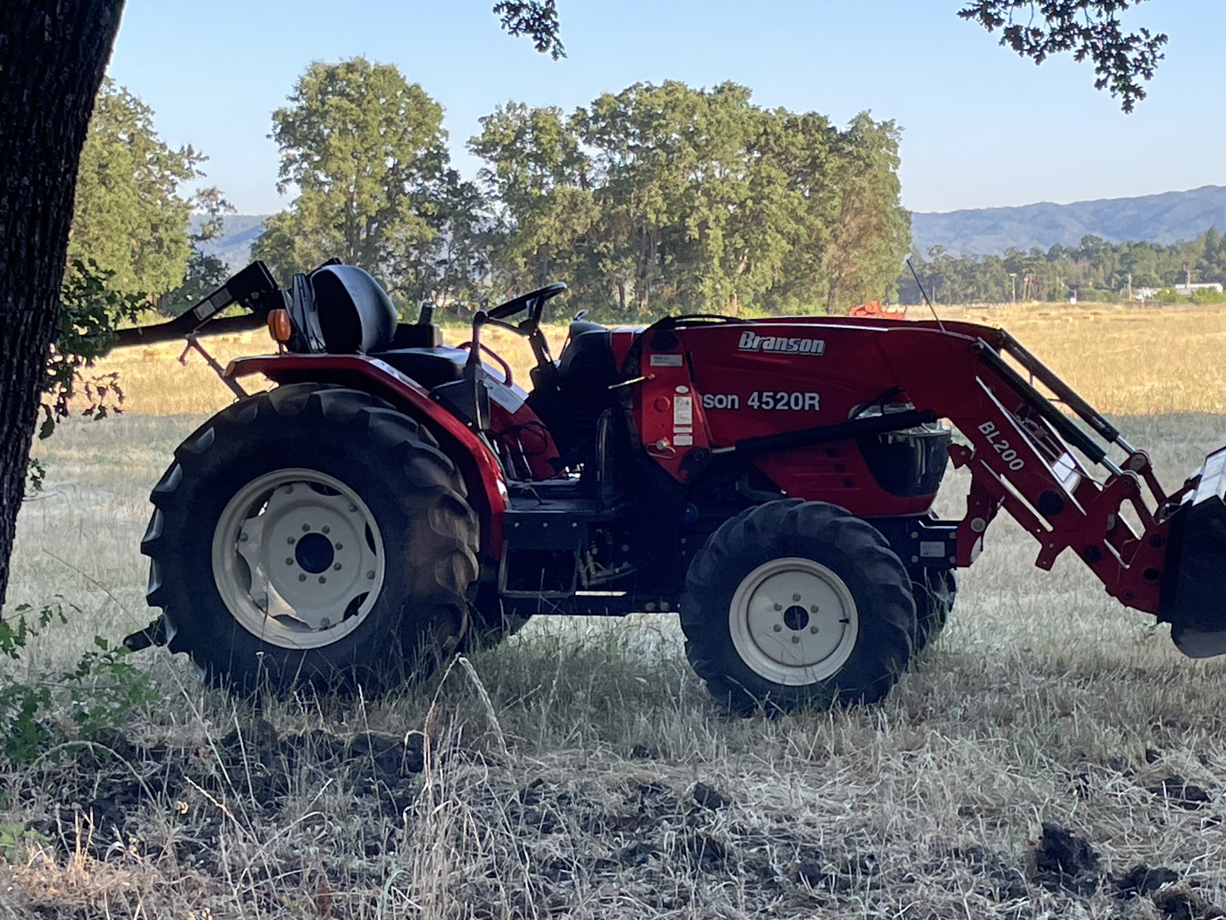

Branson4520R
Branson 4520 r won’t turnover the battery is fully charged
/ Won’t turnover #2
Is the starter engaging? Is the engine turning but not firing up?
/ Won’t turnover #3
Need to ohm out battery cables and check for corrosion at connection points. Also, battery voltage is useless test. You need a load test at 50% of cold cranking amps.
Also, could be safety switch issue. Need to check all those switches.
/ Won’t turnover #4
What have you done to find out what is wrong that it will not start?
willy
/ Won’t turnover #5
Ensure that your parking brake is engaged and that your gear selector is in the correct 'starting' position. Consult your Owner Manual, perhaps you missed something.
My 4105 (hydrostatic) will not turnover if the selector is not exactly in Neutral.
