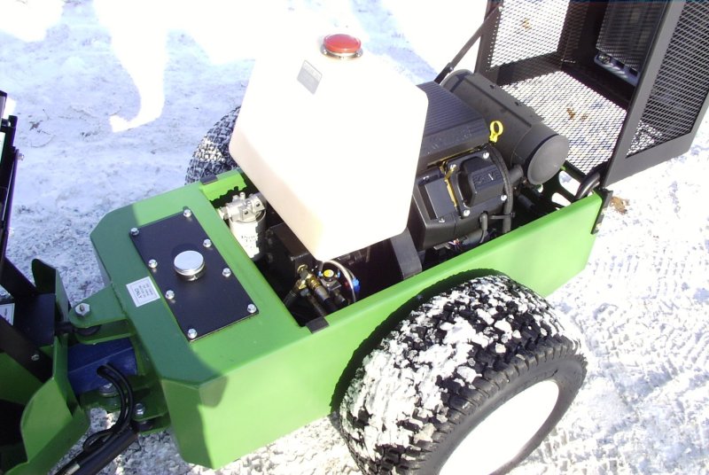

#32
Here's an overhead look at the area. The hydraulic tank is in front of the engine compartment.

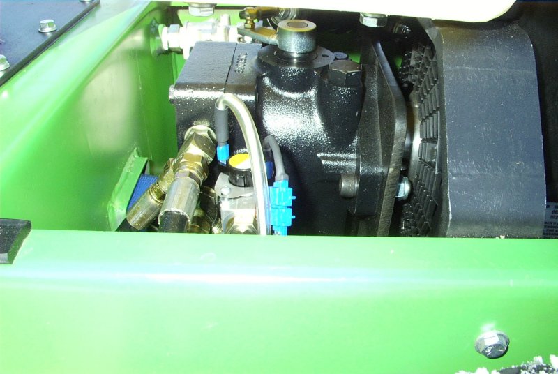

And here's a look at the back wall of that tank, looking at the tram pump as well. That's the area of the tank that's most protected for a glue-on pad heater, I'd think.
