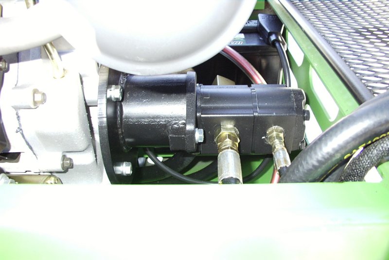

Looking at my engine-mount-pto pumps picture below:
I think the pump mount is mounted to the engine on the 7.75" bolt circle.
Then there's some coupling inside there (lovejoy or shaft? I do not know).
Then there's an SAE (number unknown) two-bolt mount that the pump mounts to.
I've not found any clutches that'll mount to the 5.625" or 7.75" bolt circles on this engine (if that is in fact the correct bolt circles, just using what I found so may not be correct, so don't go doing any research based on those numbers yet).
I have found clutches that will mount on SAE 2-bolt mounts.
That would add about 5-6 inches to the length of that installation, and won't fit.
However, if I could find a clutch that bolted directly to the engine an had an SAE 2-bolt mount on the other end, well, it appears that would be about the same length as the pump mount that's in there now.
Hmmmmm..... I wish I could find more specs on that Kohler mechanical pump assembly listed in the maintenance manual for reference.
