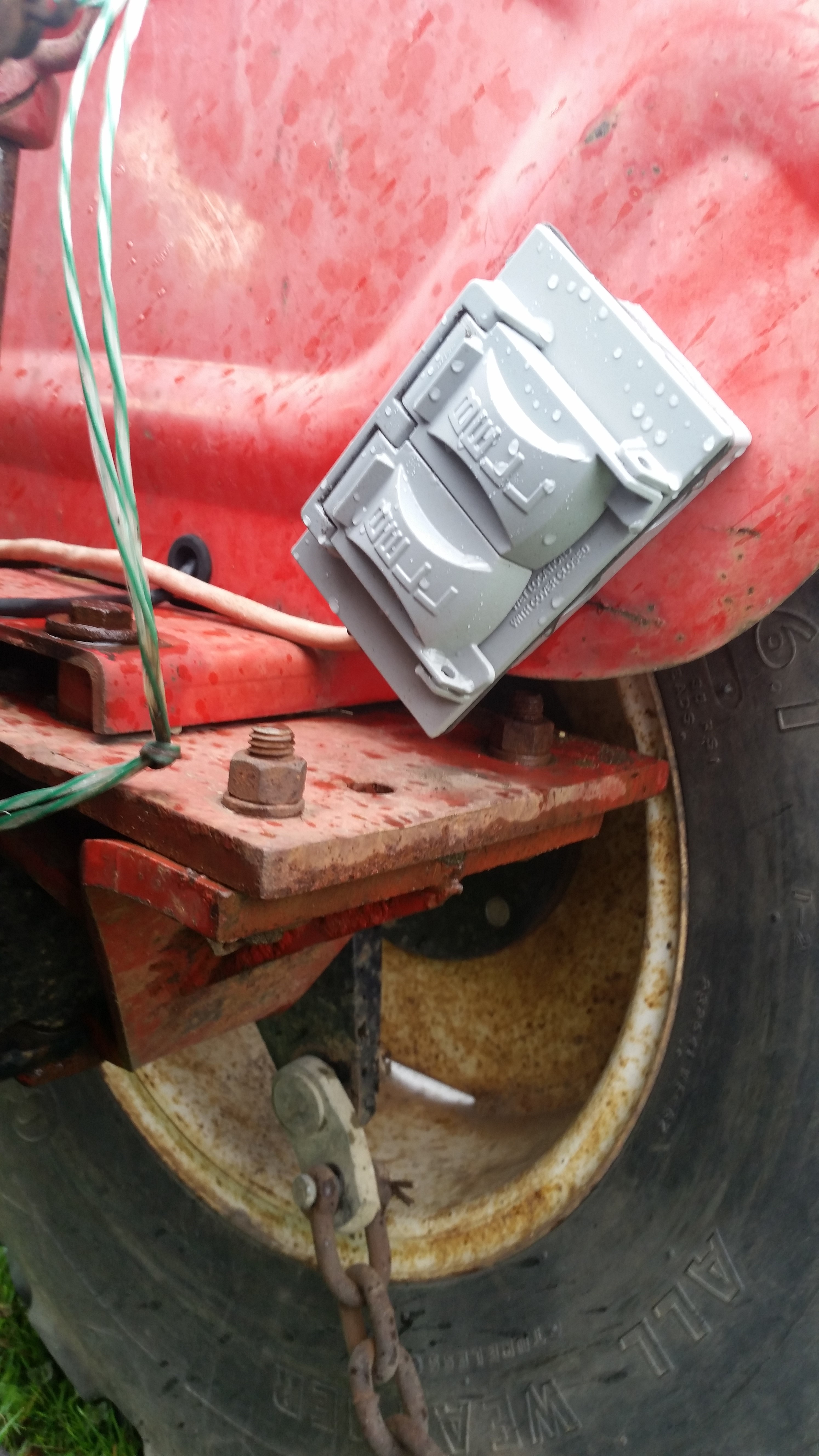

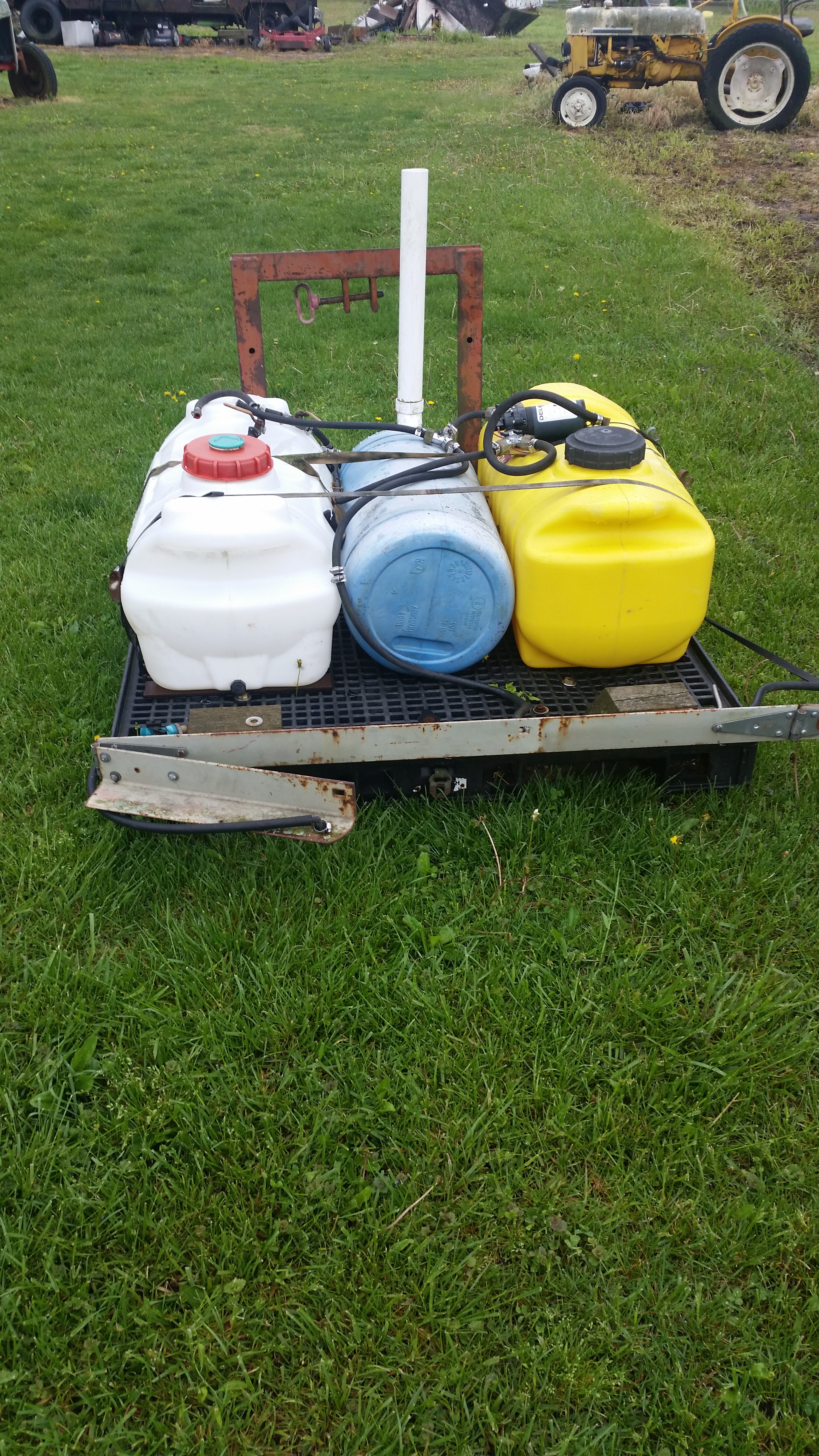

Know this is an OLD thread but, this is how I hooked up MY 12v sprayer.
As for the Fuse, why not put one on both ends. I understand about those wires actually BURNING, a long wire and there goes your tractor.
I don't spend $8. for a 12v switch, I use 110 volt house switch and outlets and my wiring is a Drop Cord, Heavy Wire.
Smokin'
sprayer system.jpgsprayer rig on a pallet attached to a CarryAll boom added
Sprayer shut off.jpg110 volt outdoor light switch
sprayer plug in.jpg110 volt outdoor Plugin Outlet
