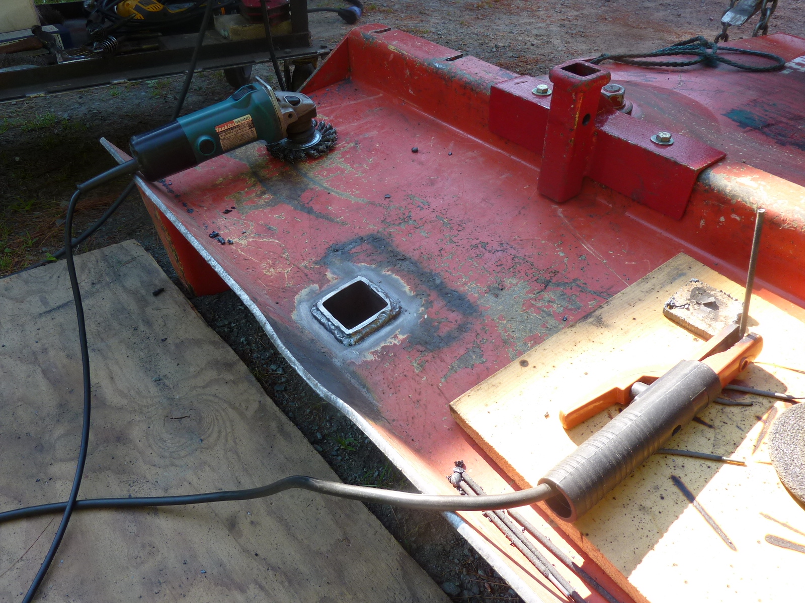

I like to use a coarse wire brush on my 4 1/2" grinder to remove slag. I have used Forney and DeWalt brushes which are easy to come by locally. They both seem to throw a lot of wires, at least to me. It never bothered me much until I got flat tires on both the one ton and another on a self powered bush hog. They were both from wires. Now I run around the garage with a magnet after doing some welding. Kind of a pain. Are there any brands that are better at holding the wires or is it just the nature of the beast ? Thanks

Thanks all. I use the knotted heavy wire ones too. Maybe I use to much pressure trying to get into every crevice - which can be many on my beads, or removing scale because I am to lazy to change to the grinding wheel. Been thinking about a second grinder for a long time. I should just go ahead and get it. This is the type in this pic

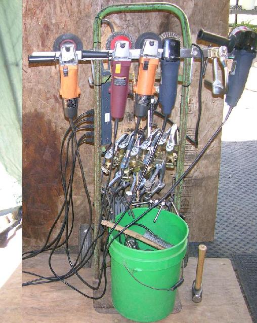

Til my "ship comes in" (and strangely enough, it hasn't completely SUNK yet :rolleyes:) I tend to do welding in a few different places depending on the project - so this
tends to make things a bit easier - old hard rubber tired hand truck, piece of 1/8" FB clamped across for hanging - added a power strip 'cause I got tired of plugging/unplugging 5 (sometimes 7) grinders every time I moved it :mad:
Added advantage of the cart - a few less things cluttering up the weld table :laughing:...Steve
