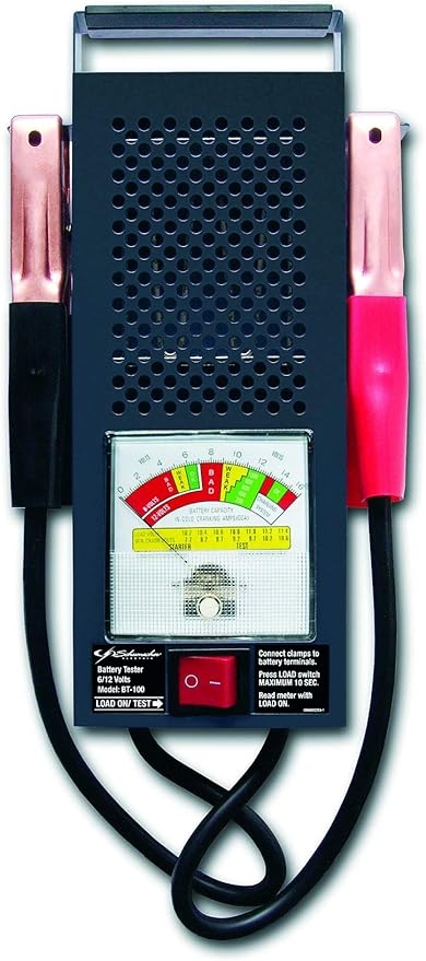

So here is what i did so far:
1. i bought this battery tester. Currently i have 3 batteries around my house for use with the iseki's. The youngest is less than 1 year old. I have 330 cca (2x), and one 380 cca. The battery tester shows that, even on the 380cca, after a full recharge, it gives max 200 cca load. Cannot believe that these batteries are degrading so fast. Another test i did was to leave a fully charged battery outside for a night, temperature close to freezing. In the morning it gave me a max of 100cca. So it's hardly surprising that a cold start in the winter morning is almost impossible.
2. I bought a battery booster. Nothing big or fancy, but it already showed it's purpose. One morning, again close to freezing, again the iseki would not start. Not enough cranking. So connected the booster, and there is was :). That's a quick return on investment.
