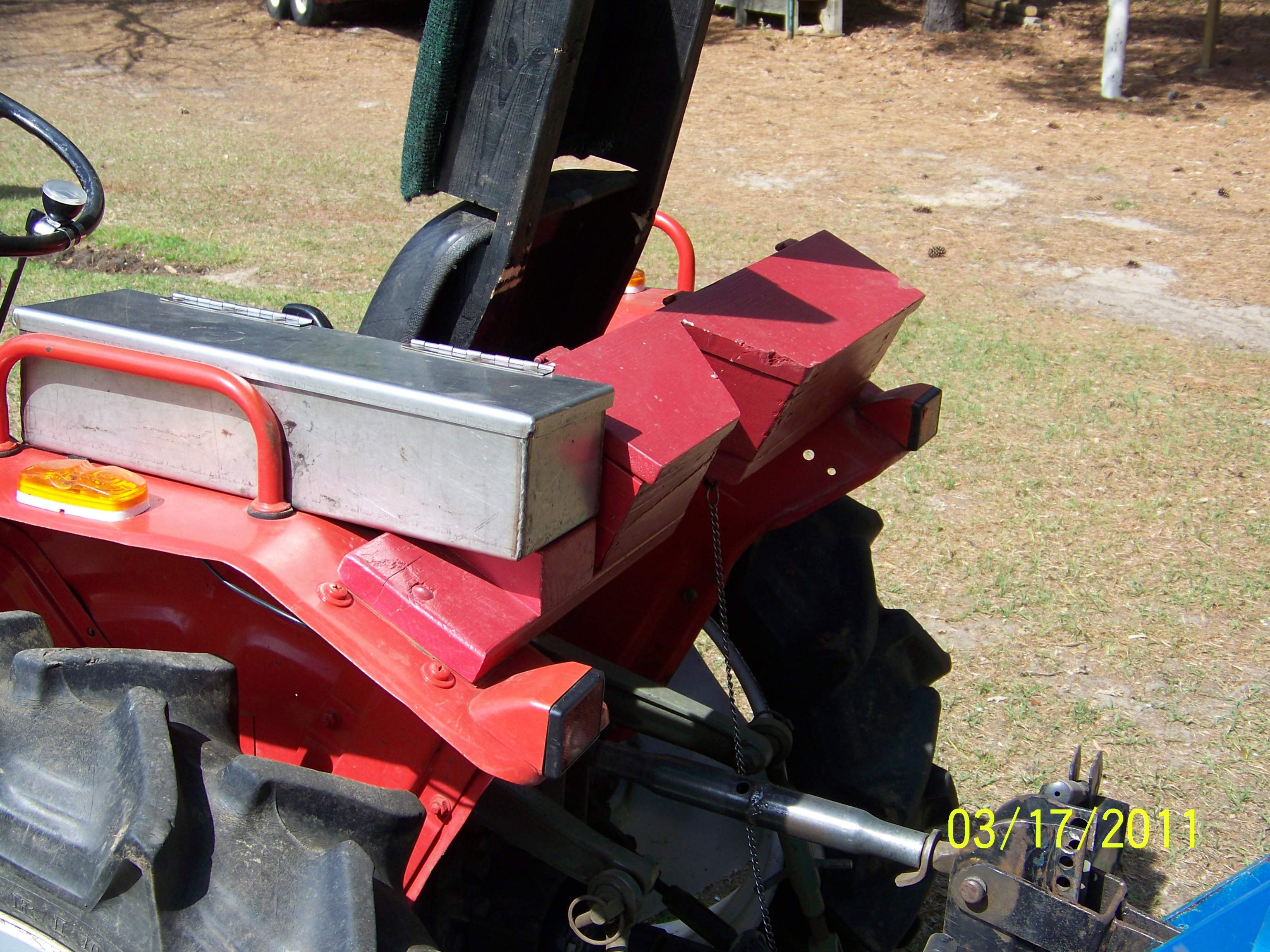

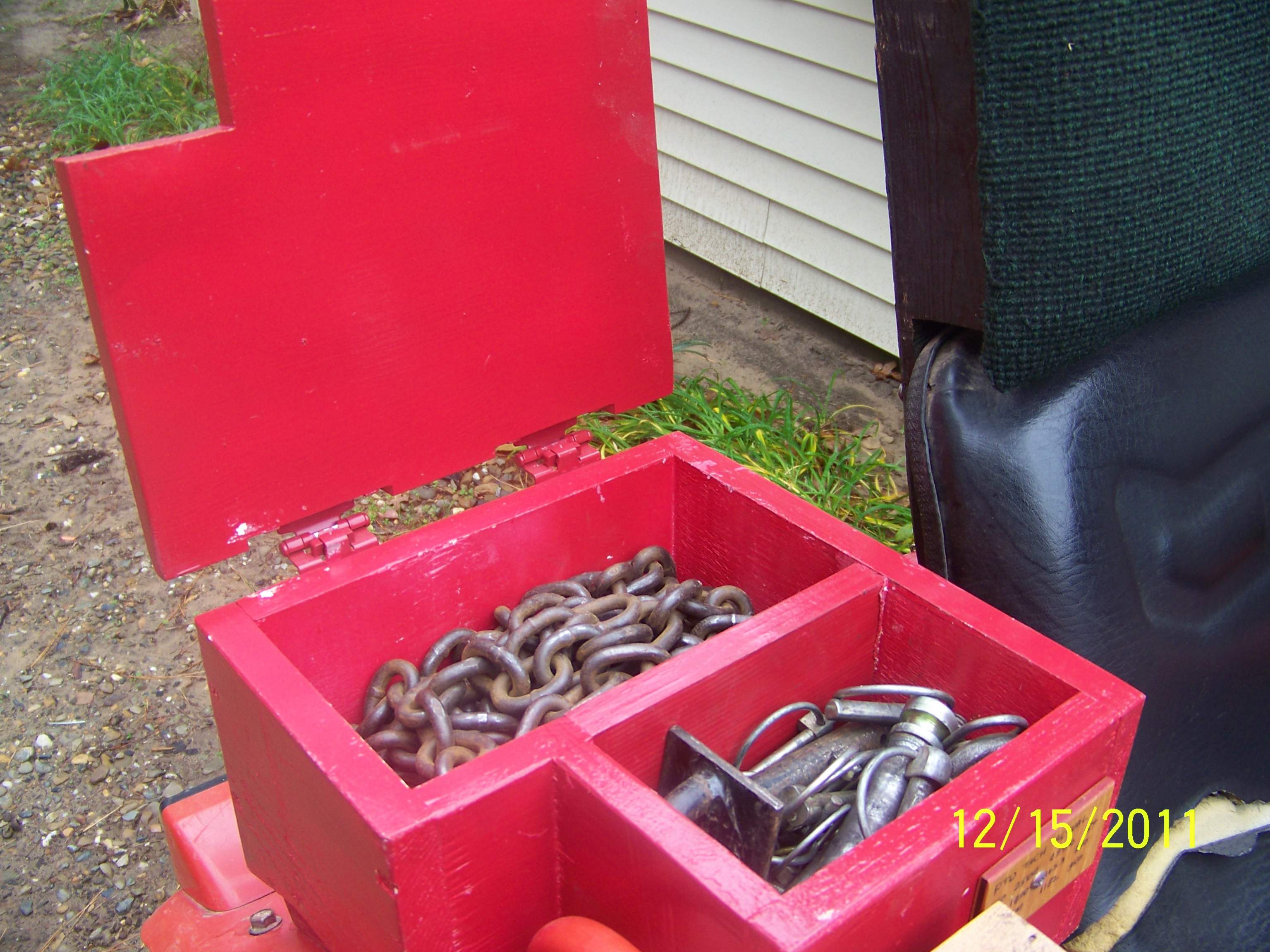

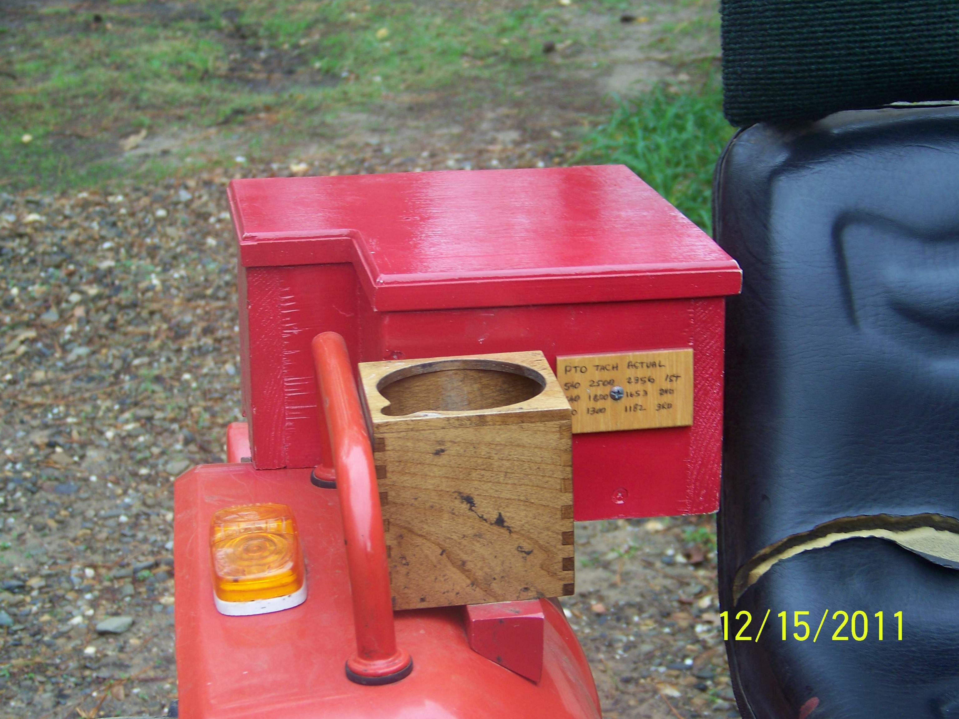

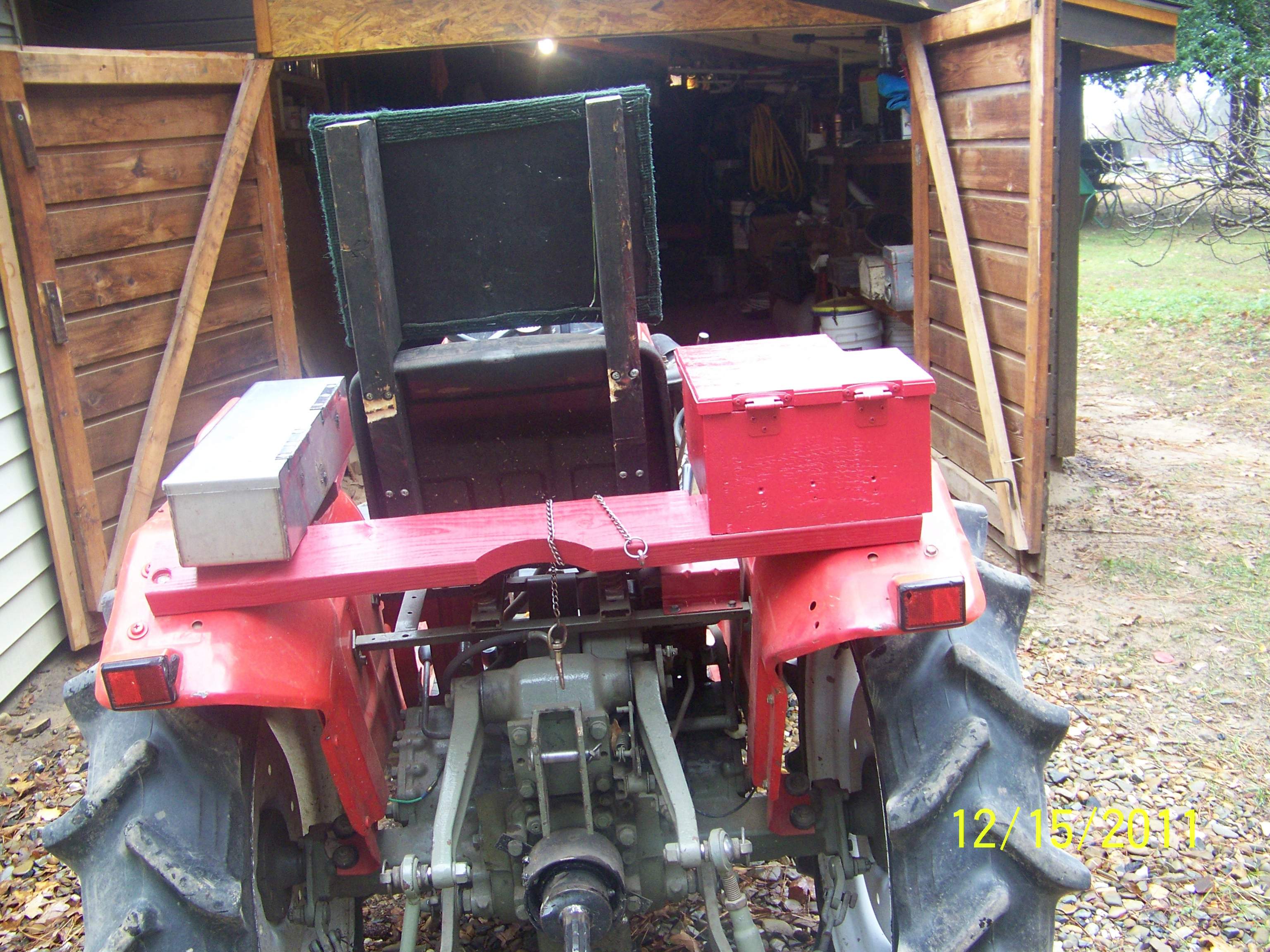

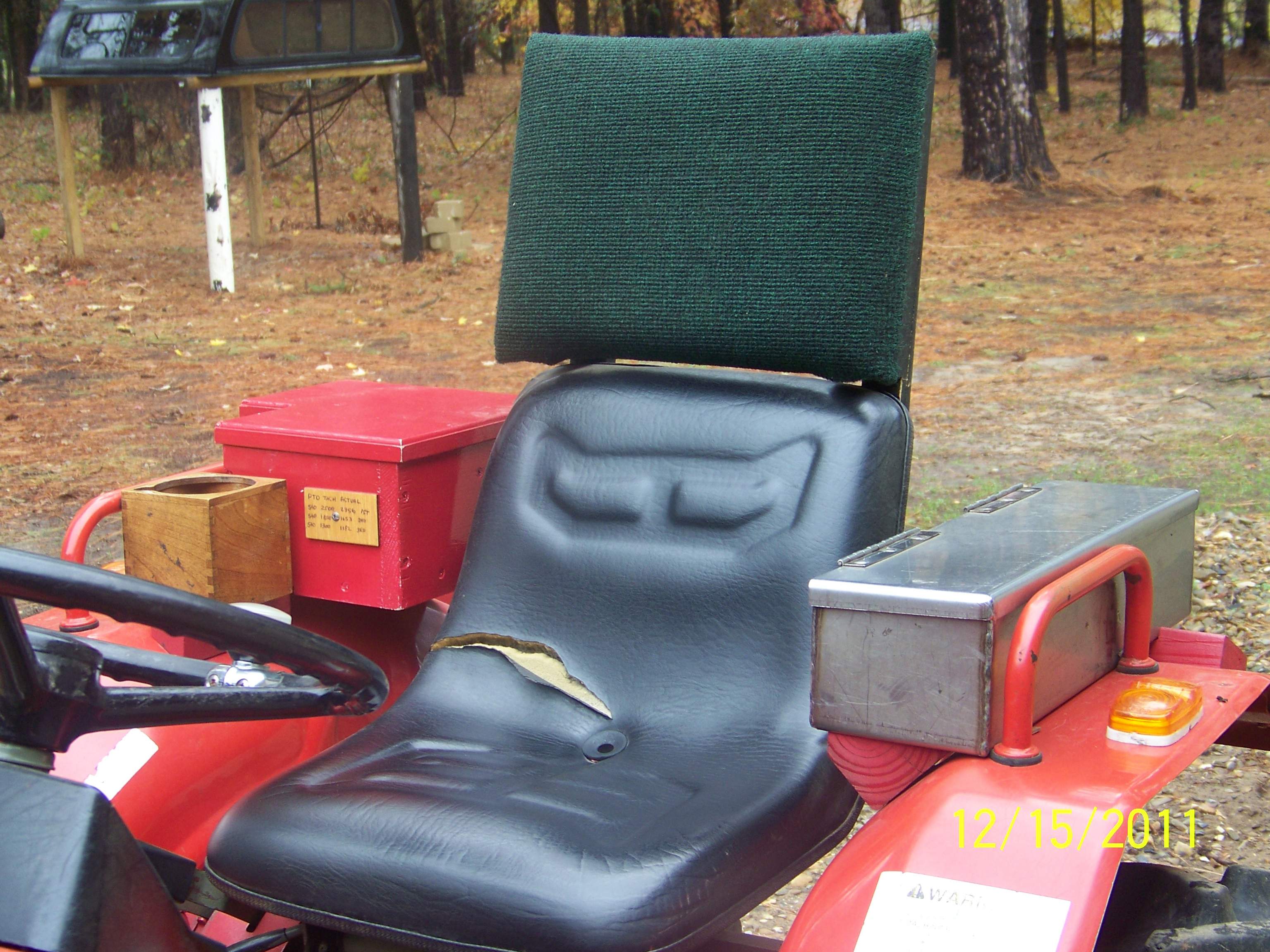

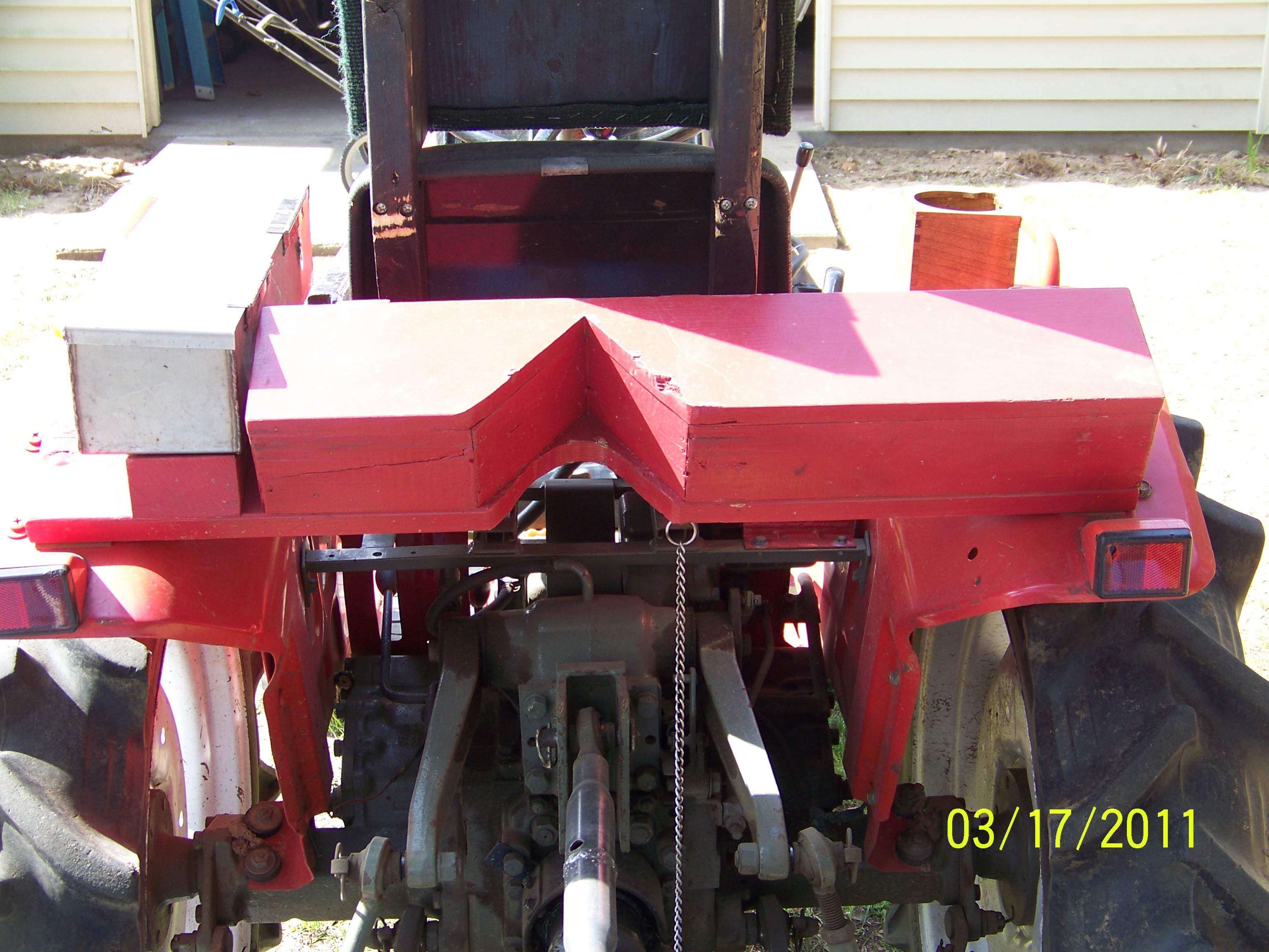

Not sure this could classify as a winter project but here is what I have been up too. First two pictures of my old toolbox arrangement which got hit too many times when my quick hitch goes to extreme height - last four of my new arrangement. Might wonder about the tach numbers in last picture. My old tach is not real accurate so those are corrected numbers using a Harbor Freight hand held tach. I use different pto gears in some situations and like to know how fast things are spinning. Things look a little crowded around the seat but I actually fit in there pretty good. One more thing, the 2x4 going across the fenders helps dampen the fender vibration I experience at certain rpms. Enough! :D
