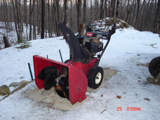

Groo-- my Toro 8-hp 24" blower, not exactly a lightweight, frequently couldn't handle a full 24" of snow unless it was pretty dry... Often had to reduce swath to 10" or even 8" in order to keep impeller speed up, even in low gear. (That's why I got a tractor with a BIG blower!)
I think wings, unless the snow was fluffy, would only slow you down. I think you'd also find, unless your wings were highly polished & impermeable, that you'd get a lot of buildup on them and simply push the snow, as Toad Hill mentioned.
On the other hand, the blower did work for me on a 200' driveway for a number of years--- but it took several hours for each snowfall.

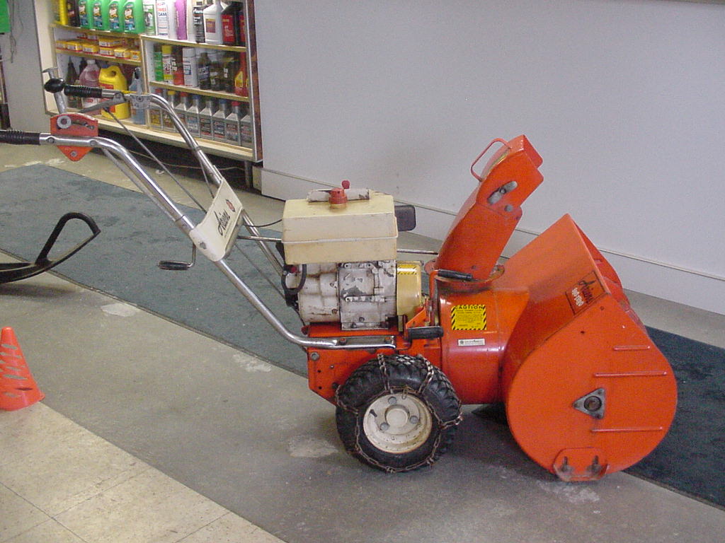

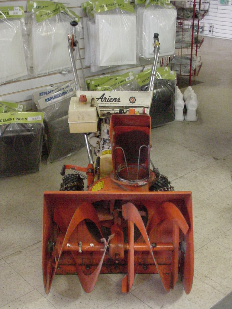

Interesting that your Toro is (was?) so weak, at the hotel where I work we have a old Ariens 724 (like the one below, but with more rust and without the thing in the chute) that we picked up for $200 with a 30" mower deck (works great, almost a bush hog) it will take a 24" cut of 8-10" snowdrift in second gear as long as the snow is not wet and slushy, it handles the wet snow better now that I adjusted the throttle linkage to up the RPMs, but it still clogs on occasion when I stop and try to start again.

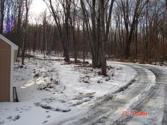

Aczlan-- I also wondered about that-- in all fairness, I know that some of the power was "robbed" by going up a rather steep slope in one direction, and the poor impeller often gets nicked by rocks early in the season (I live on a dirt road with a gravel driveway), even with the shoes lowered.... I ended up replacing the impeller altogether a few years back, after heating & pounding impeller blades back into shape a couple of times. Too bad Toro didn't have bolt-on (replaceable) impeller blade tips...hmmm..:rolleyes:
The first pass was always a full 24", of course, and it would handle it, but I always had to go very slowly--first "creep" gear. Later passes were 2nd or perhaps 3rd gear @ 8" to 20" width, depending on snow depth & weight; however, it seems like the past few years we've had a LOT of snow/rain/snow storms so the snow was really heavy. :mad:
Anyway, though I still use the Toro for edge work, that's all in the past-- the GC2310 with the AGCO blower on its front end is a quantum leap in capacity and has cut total blowing time by at least 2/3! :D

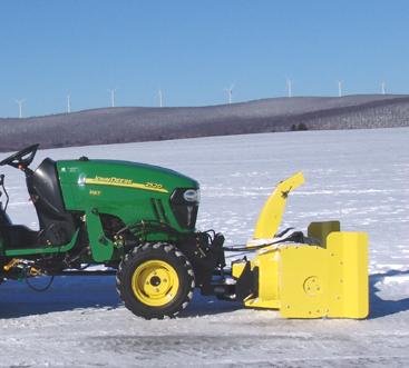

I think the fella that did this one was on this site. Sorry I don't know his name to give the credit. Anyway, I thought he did a dandy job fabbing up wings for this JD 47 blower:

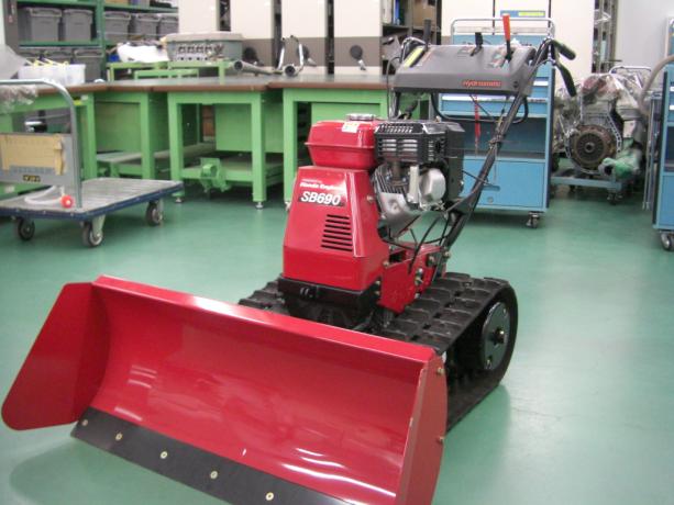

getting to be that time of year again so ill post some pics of wing ideas for hondas (mostly so i wont lose them again:D)
if you look at the picture of the power shovel, you can see the extensions. Cant find that pic for the blower with wings again :(
Pic 3 : who says the japanese dont have a sense of humour? lol
