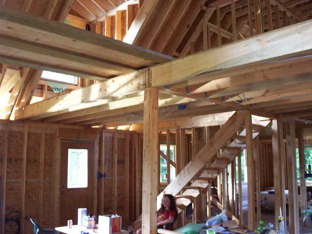

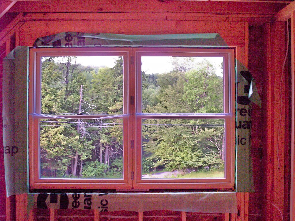

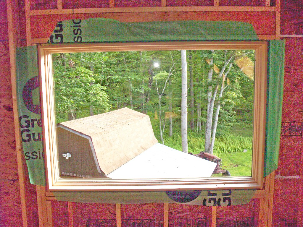

Okay, here's some pics. Note the extra lumber around some of the windows. The builder forgot how to use a tape measure. The window sizes matched the window schedule, he made the openings the wrong size. Questions and comments welcome. There's also a sideways pic of the porch post footer. And a pic of the cathedral ceiling from the dining/living room area. I had wanted a log home style post and vertical beam, he put in 2x10's. That's another thing I have to fix. Also note the neighborly pic below. On the pic of the back of the house, there is nothing wrong with the roof. I had to shade the sun to take the pic and it distorted the image.

Those windows actually don't look bad to me from what I see - just not done yet. Only thing I don't like is how he tucked the housewrap under the nailing flange on top, that's bad flashing. Can't tell if there is some sort of of flashing under the areas that are already wrapped - that's pretty important. Looks like the nailing flange is on the face of the flashing though.
You can take a razor knife and cleanly cut the housewrap back (so that you can put it back) from the windows to check. But I'm pretty sure there's no flashing there.
Which is unacceptable. But easy to fix. You can do it yourself pretty quickly if you want to.
Remember, there should be flashing at all openings under the housewrap (vycor or such) and incorporated into the siding. All going like shingles to direct water to the outside of the house. Let me know if that isn't clear and I'll try to come up with pics.

A couple more.

He's not a big believer in shimming windows is he? Which is fine, but you do have to do the foam for sure, you don't want the fins being all that hold them on.
I'd slap a level on the windows for plumb though.
