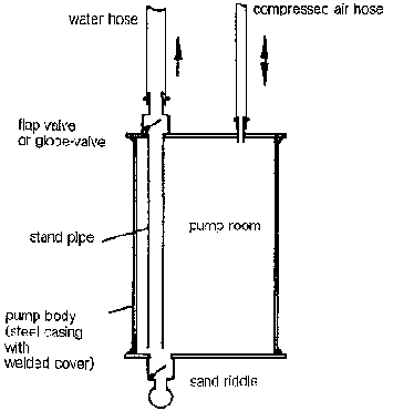

I do not know how deep your well is but if one has some depth below the water table, one can use a air lift pump, and pump air into the stand pipe and as the air rises it will bring water up as well, need a small stand pipe,
the geyser pump needs less depth of water,
look up Geyser Pump or air lift pump Airlift pump - Wikipedia, the free encyclopedia
a commercial made unit Submersible Pumps, Bore Pumps, Well Pumps, De-watering, Aerating, Leachate. DIY
and the picture is of a positive displacement pump, the problem is it needs some type of valve alternate the air and even dump the air, out of the cylinder, but one could possibly use two blow guns that would operate off the turning shaft with reduction that would run a set of cams that would work the blow gun vales, to blow air in to displace water, and one working opposite to dump the air so water can refill the cylinder with water to be pushed out again by air,
