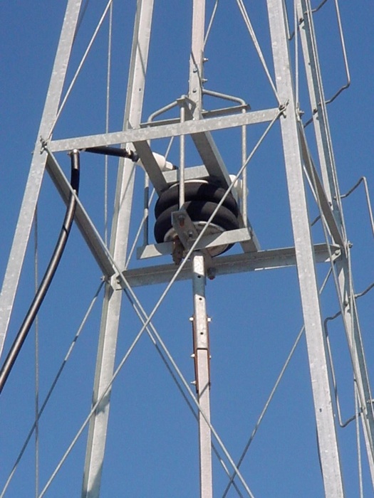

/ /windmill water pump #28
Look familiar ?
