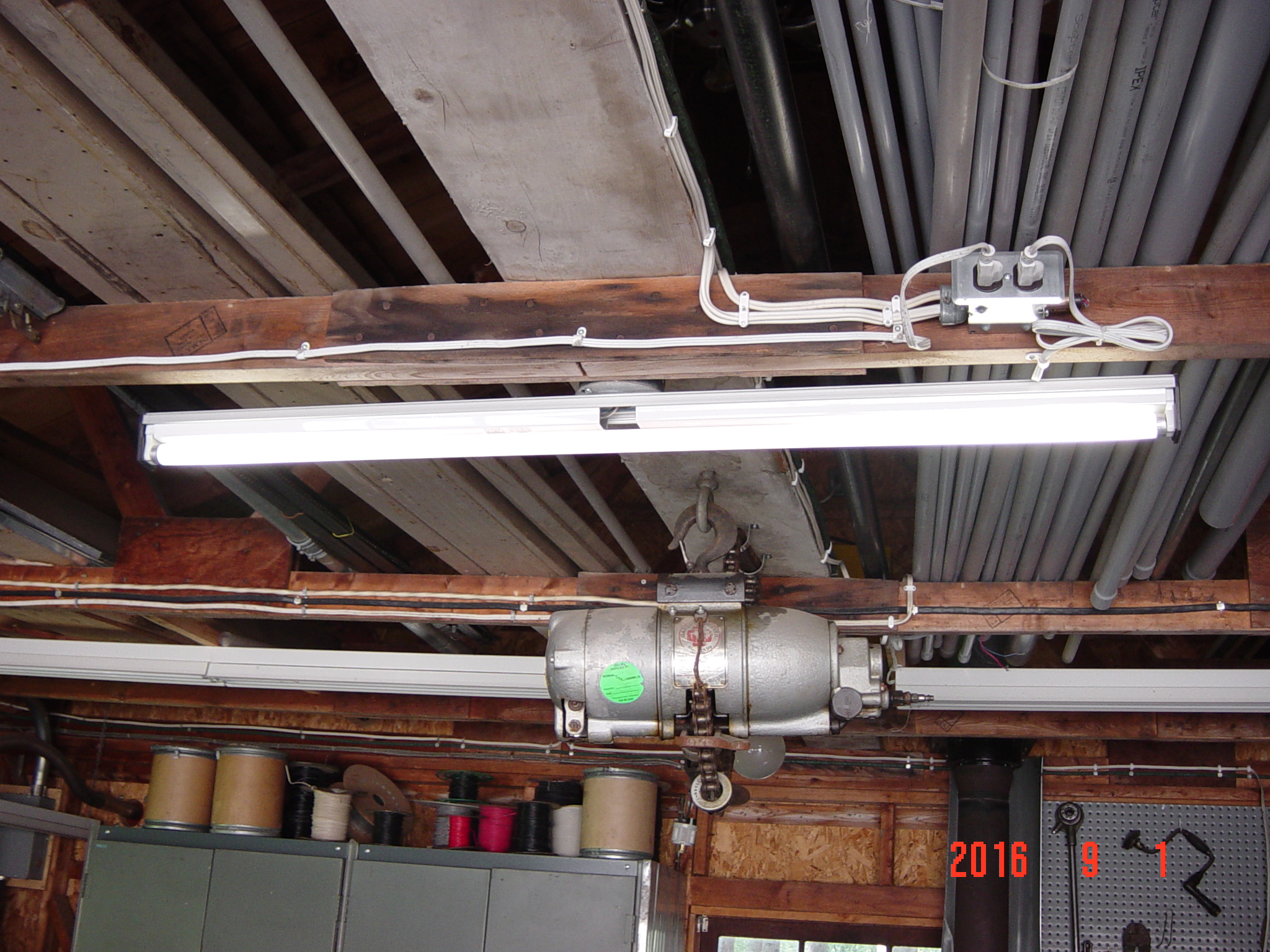

I always thought some motion detection would be good on these EL lights.
This is the light. It used to be a 12 inch RV style but I recently switched it out. Obviously today LED would be better.

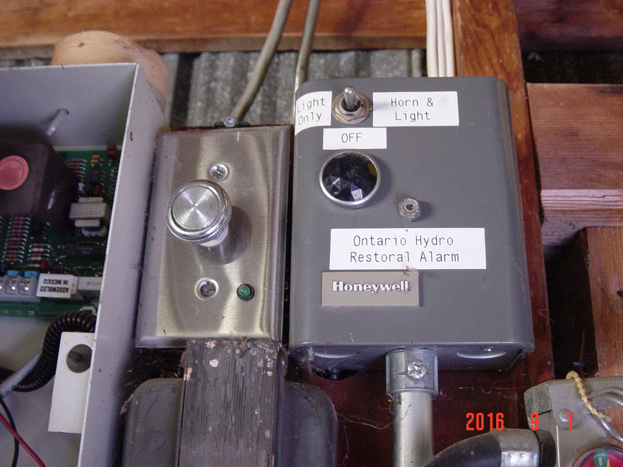

And the clockwork switch with LED locator.
