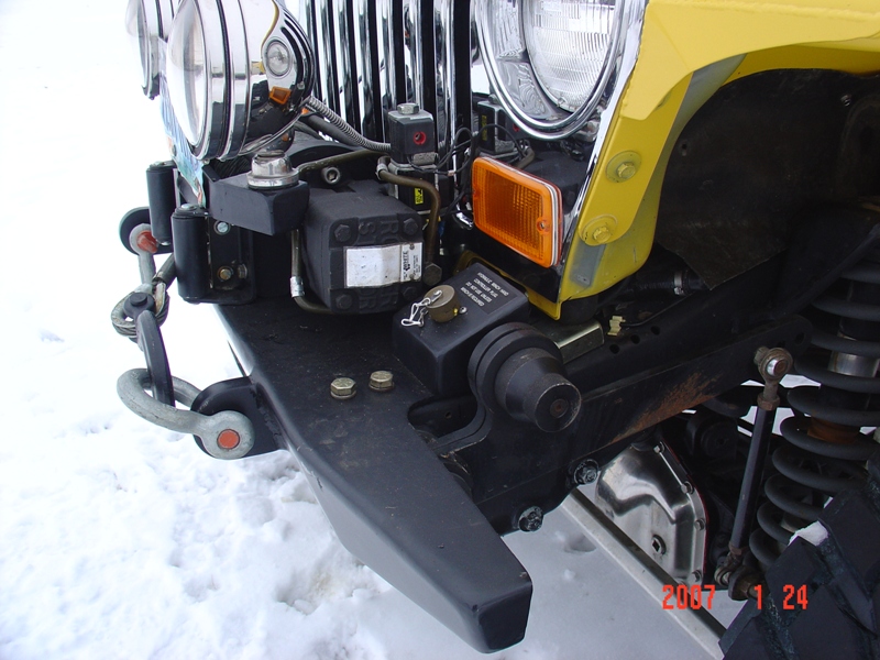

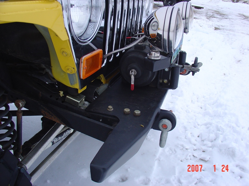

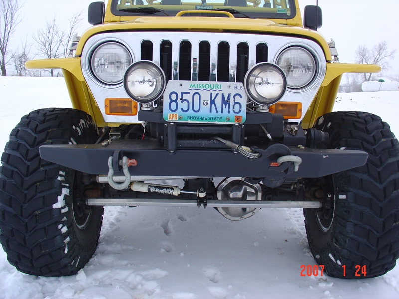

Nice and sunny today! Here are some pics of my setup. You can't really tell from the pics, and I take no credit for the plumbing as I simply followed Milemarker's instructions, but the flow goes like this: Pump high pressure to winch in, winch out to steering box in, steering box out back to reservoir. I chose not to mount the remote connection on the winch and instead put it inside.
