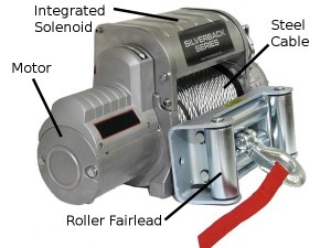

One other recommendation would be to install a roller fairlead on the winch to prevent the cable from rubbing across the side of the drum. If not used, you would have to pull almost straight on.
Roller Fairlead The fairlead guides the steel cable during the winching process and prevents the cable from getting snagged in moving winch parts. An aluminum fairlead is recommended for use with synthetic cable.

Does the winch specifically say direct drive, or is there a planetary gear set inside the drum? IT DOES NOT STATE ONE OR THE OTHER.
One other recommendation would be to install a roller fairlead on the winch to prevent the cable from rubbing across the side of the drum. If not used, you would have to pull almost straight on. I INSTALLED A FAIRLEAD
