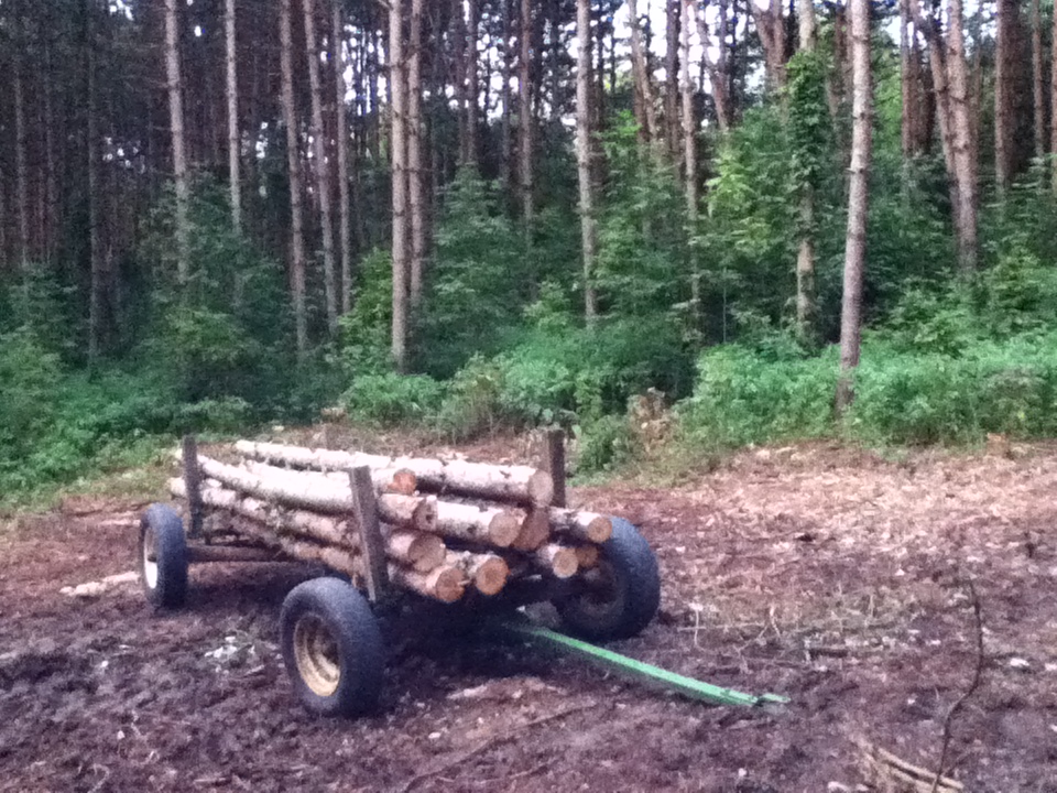

You don't have to spend a fortune to have a good log hauler, an old hay wagon will do,
Even an old "running gear" makes a good log hauler, it doesn't even need a hay wagon body on it!
IF you have LOTS of logs to move, pull doubles!
Anyway, the point is, you just don't have to spend a bundle to move logs!
SR
   / Winch, log trailer with grapple or both ?? #26
Your picture illustrates how tricky it would be to try and pick off just one log using just forks without a grapple.
Even trickier if you use bolster* stakes on each corner of the wagon to hold the logs on.
(*: It took me a long time to figure out what they were called, so that I could order the bolster bracket that bolts to the bolster of my old running gear.)
