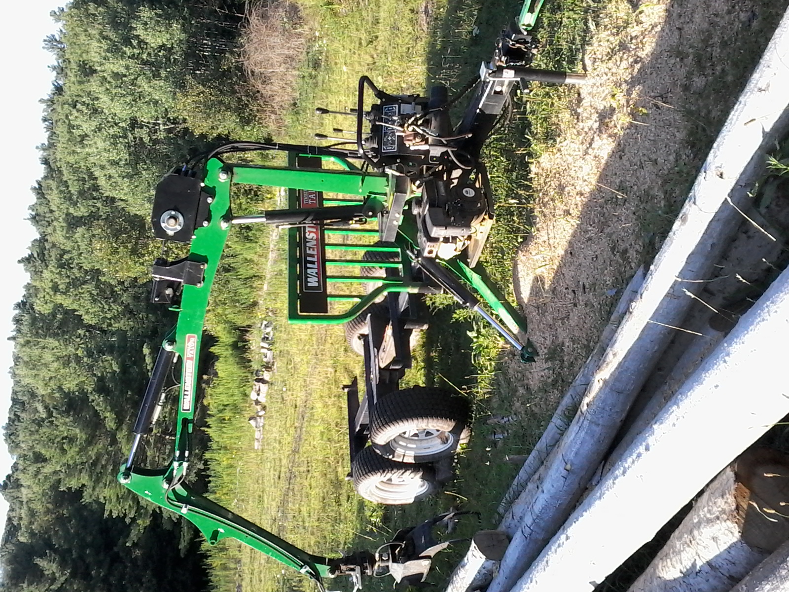

I own a 3 ph winch and love it. I use to own a wallenstein grapple trailer, thought I would love it, but it was more a pain then a help. The trailer was clumsy in the woods and tight trails. It was time consuming positioning the trailer to load logs in the woods. I had to load a few logs then get back on tractor, move to load logs, then move again to finish loading. Then all the time to unload. The hyd winch on the boom was nice, but slow. I too thought I could hold the log at waist height to block up firewood, but the grapple head was a free floating head, so as soon as one side of the log got light, it shifted with the floating head. The grapple trailer was so time consuming compared to the 3 ph winch.
with the 3 ph winch, I was already hooked to the logs, so just skid it to the landing. So much faster and less monkey business then unhooking the log along the logging road and comming back to load on grapple trailer.
your L3800 would not handle much of a load to be productive with a grapple trailer in my opinion. A large grapple trailer with long reach boom would give good efficient production, but you ain't comming close to handeling that much weight behind a 4000lb tractor.
I would go with the 3ph winch atleast for starters imo.
I am on steep hills, narrow dead end logging roads, and do over 400 cord firewood a year with my tractor, winch, loader forks set up. Works great. The grapple trailer did not work efficiently, so I sold mine and never looked back.
to answer your above question, I have skidded around a mile one way and haul between 2 to 3 face cord behind my 50hp kubota in a hitch. I believe your L3800 could pull 2 face cord at a time, but would struggle to lift the weight of it on the 3ph with the weight of the winch and logs. Would have to have good traild as well. My opinion through my experiences. Results may vary.

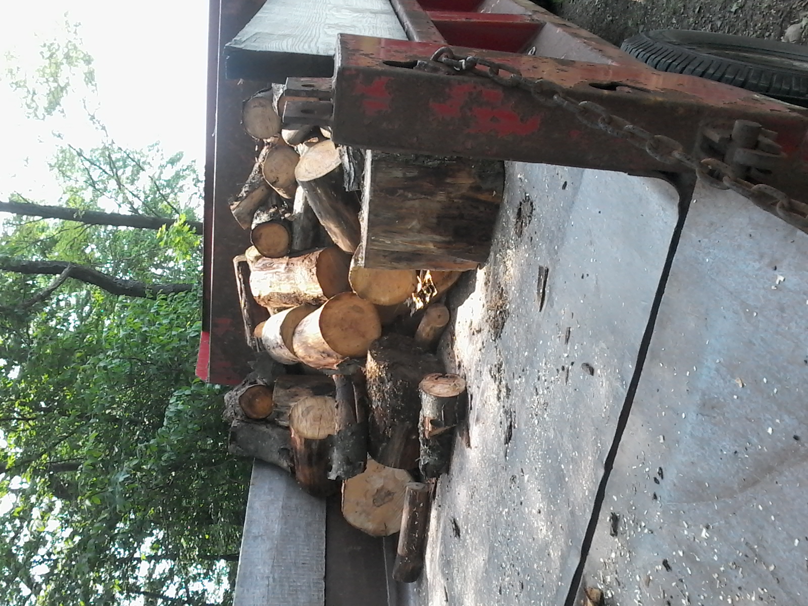

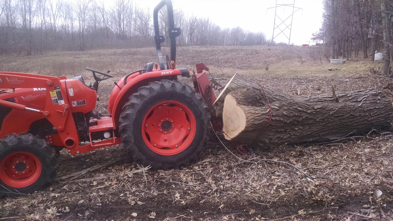

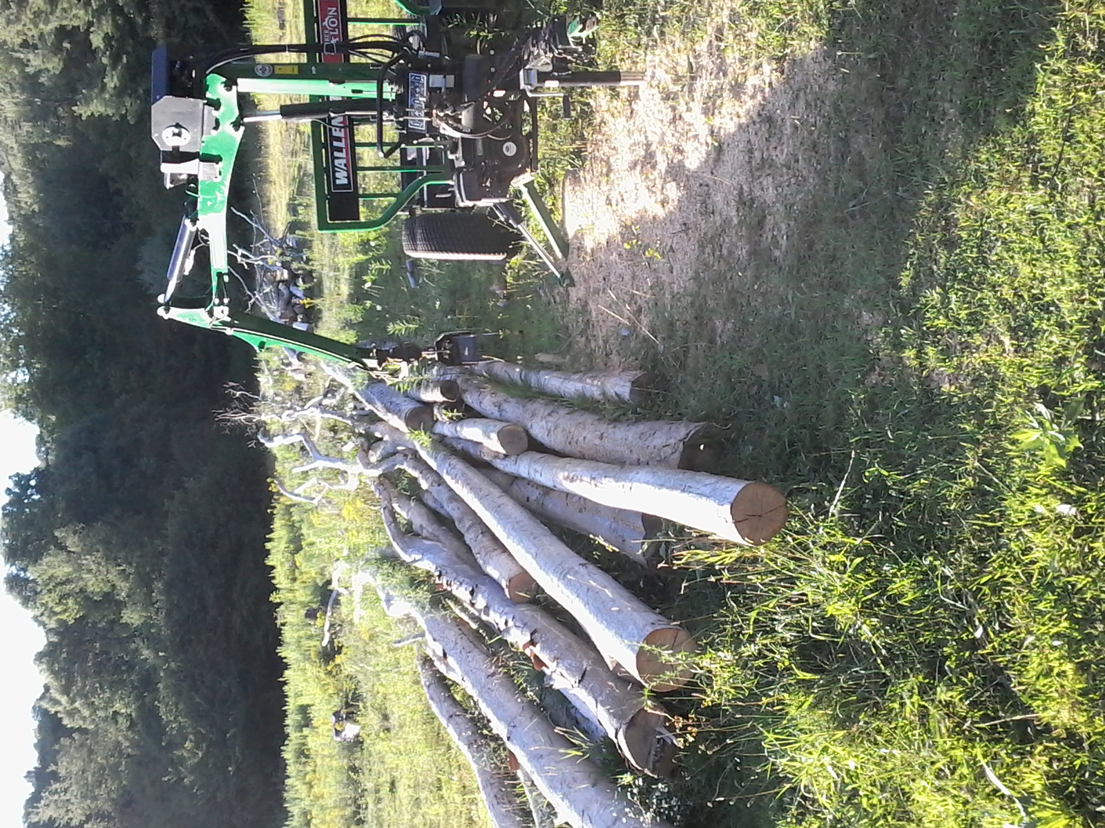

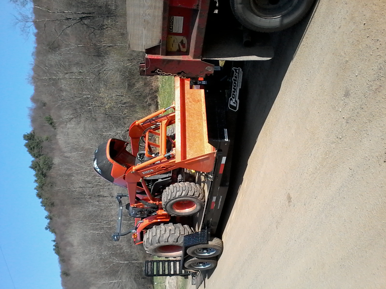

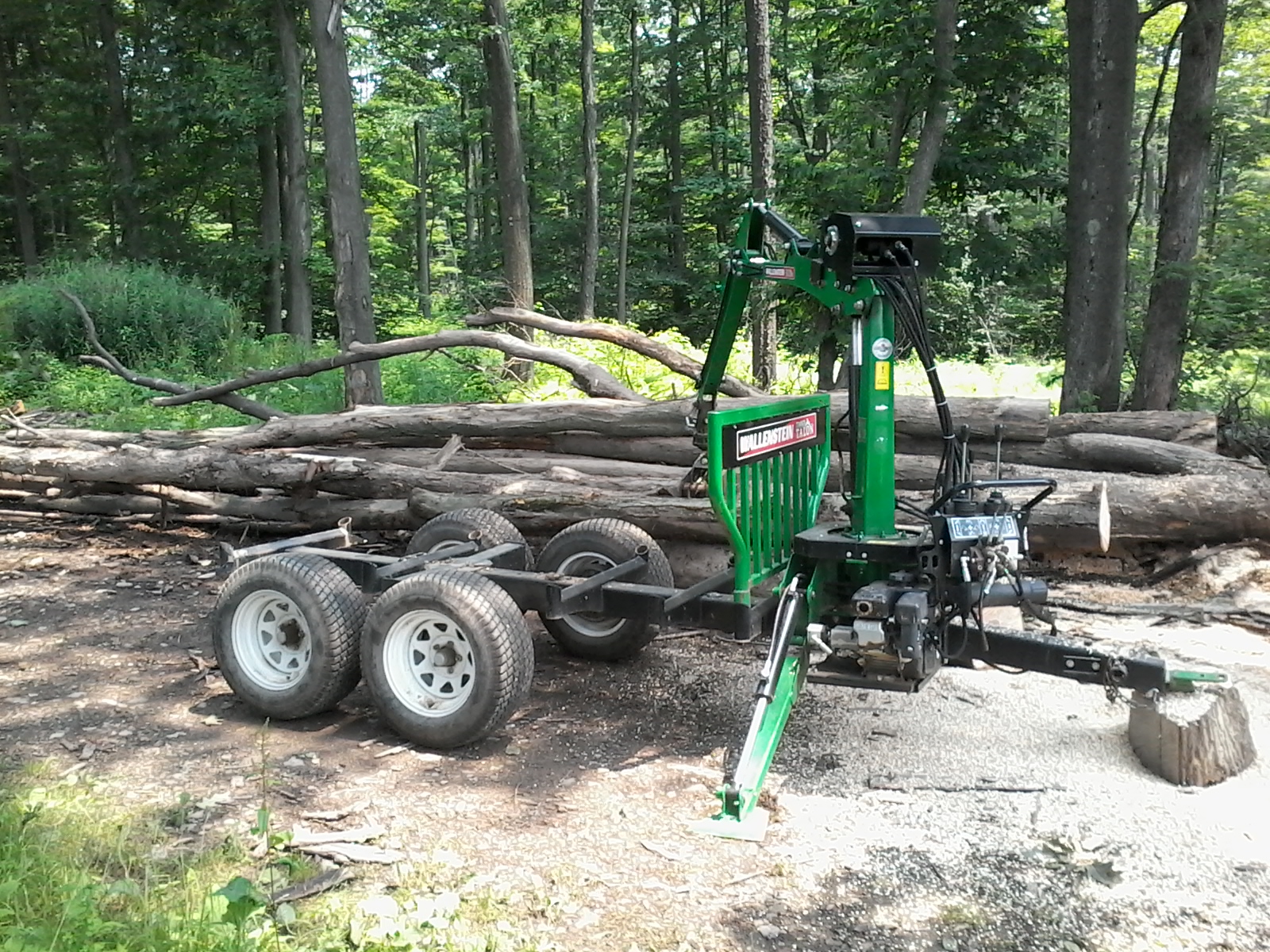

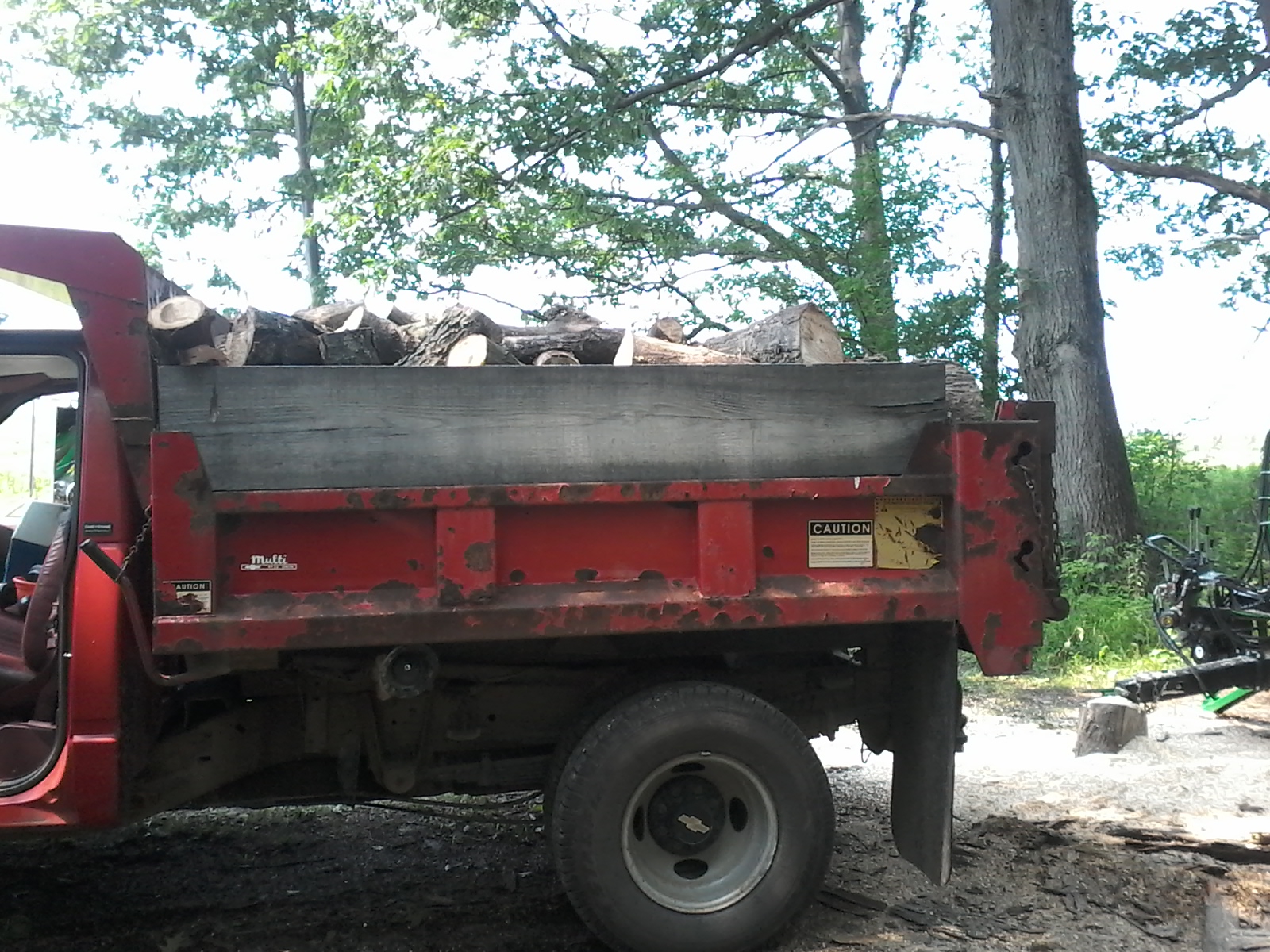

I am not too good putting pics with computers, but I try to post a few here.
20150503_084913.jpg20150705_113300.jpg20150404_165448.jpg20150404_165421.jpg20150705_122537.jpg20150802_185538.jpg20150802_185910.jpg20150705_122557.jpg
I should get some more pics of the full operation. Maybe someday I will get around to it.

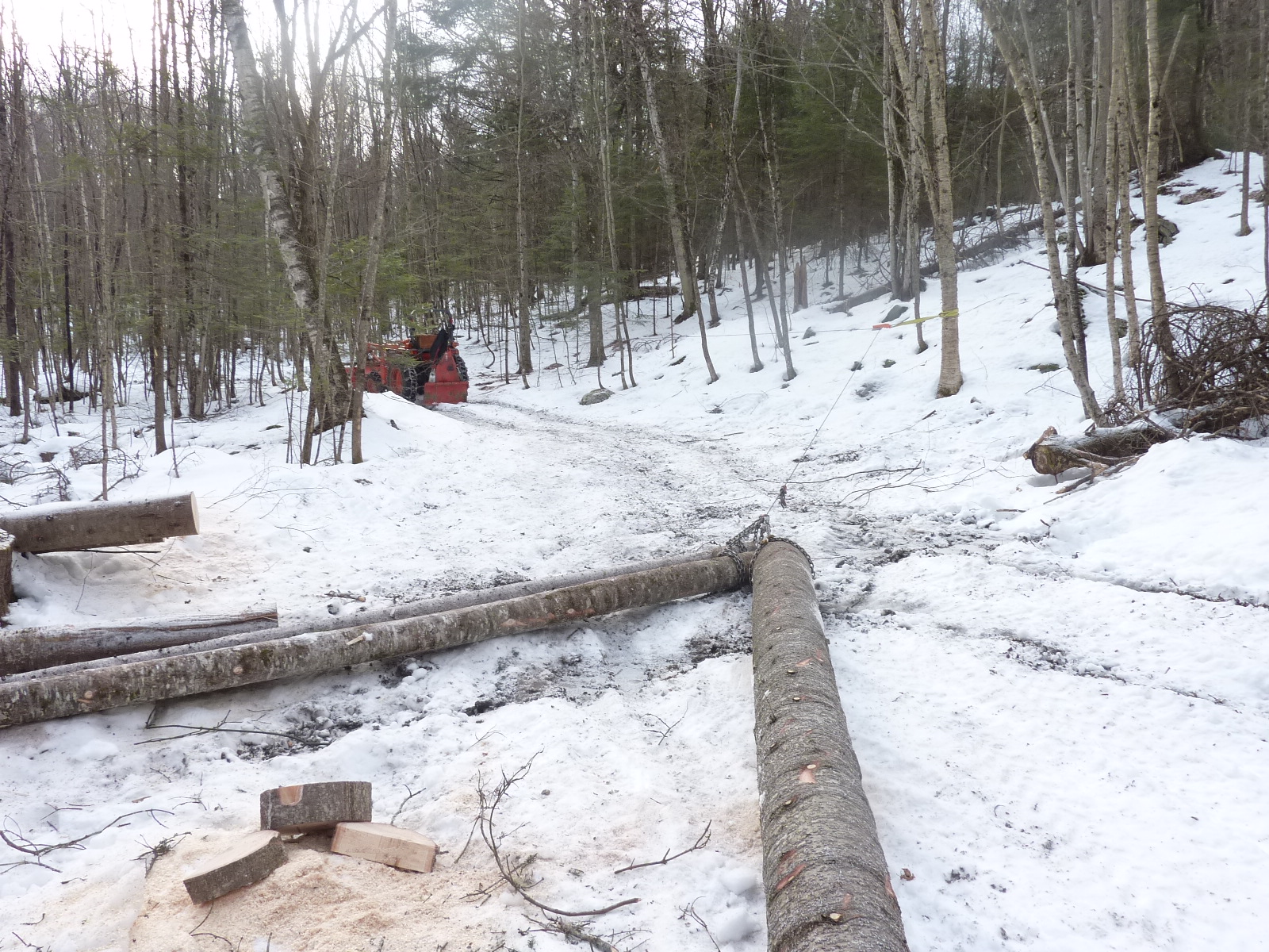

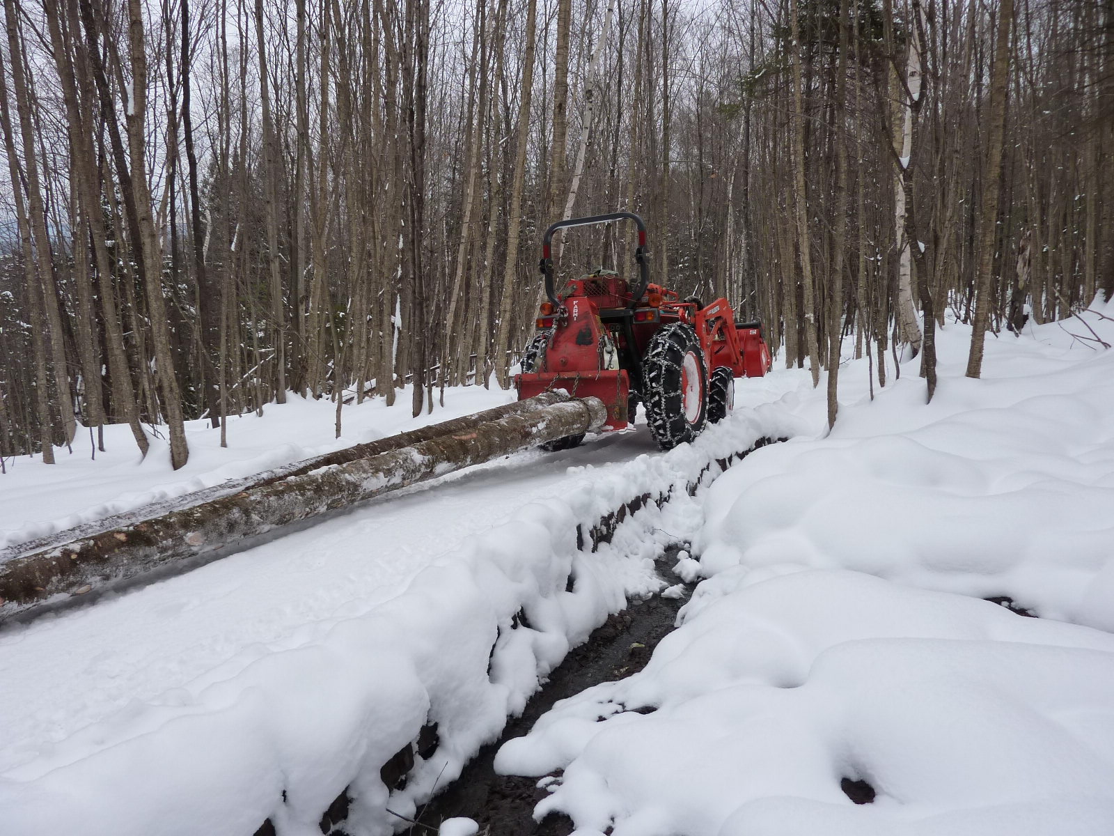

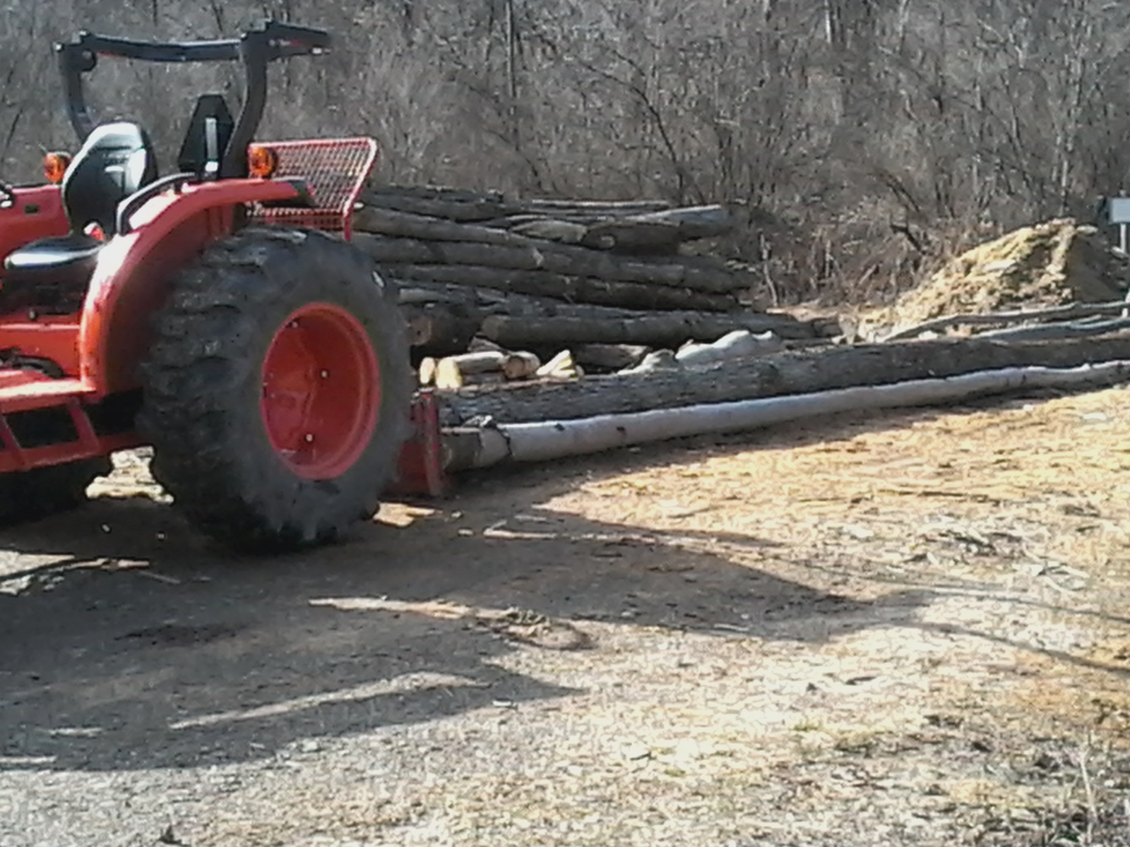

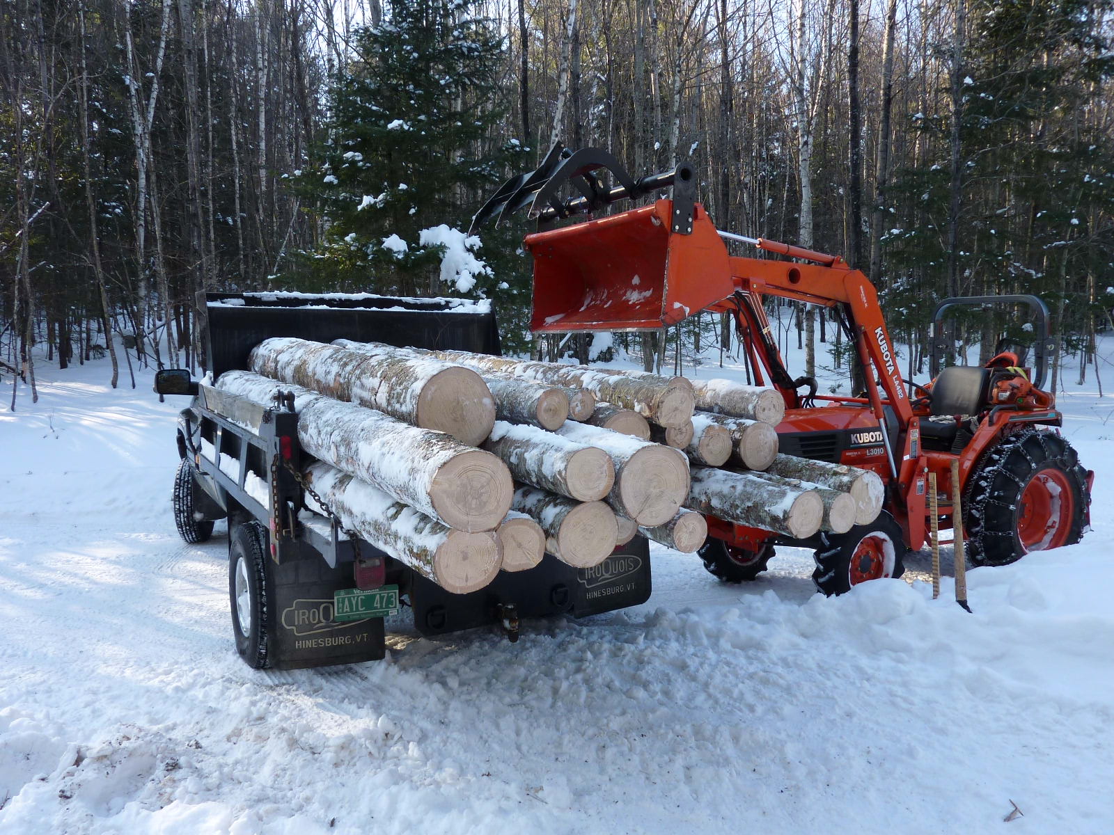

I cut my saw logs to 10 or 12 footers and occasionally a 14 footer because that is all my truck will handle and the mill I use won't take 8 footers. So they are actually cut to 10'6", 12'6", etc for the mill.

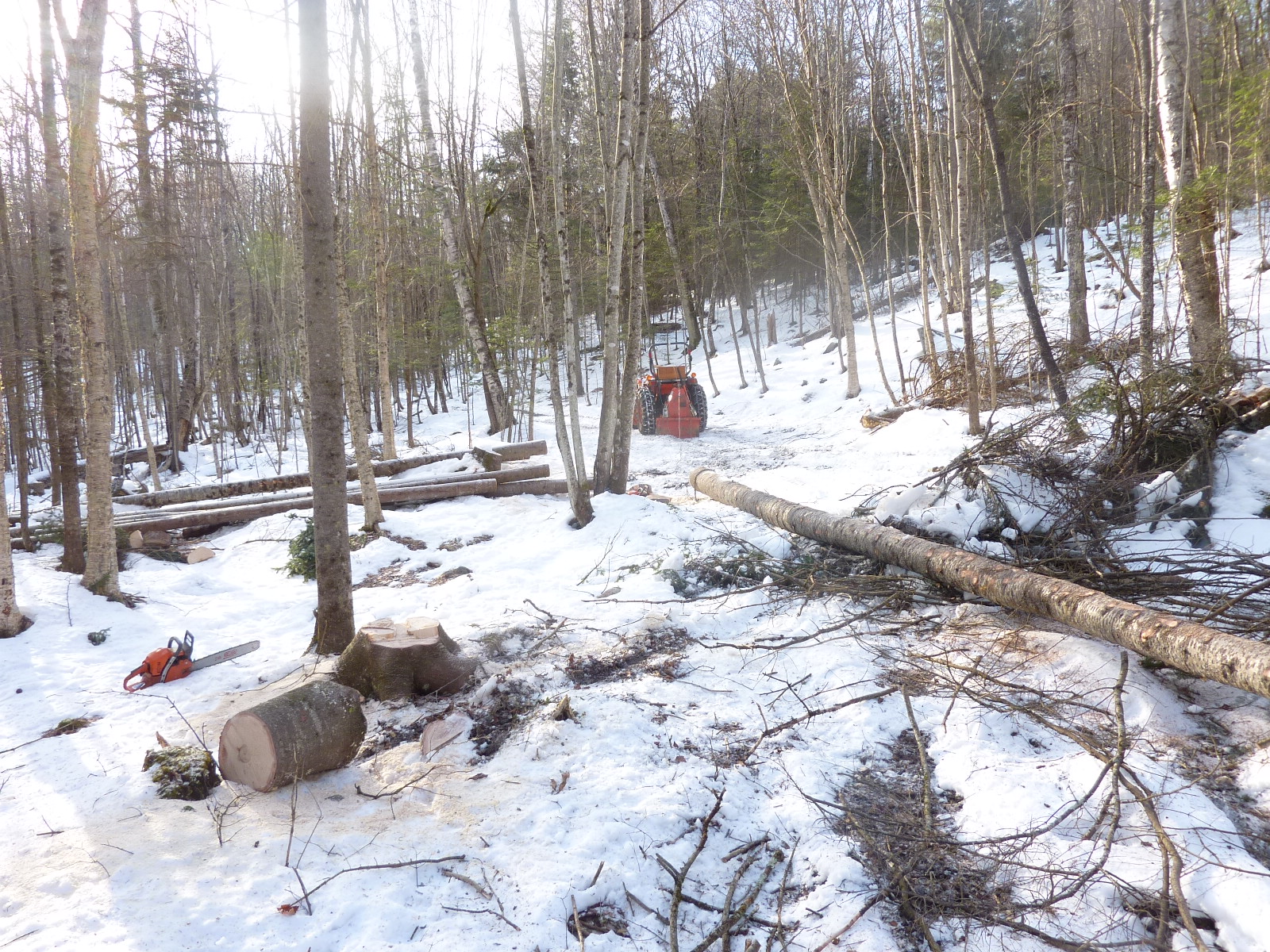

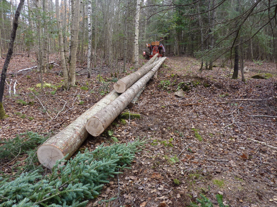

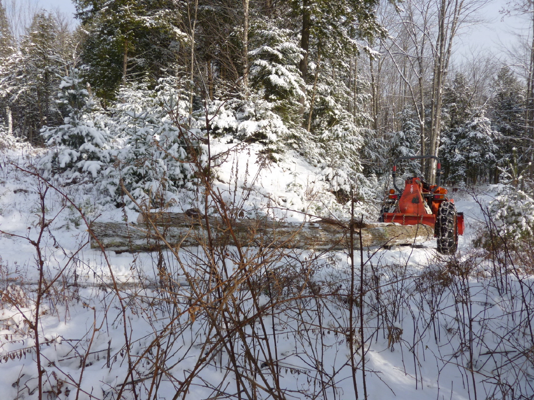

I cut a tree in the woods, limb it out, and then figure what I can get out of it for saw logs. I cut it so I can get 3 and sometimes 4 saw logs out of each length I skid. So the skid lengths tend to be between 35 and 42 feet. After the tree is cut to length where it fell I winch it to the trail side and leave it and go cut the next tree. I might get enough for several hitches bunched up.

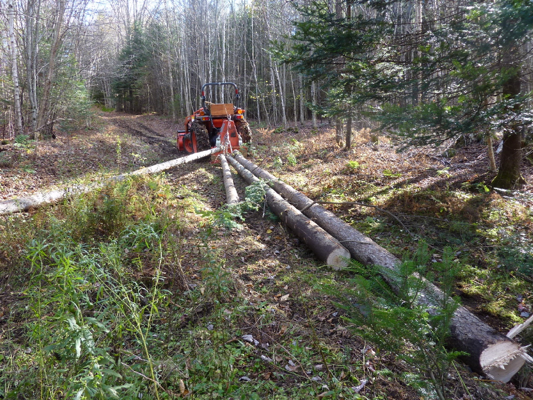

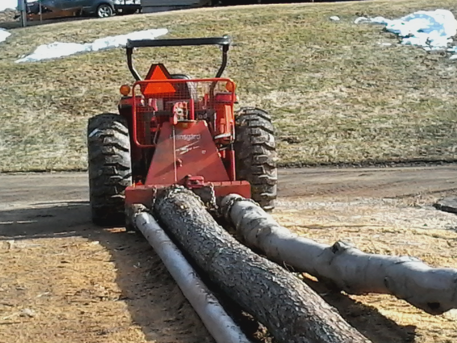

Then I position the tractor to gather a hitch from the trail side logs

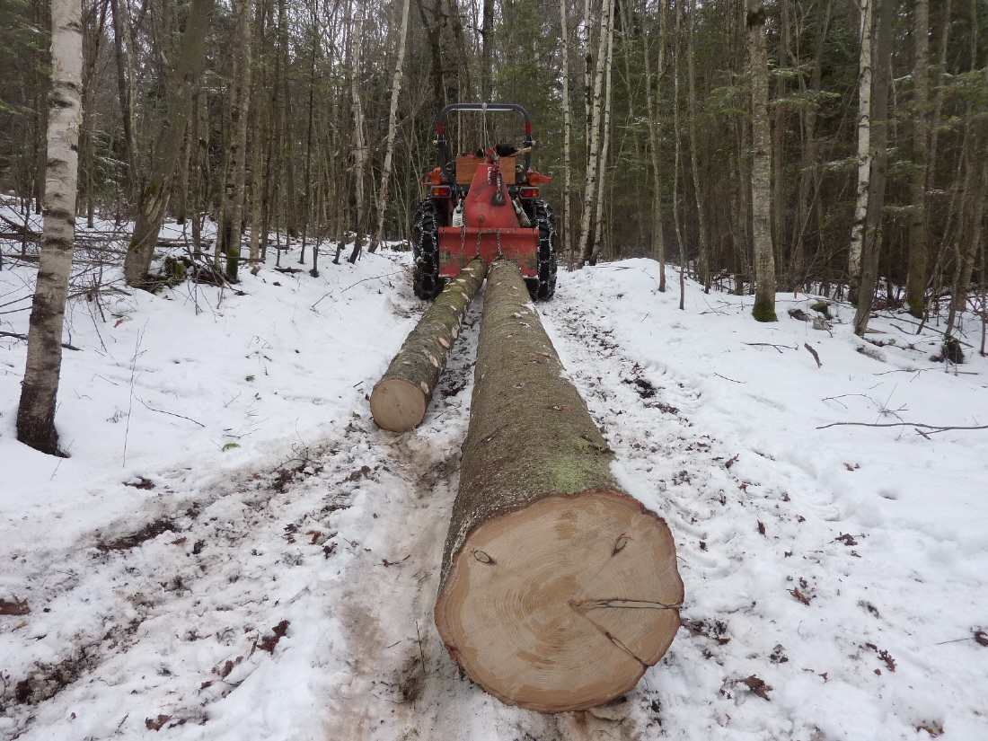

I get a hitch with what comes easy rather than trying to get the biggest hitch possible. Things go smoother and faster that way for me. It also depends on the trail conditions and terrain. I would rather have a hitch I can pull thru a mud hole or up a short steep pitch than have a bigger hitch that I can pull but have to drop and winch thru the tough spots. It is faster to keep going. Most of the time I skid between 1/4 and 1/2 mile. Sometimes more sometimes less which is really nice. I have an L3010. A little smaller than your tractor. Here are some typical hitches. Again I want the pull to be easy not a challenge.
Working with a small tractor in the woods is slow work. If you are in a hurry you won't be happy no matter what equipment you have. Just my 2 cents.
