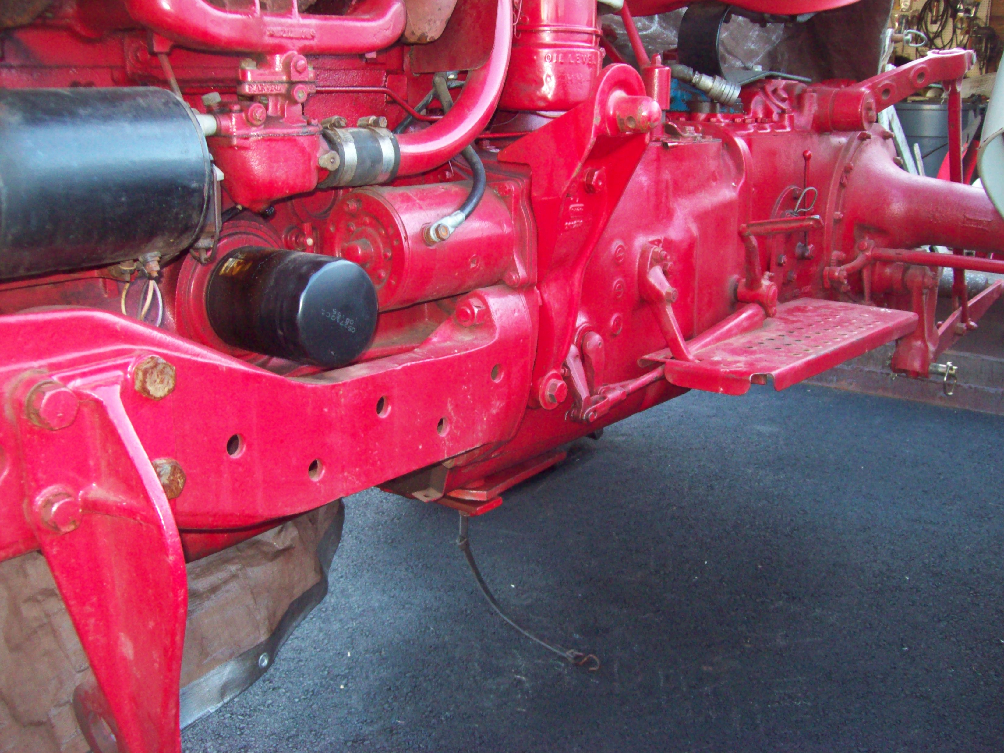

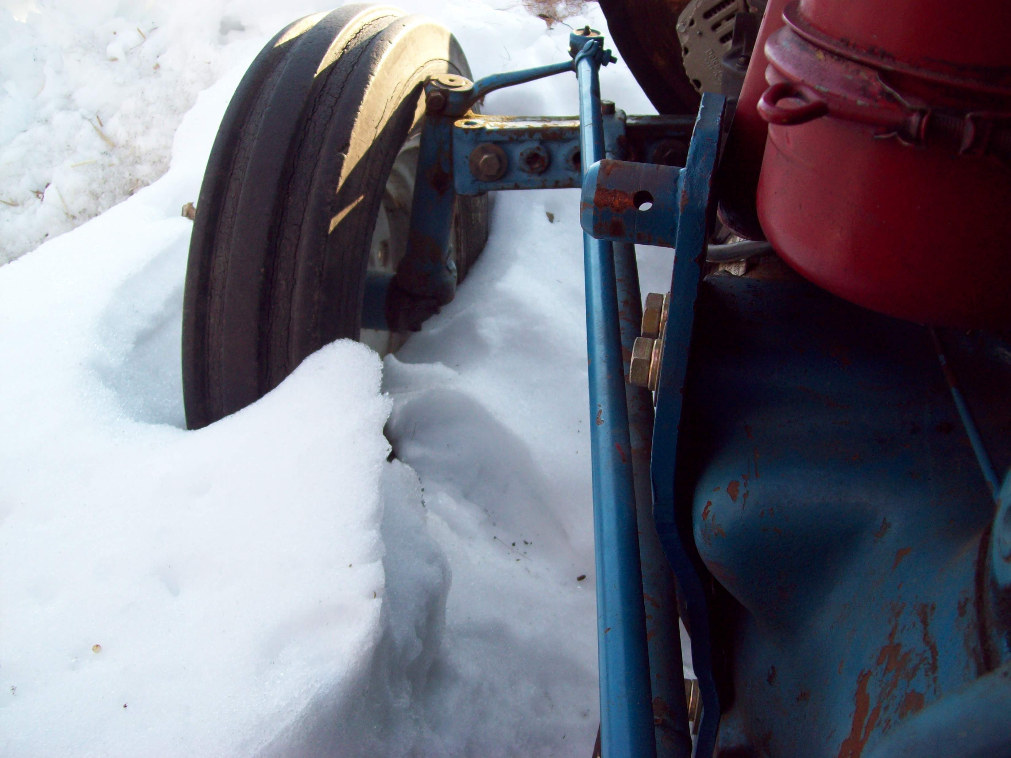

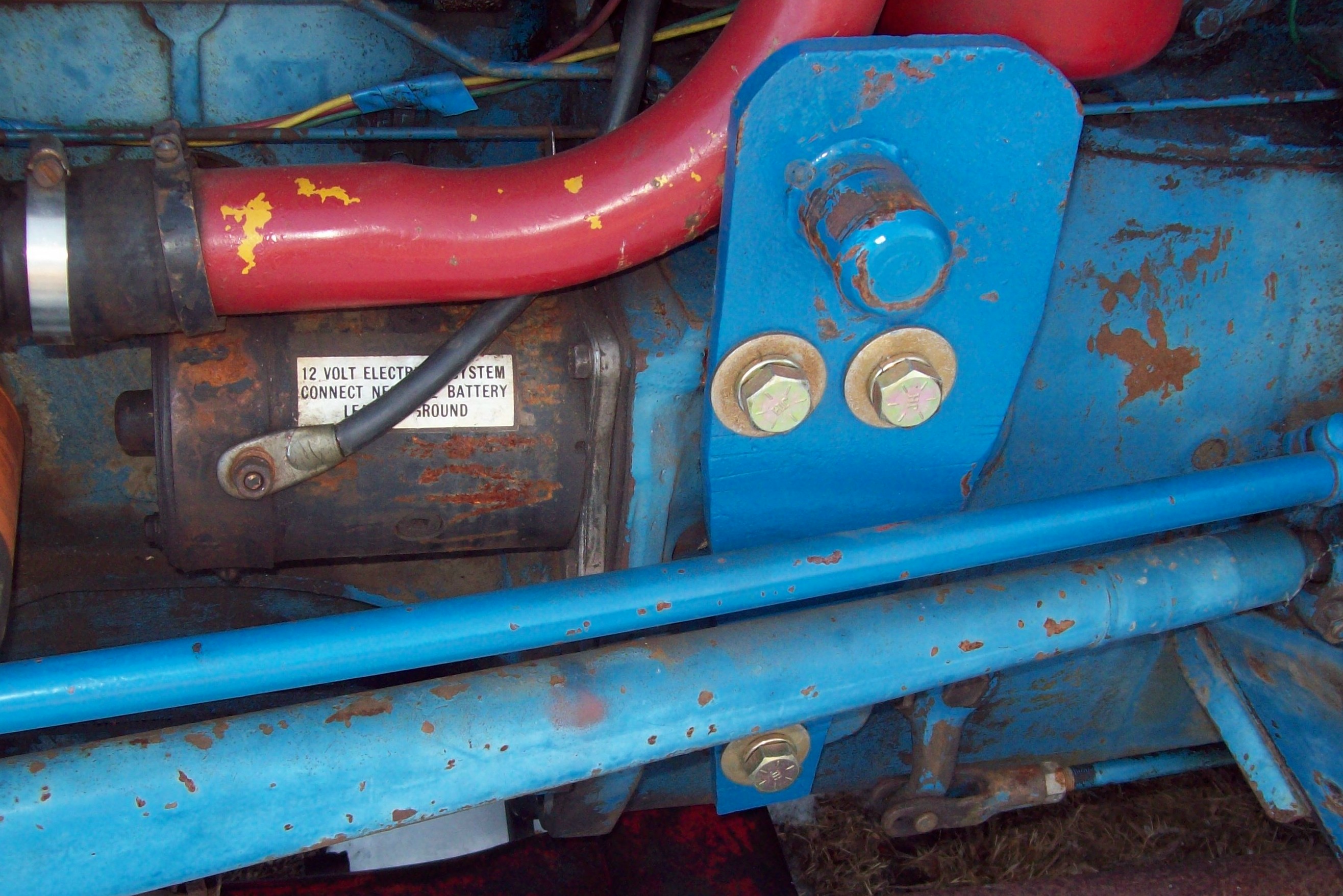

Here is a shot of my homemade bracket and a bracket from one of my row crops. This bracket is an offset to mount the short box. The front row crop bracket is a whole other thing.
Your'e kind of getting a head of yourself. first find out is the owner has any bracket, if not he still might be holding around that price because he thinks it's "rare".

As a buyer/seller he should at least know what he's selling. He knows enough about it to put a price tag on it. The main concern should be the hip bracket, The flat stock can easily be fabbed up. I can even trace the flat pieces and send them to you. Condition of the bucket is also important, which you can not see from photos. If you can take some photos of the brackets it might help for a better ID.
Kirk

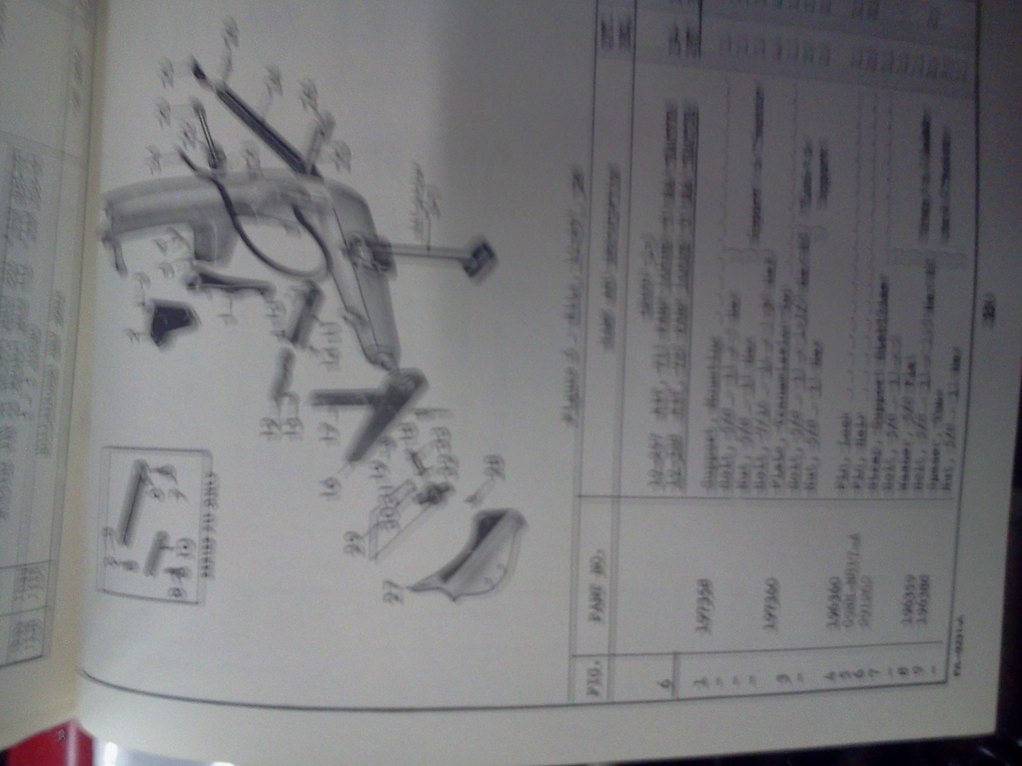

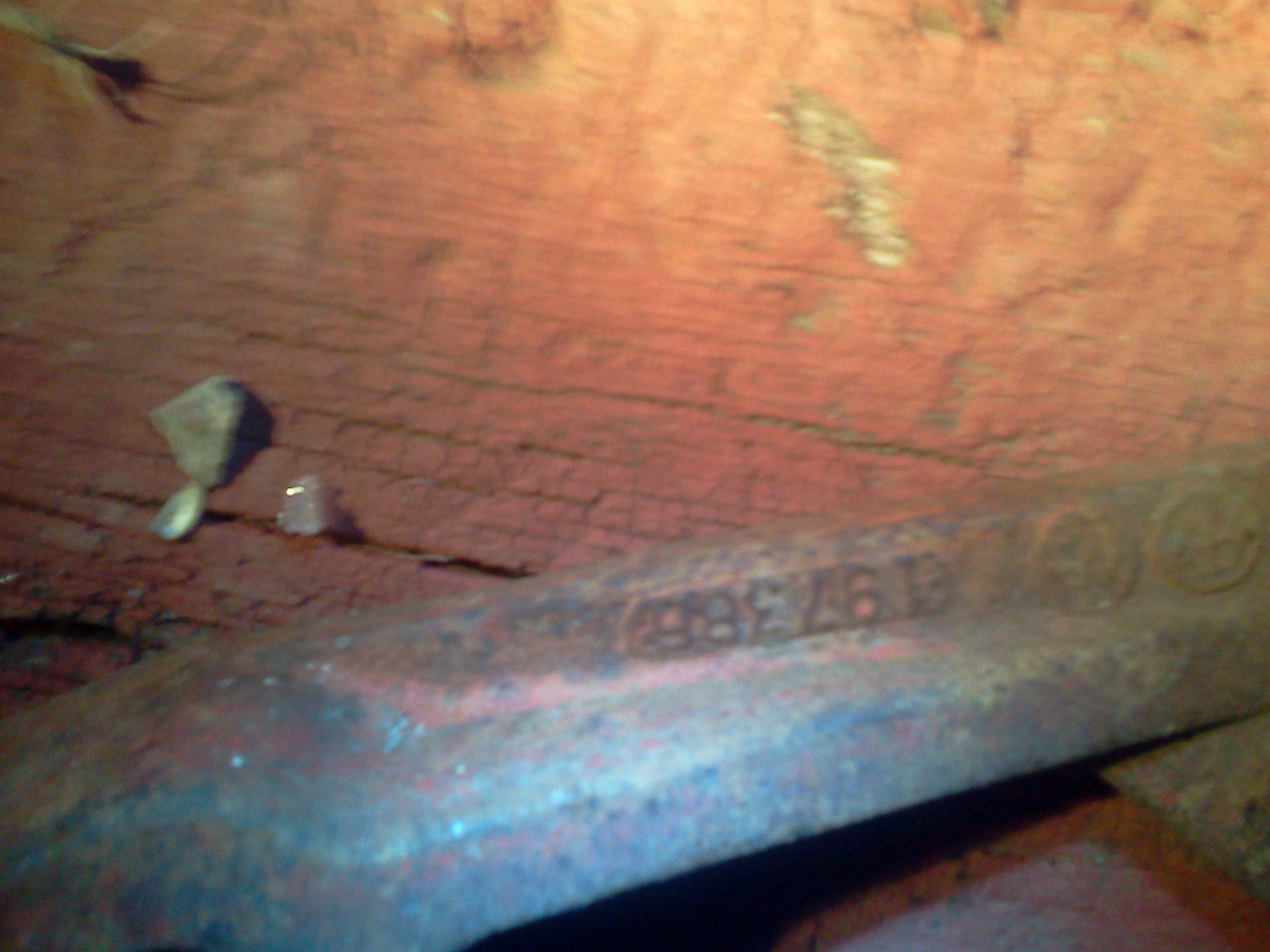

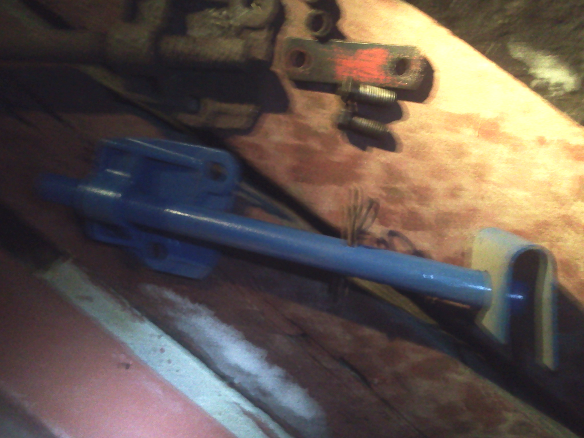

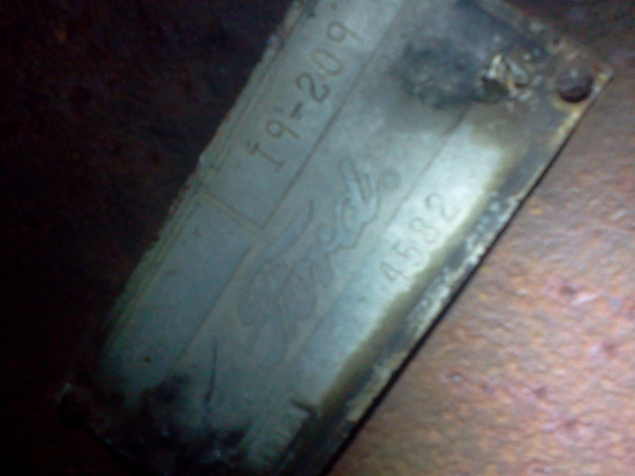

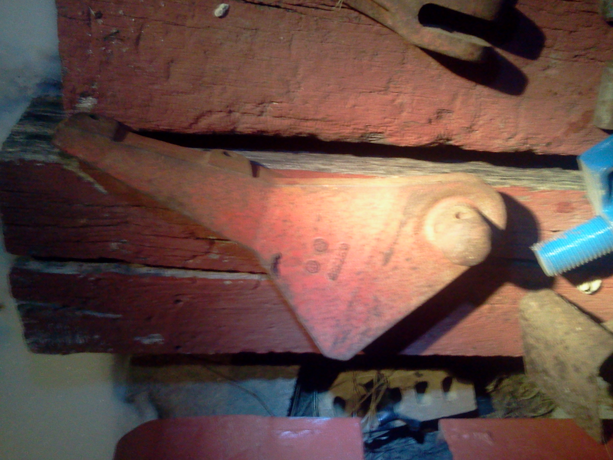

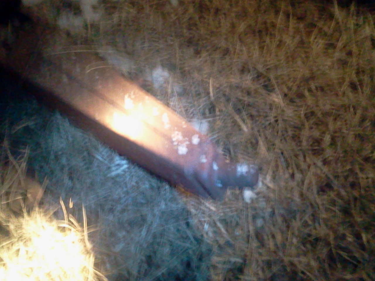

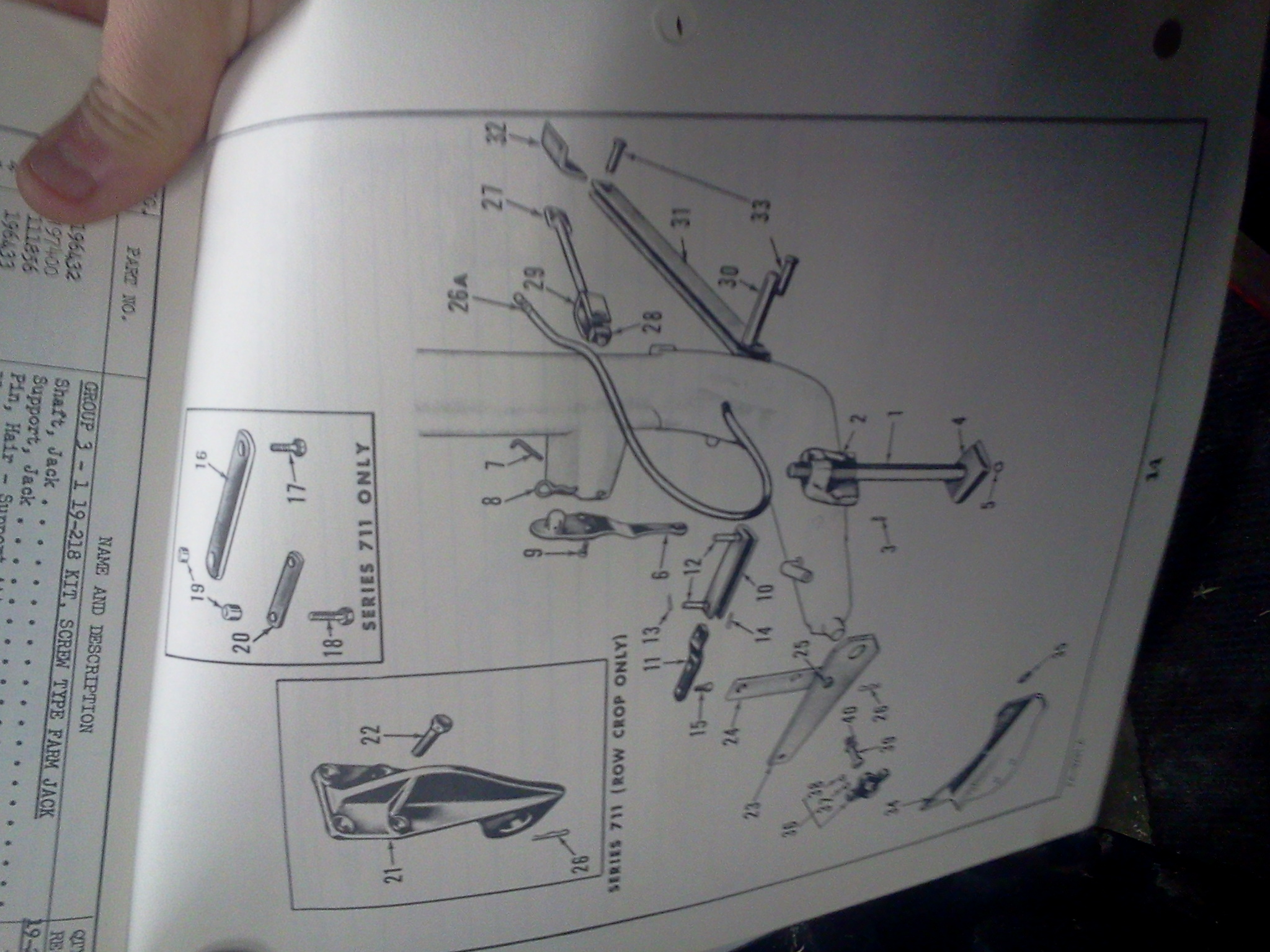

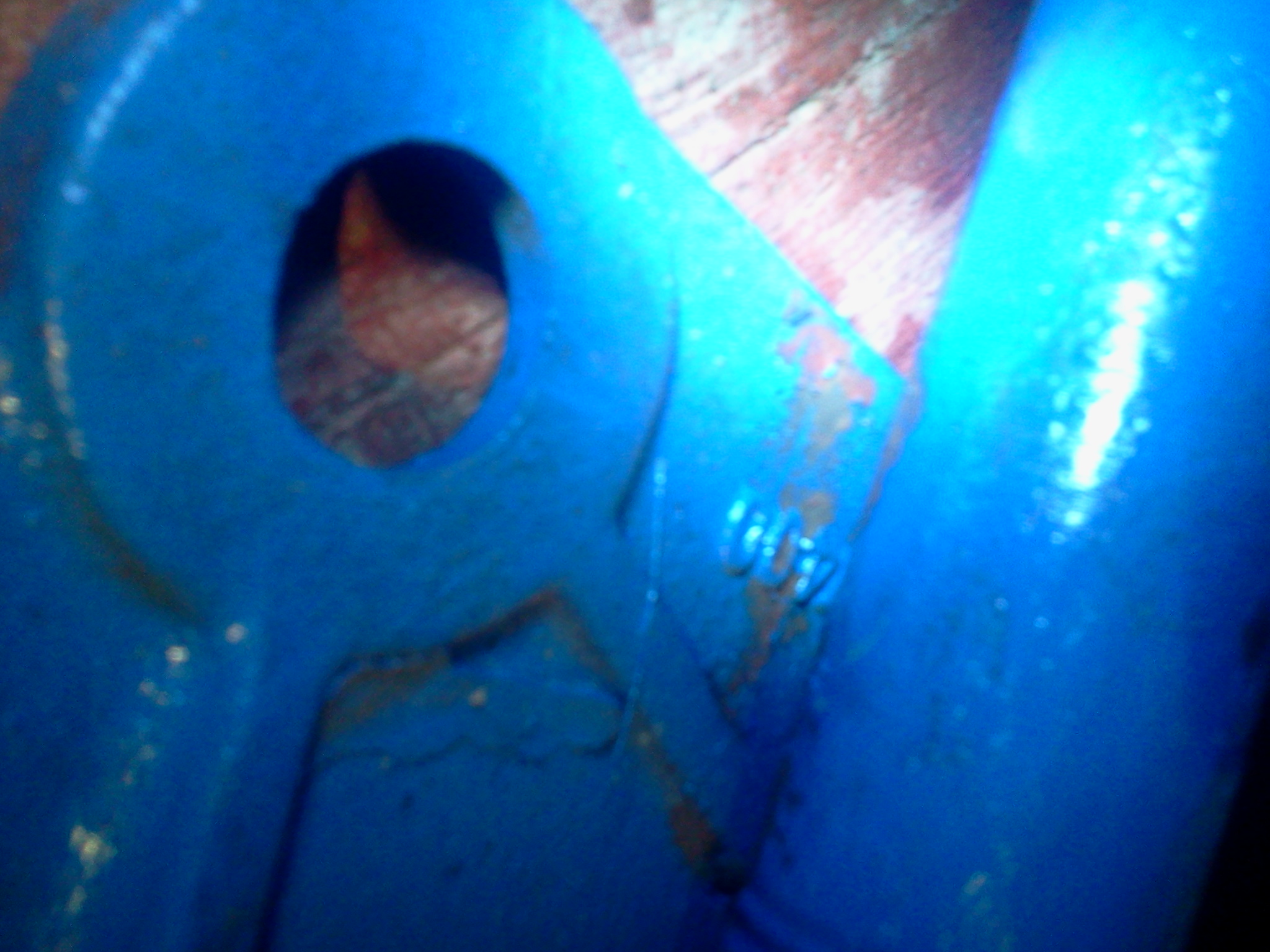

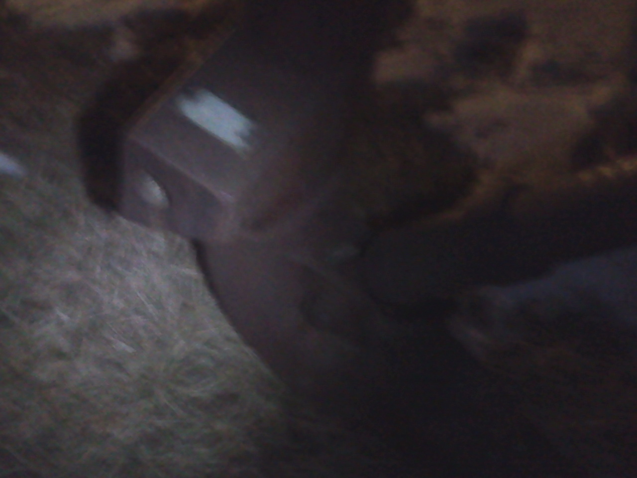

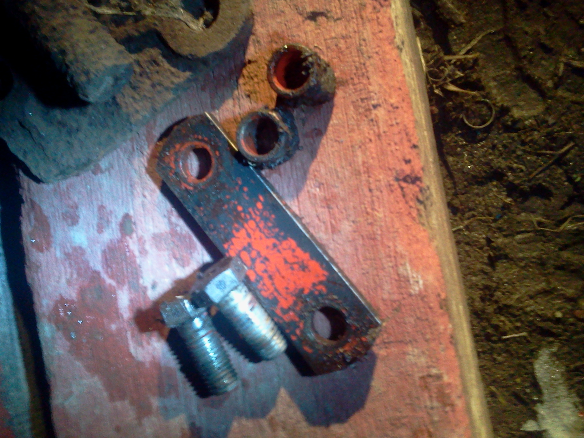

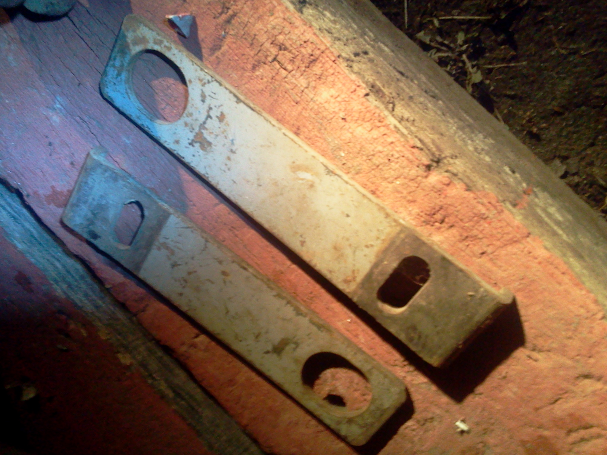

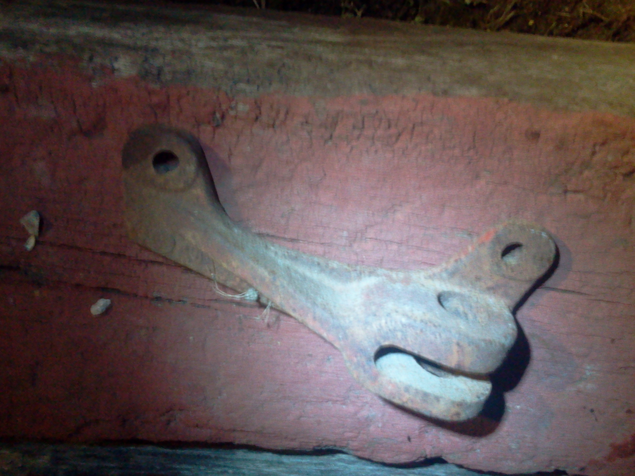

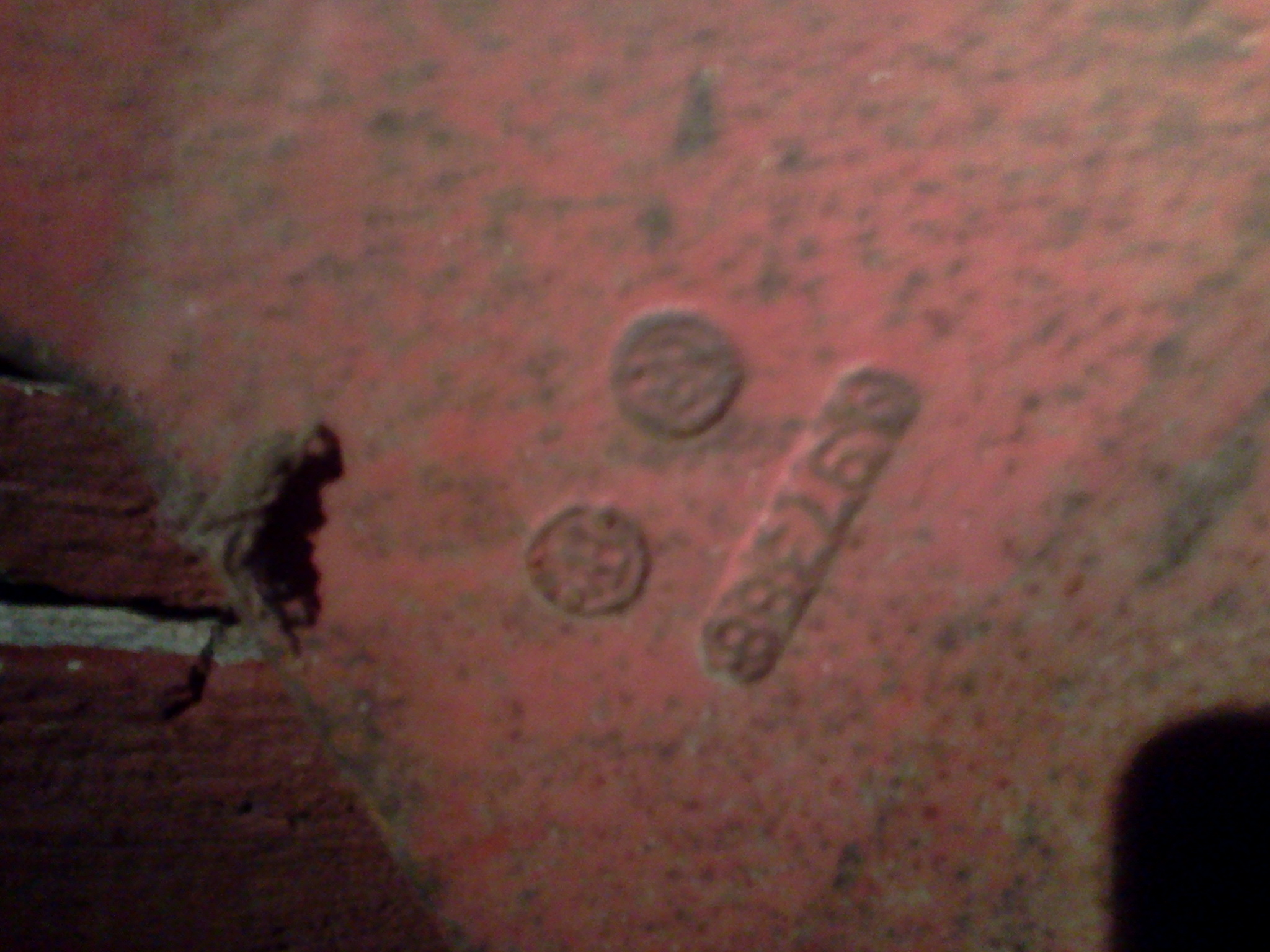

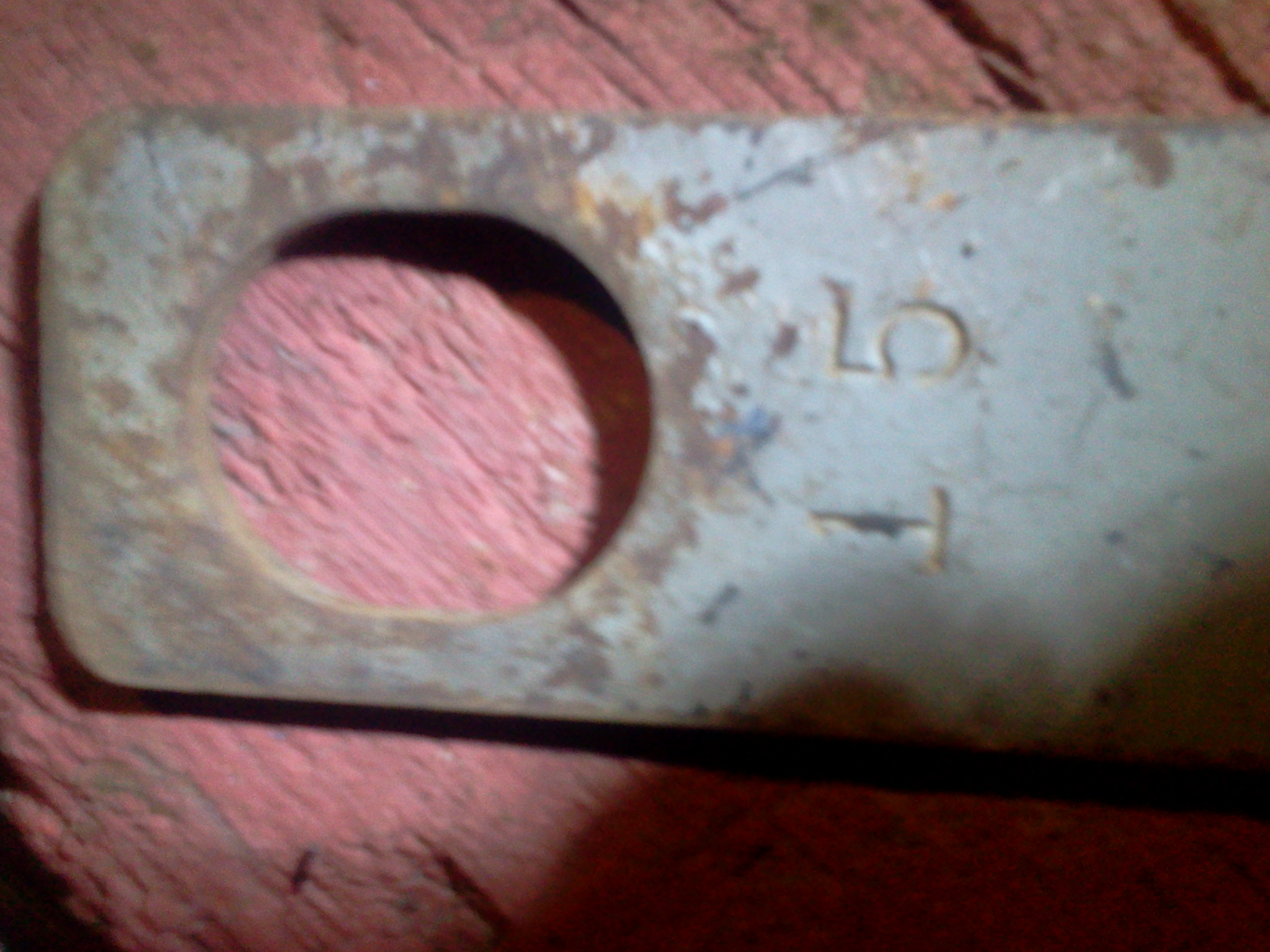

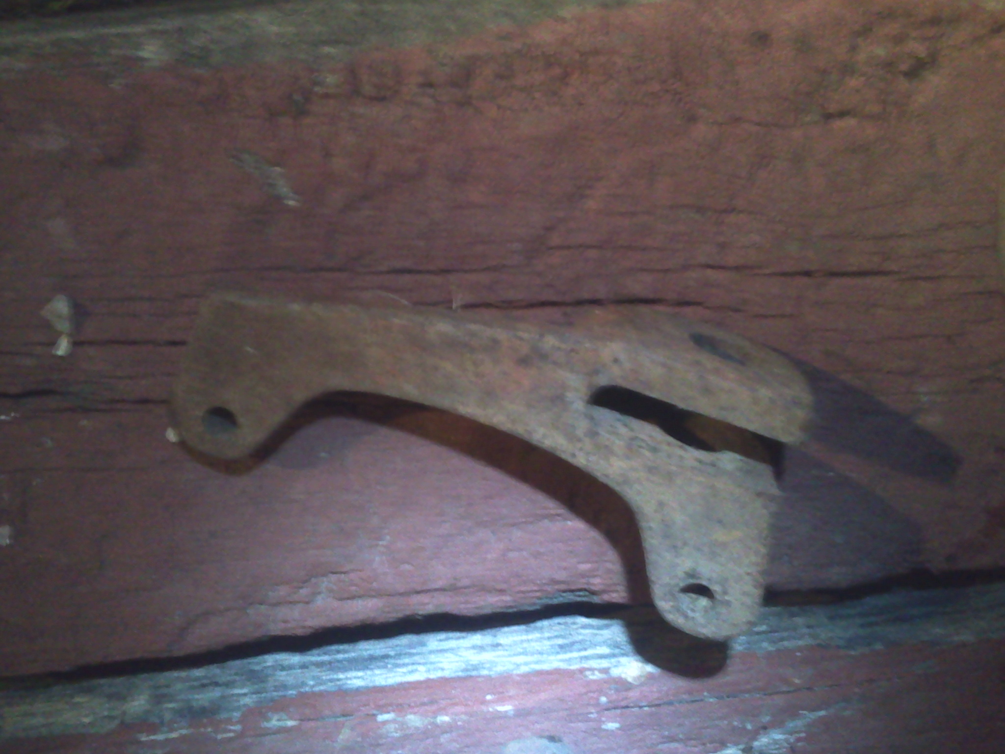

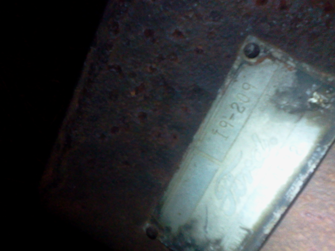

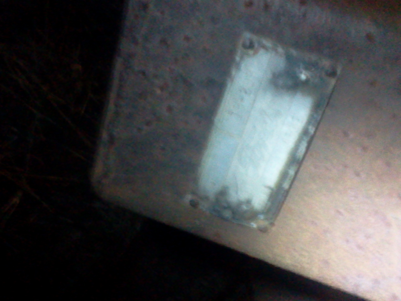

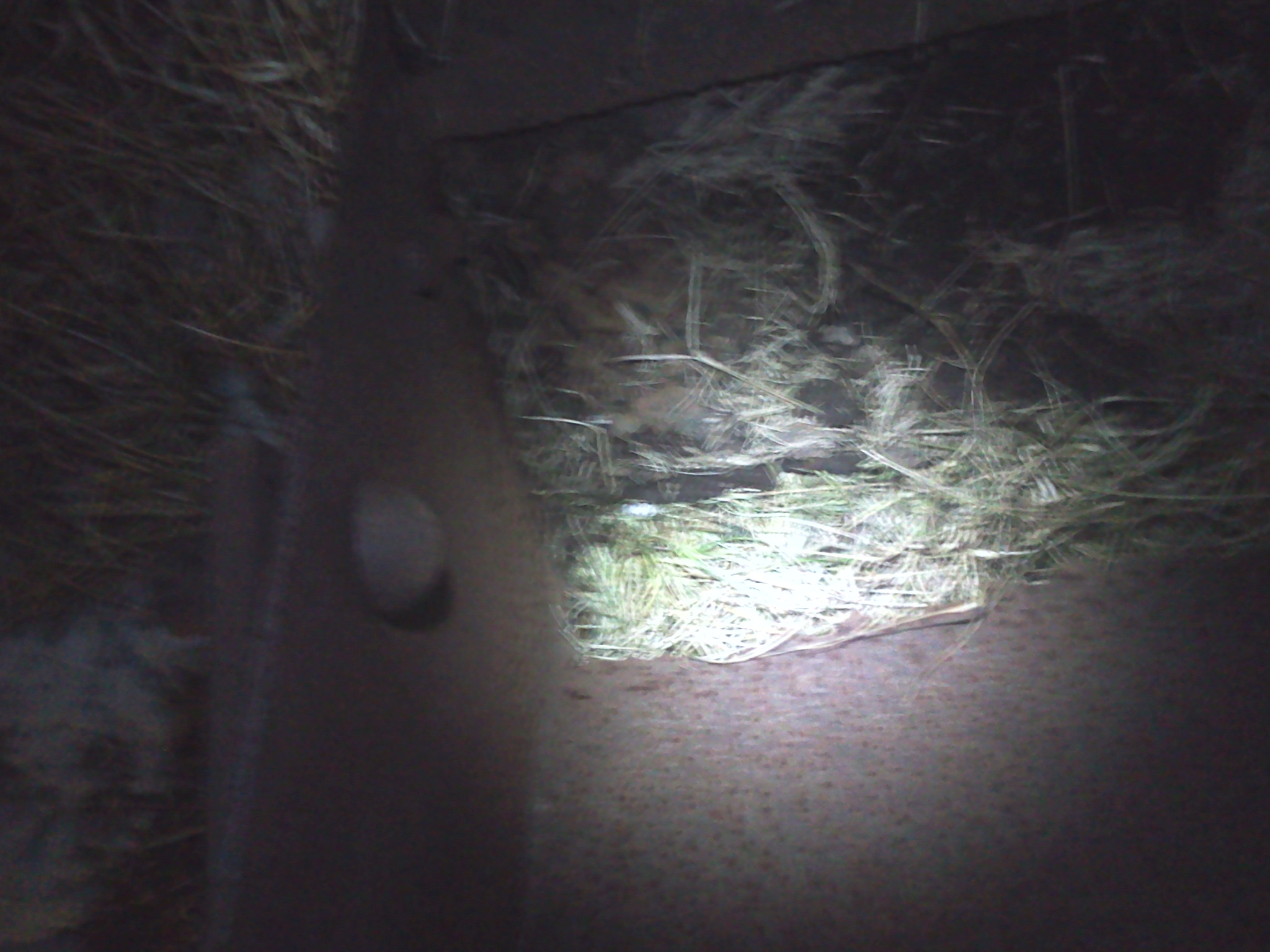

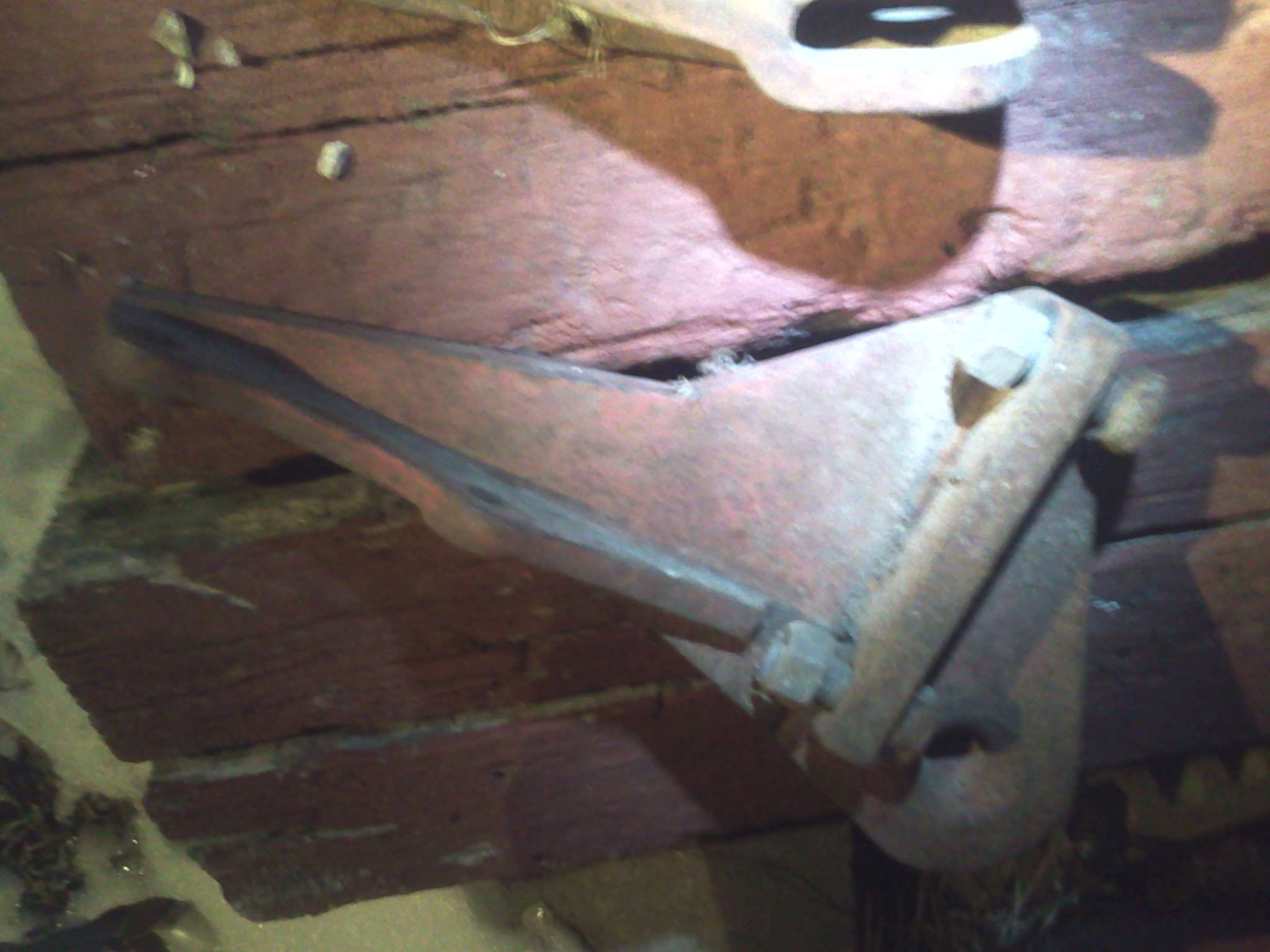

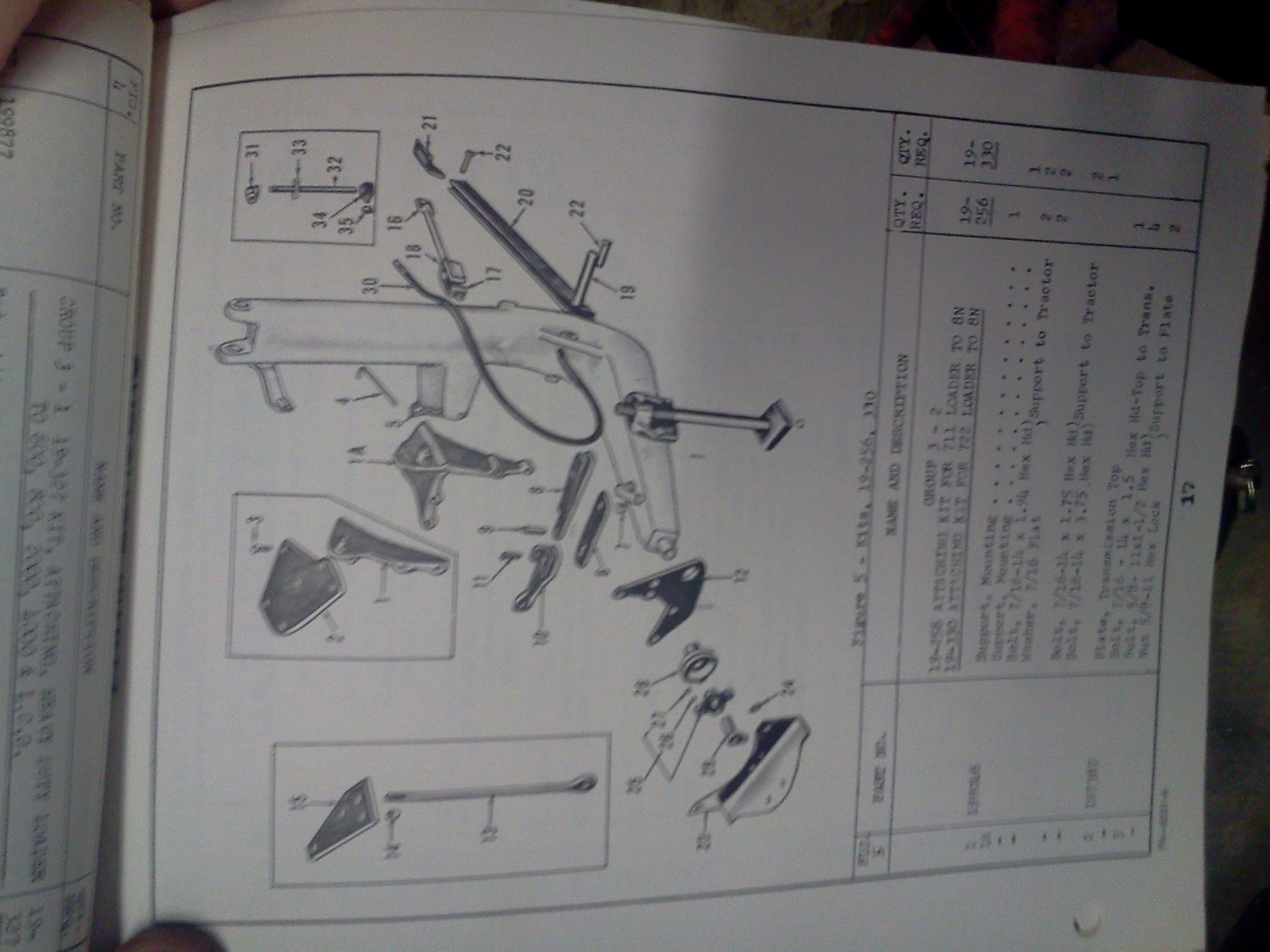

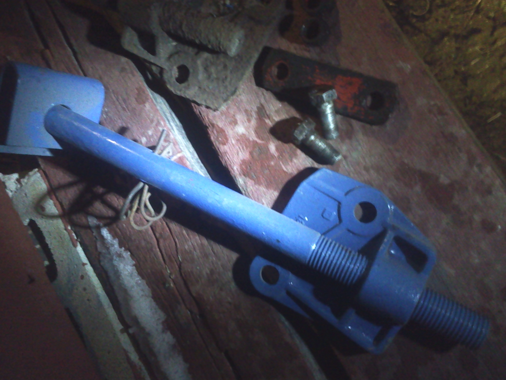

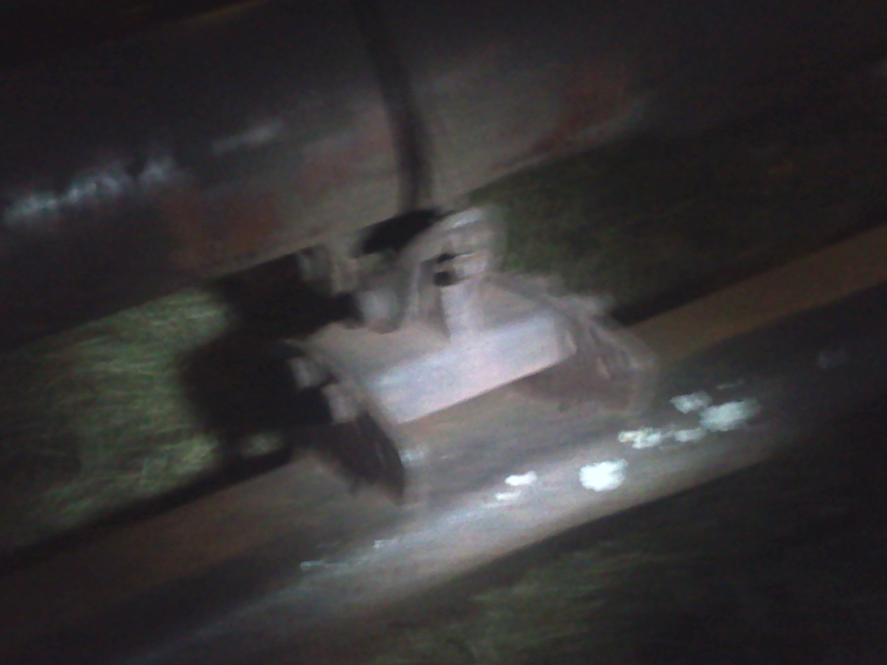

Well, only one bracket seemed to match up. I took some pictures and told the guy I had more work to do. He had a manual and I took some shots of that too. Note all these pics were taken via flashlight so visibility may not be great. Looks to me like these brackets might be for an 8N. He thinks he took it off a 4000, and claimed he'd never seen an 8N with this loader.

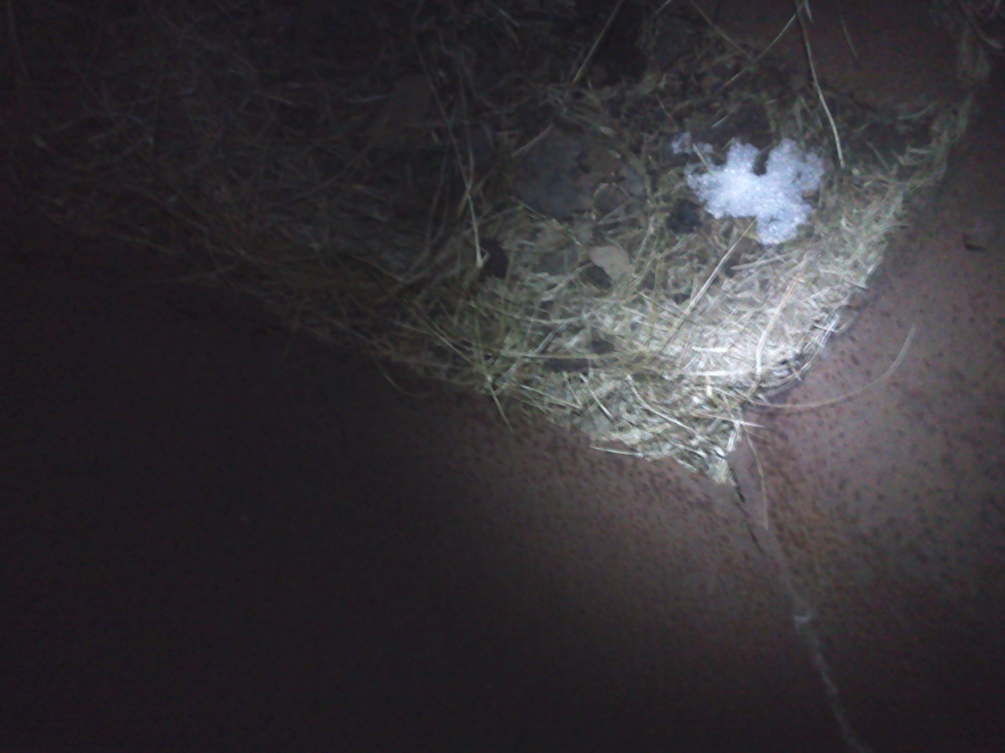

The metal itself was all pretty solid, except for the rear bottom corner of the bucket which was rusted thru all the way across. The bucket release mechanism also looked like it would be a chore to remove all the rust on it.

   / Will this one arm loader fit my 881? #26
This is an incomplete set for an 8n. If he still has the tractor some of the brackets are probably still on there. If interested I would trade a complete set of brackets for mounting on your tractor. If interest send me a pm to work out the details. From the photo it's hard to tell the condition of the bucket or anything else.
Kirk
   / Will this one arm loader fit my 881? #27
wow.. kirk got to you before I did.. but as you now know.. you will have little problem trading 8n brackets for 00/01 series brackets I'd make the trade too. ;)
8n, dexta and NAA brackets are the most rare.
   / Will this one arm loader fit my 881? #28
We made a deal and he will get his 881 loader on and I'll fab up the rest of the 8n brackets so I can get the one arm manure loader on the 8n and get some more manure on the garden before plowing, if this 2' of snow/ice ever melts.
