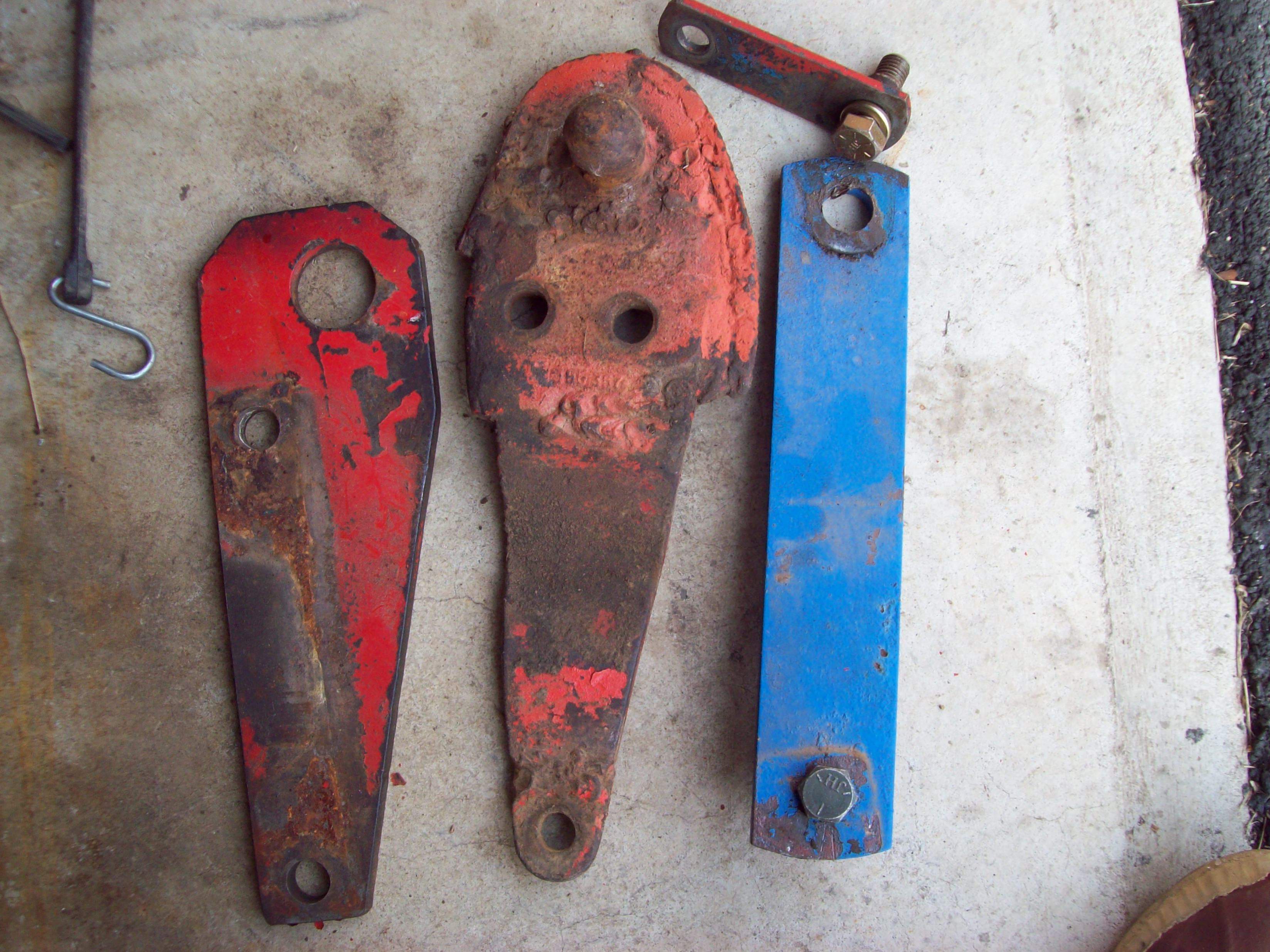

The trans hip bracket would be the hard one to duplicate, the rest you could fab out of flat stock. I have a homemade hip bracket on my 4000. Who ever made it did a real nice job. Here's what a set of brackets look like. this set is missing one more flat piece about 6" long.
Do you have a side view and opposite view of that middle one (assume that's the hip bracket). It it shaped that way to rest a spherical shape in it? I'm envisioning a human hip femur ball LOL.
If you are lucky enough to get a set for an 8n or NAA it wouldn't be worth hacking them up to make your set being they are worth triple the money.
the 8n set woulodn't help at all anyway.
the naa set.. only the front and lower brackets fit.. and those are torchable out of 1/2 plate and 3/8 plate,
ditto on the hip bracket being the difficult one.
I have seen 2 made. one was on a rowcrop where the steering arm was not an issue.
the other was on an ag model and the guy started with a bursh hog blade that had one of the bends already in it. still took lots of weld and torching to work.
IMHO.. I wouldn't go into a deal trying to make one.. and I'd pay only 50-75$ for the laoder without the brackets
   / Will this one arm loader fit my 881? #13
the hip bracket is extremely hard to make correctly. it incorporates a couple complex bends to get around the housing and make clearance for the steering arms. I have probably 8 of those loadrs on stuff from naa, 00/01 and 3 cyl jobs. have another setting in the pasture that looks just like the one you are looking at. got it for 75$

What is that second pic you posted?
one of the many variations of possible hip brackets used . there are different brackets between the 3 and 4 cyl, between the 8n and naa, and the LCG MODELS. THERE ARE ALSO CONVERSION BRACKETS SO THE 3 CYL LOADER THAT HAS A SHORT BOX CAN BE USED ON A 4 CYL MACHINE THAT NEEDS THE LONG BOX. ( darn caps lock.. )

Here is a shot of my homemade bracket and a bracket from one of my row crops. This bracket is an offset to mount the short box. The front row crop bracket is a whole other thing.
Your'e kind of getting a head of yourself. first find out is the owner has any bracket, if not he still might be holding around that price because he thinks it's "rare".
