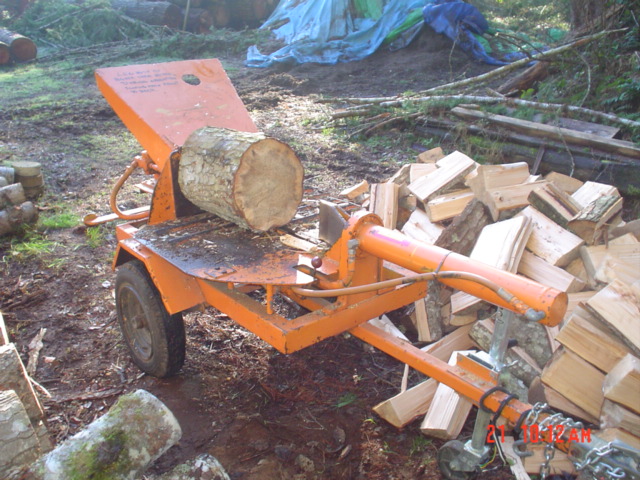

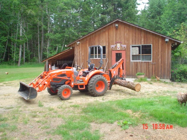

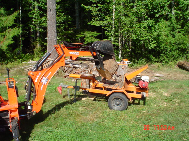

Got my gas splitter before I got my CK35 so have not looked into a 3 pt one. I did get a backhoe with my CK35 as my splitter has a "table" to put the rounds on, I just can't lift the big rounds anymore. By having a separate splitter it does leave the tractor available for other uses.
I know this is not the answer to your original question but this may give you other ideas.
