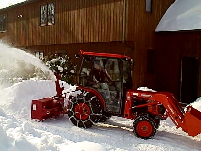

Yes, the BX will plow snow. How well depends on your perspective. When compared to a riding lawn mower with a 3' blade, the BX will do amazing things. When compared to a 60hp, 6000 lb, tractor with loaded tires and chains, the BX is rather disappointing.
In my experience the BX will really shine when it can use all 23hp. Since it just isn't heavy enough to transmit the power to the ground, especially on slippery surfaces, I bought a rear snow blower. Being on the back has it's disadvantages, but it balances the weight nicely and allows the loader to stay on the front for removing slush or ice.
The picture below is from last year. The snow was ~18" deep, my wife is driving. The only thing different for this year was the addition of tire chains to help with traction on ice.
On Sunday I used the blower to remove some snow drifts that were 100' long and 2' deep. It cut a path 52" wide in one pass, no stopping and no ramming. It created no banks and left no piles. I'll never go back to plow...

bellweather - I bought a Hardy Lynx. It's a 52" cut, 25" height, 21" fan diameter. It has a very simple design, but seems pretty durable. This is the 3rd winter and I'm still very happy with it. A couple of modifications I made are some shoes to keep it from digging into soft ground and I put a turn-buckle on the chute deflector to provide more adjustment.
I had looked at Bradco, FarmKing, Buhler, Meteor, and Kubota brand blowers. Prices ranged from $2000 to $2500, after shipping. I went with the Hardy because my local equipment dealer carries them, making it the most convenient.

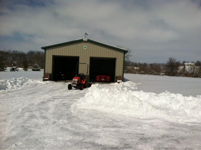

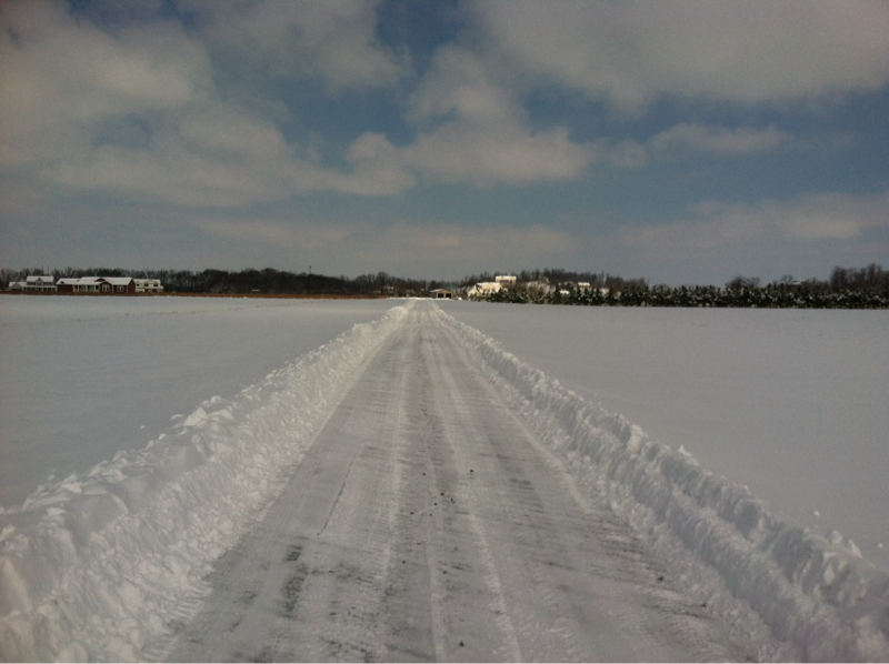

I don't have a blower, just the fel and 5 foot blade as mentioned earlier. A blower would have been good for this round. Too heavy for the blade to do much good. 9 inches started off quite heavy and wet, but then packed in by 35 mph winds over night. This took me about 3 hours.

I missed the storm on Thursday, I was in Miami. Normally my ATV and snowblower work just fine, but 10" of snow and 40MPH winds made me pull out my bx to move the frozen drifts. Chains would have been real handy, the blizzard started out as rain, so it is ice underneath
