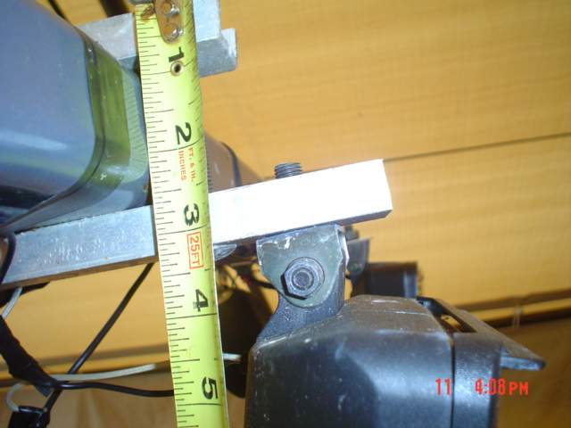

Hello All,
I took the plunge and will be picking up my CK 30 with FEL, backhoe, and "york" rake next week. I am planning on putting some extra lighting on the ROP bar.
I don't want to drill into the bar, so I am trying to find out the dimensions of the bar at the horizontal section above the seat. (width and height)
Thanks in advance for your help and epertise.
Marc

Are you asking qhat size square U-bolts are needed to fit around it ?
I don't know, I'm just trying to help clarify your question.
I found it convenient to use square U-bolts to mount 5ft lengths of punched hole angle, then mounted everything to that.
You can go wider if you like, but 6ft would REALLY start hitting things around here.
/ Width of ROP?
Reg,
You hit it right on the head.
I have the angle iron and lights, I'm trying to find the correct size "square" u-bolts.
Thanks
Marc

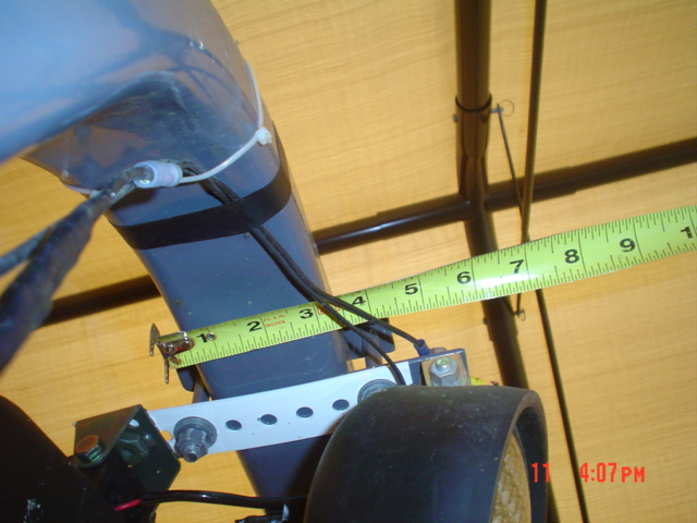

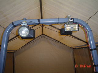

/ Width of ROP? #5
These are pics of the lights on my 2008 CK35. The ROPS is 2" X 3"
I put the bolts at about 4 spacing for clamping.
Hope this helps. :)

/ Width of ROP?
Mr. Mouse,
Thank you for the pictures. Those are the dimensions I was looking for. I will be adding lights in a similar fashion, but using square u-bots to fasten the mounting beams.

/ Width of ROP? #8
Reg, I am 6 ft 2 inches. There is lots of room, not a problem ever hitting my head.
With the lights underneath the ROPS I can go into my portable garage without lowering the ROPS. Plus if I go into the trees they won’t get damage or knocked off. :)
