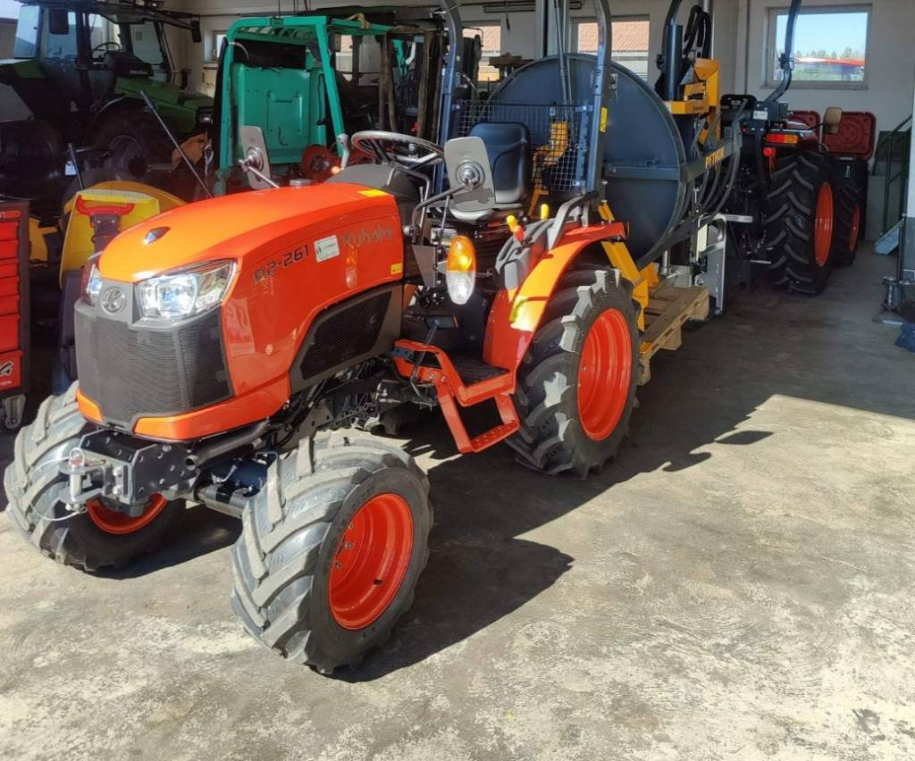

I just found this picture on FB from a dealer in Germany.
There are wider tires available for the compacts. For me it's a puzzle why pretty much all the manufacturers put those ugly cutting wheel on on the North American market.
And I bet wider tires will not void any warranty.

To add wider tires to your machine might mean getting new rims and wheel spacers.

I added wider AG tires without changing rims.
Depends on how much wider you are going.
Rims have recently increased in price because of surging steel prices, but used rims are plentiful

Are you referring to the R1 Radial tires? Yeah, most importers actually set up the tractors with those tires as standard. Even on the 25 HP tractors, however, it's usually only the rears probably due to the lack of availability of that size of radial tires.
Another advantage of the R1 Radials is that usually comes with front width adjustable rims instead of only the rear ones.
Honestly, had the US adopted the R1 Radials on smaller tractors before the R4's and I'm pretty confident that they wouldn't care about the R4's at all. Turfs, on the other hand, are still good for those tractors that spend like over 90% of the time on lawns.
