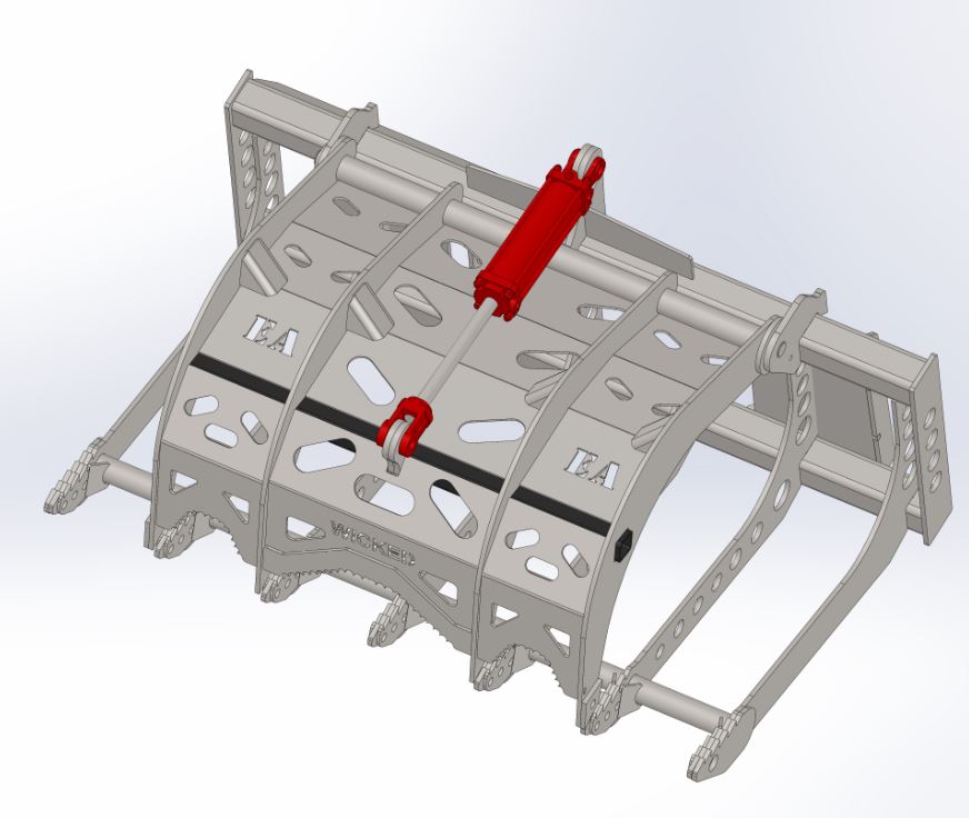

Maybe wider but given that at 10" or so with a 60" jaw opening, it likely has only two tines and they'd have to be pretty strong. Maybe 1/2". Plus the lid and mount. Pretty heavy. Interesting design exercise for an engineering student.

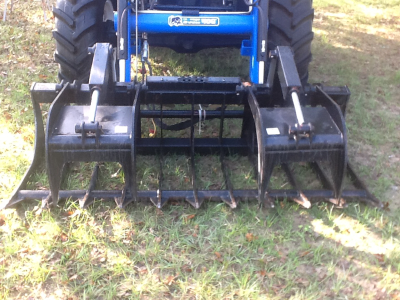

My 84" BD Grapple is about HD as they come but I did manage to bend one lid when I picked up a very heavy dead tree. Top of the tree broke right under the lid and the uplift force of the overhung load was against the outside end of the lid. Grapple still functions well, just looks a bit strange.
You can see that the right side of right lid is bent upwards an inch or two.

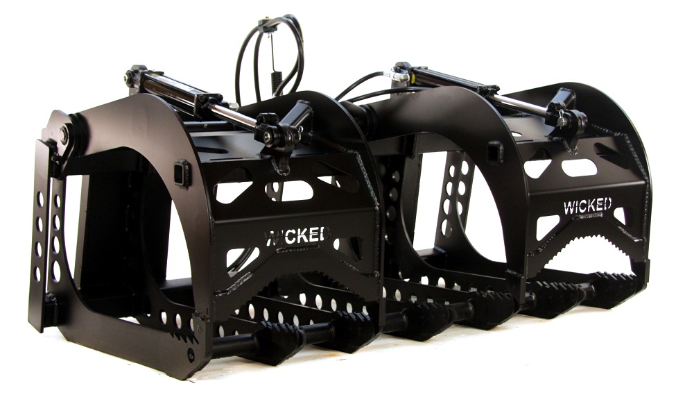

As promised. Side by Side. 50" Small Compact Wicked 54" Compact Wicked 55" Utility Wicked <img src="http://www.tractorbynet.com/forums/files/attachments/449779-wicked-utility-grapple-20151208_125150s-jpg"/> <img src="http://www.tractorbynet.com/forums/files/attachments/449780-wicked-utility-grapple-20151208_125051s-jpg"/> <img src="http://www.tractorbynet.com/forums/files/attachments/449781-wicked-utility-grapple-20151208_125200s-jpg"/> <img src="http://www.tractorbynet.com/forums/files/attachments/449782-wicked-utility-grapple-20151208_125102s-jpg"/> <img src="http://www.tractorbynet.com/forums/files/attachments/449783-wicked-utility-grapple-20151208_125135s-jpg"/>
