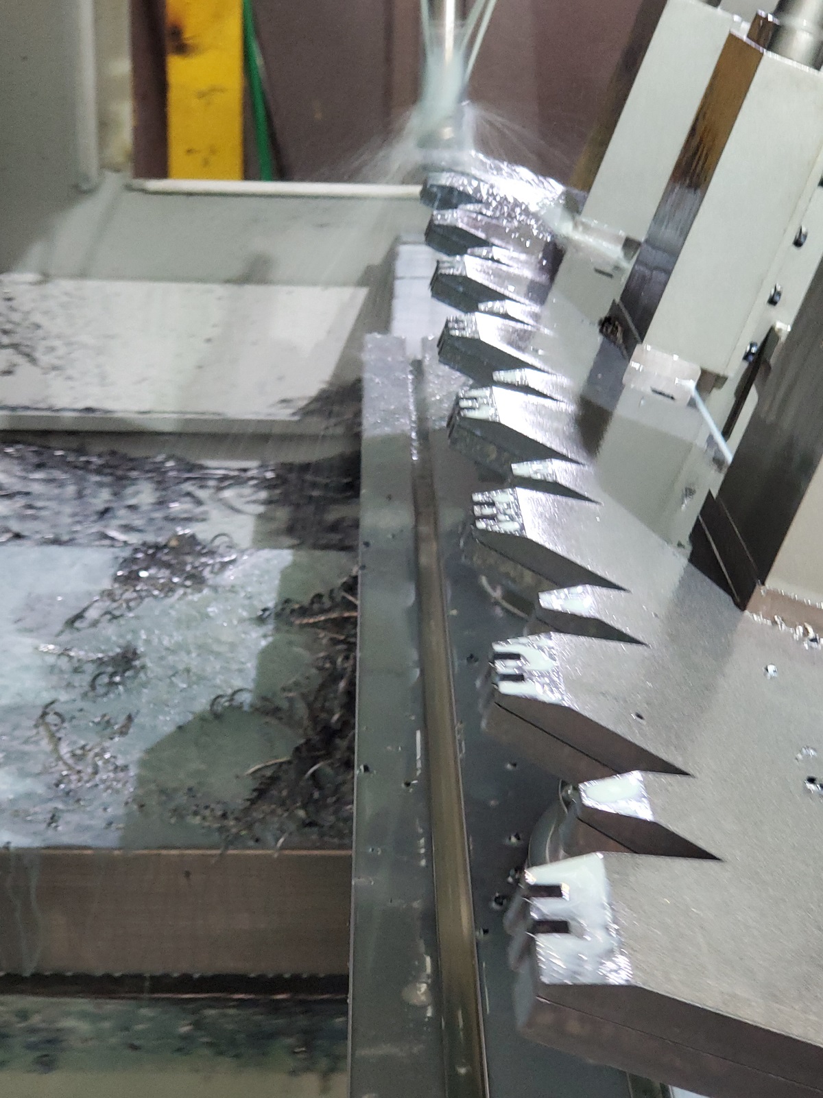

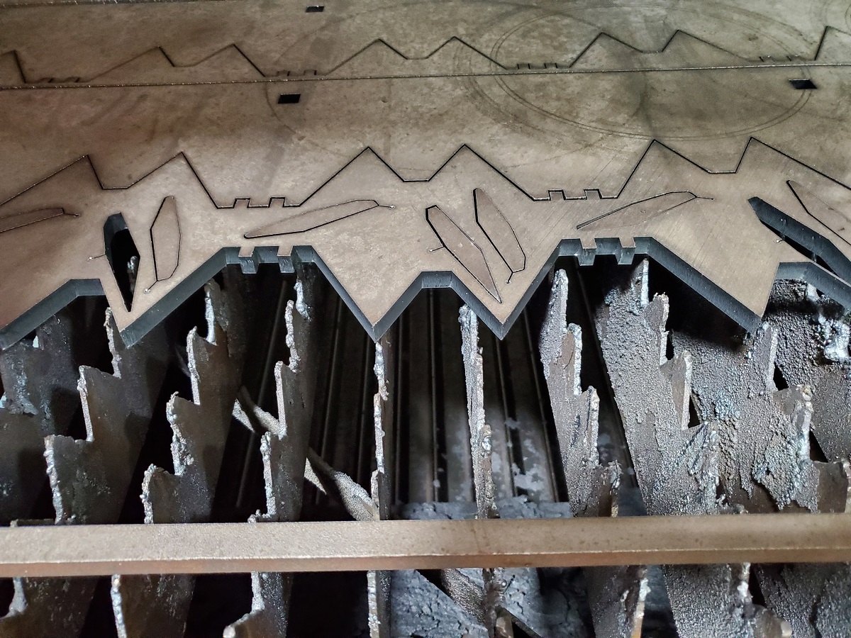

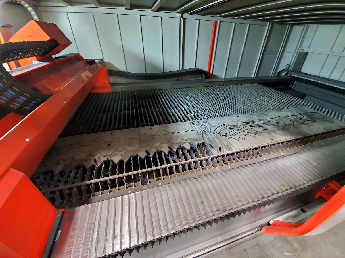

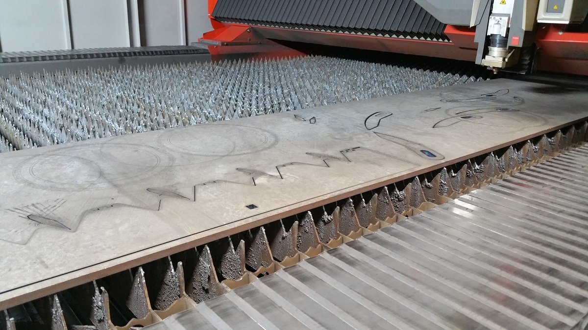

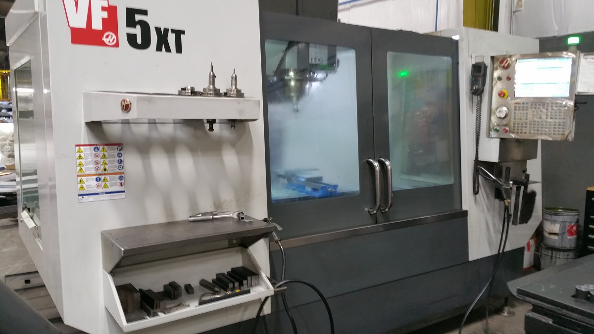

Do you have 3-axis capability on your laser so you can cut the aggressive angle and eliminate the milling operation?
/ Wicked TOOTH BAR for Tractor Buckets!!!!
#30
Our lasers only cut straight down. Having a multi axis may have its advantages, but, according to Ted, it still wouldn't allow us to cut a bevel as aggressive as what the mill is doing.
Travis

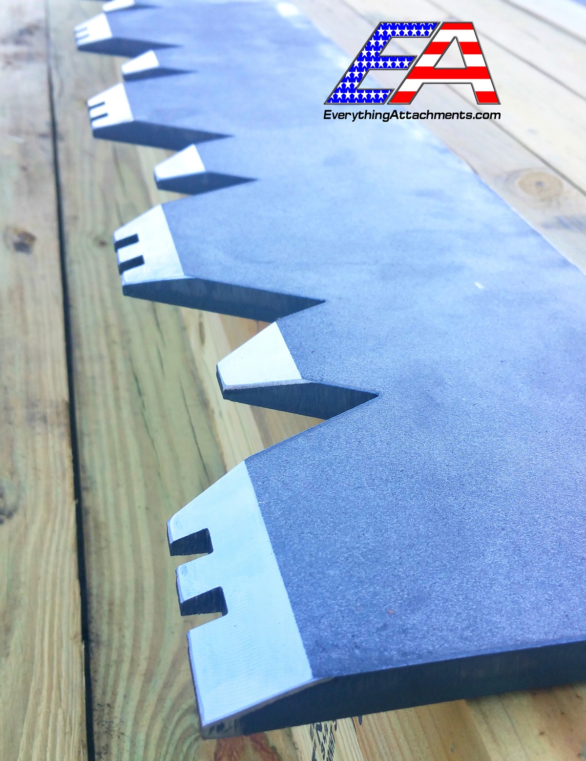

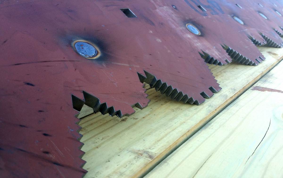

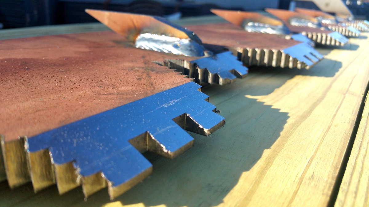

#31
Some laser problems delayed the delivery of the first dozen or so we sold, but they'll start shipping TODAY!
The delay, although frustrating, actually gave us more time for testing and development, which resulted in Version 2 and the current, VERY mean V3.
It is truly worthy of being called WICKED. The sharp saw teeth design is game changing, and it separates us from any other toothbar on the market.
Travis
Tabs for the bucket keepers are laser cut and precise, so they're all uniform with no room for error. In addition to welding them on top, we plug weld from the bottom for maximum durability.
/ Wicked TOOTH BAR for Tractor Buckets!!!! #32
looks like some kind of midevil weaponry.
could you add a bar to the bottom and make it a sickle bar mower? ha.
#33
It appears as such! :laughing:
Pictures really can't do it justice. Those teeth are sharp and, being AR450 Steel, it'll stay that way!!
Travis
/ Wicked TOOTH BAR for Tractor Buckets!!!! #34
Will be interesting to start reading reviews on this bar from those who have the other style bar like I do and then switched to this one and get real comparisons.
/ Wicked TOOTH BAR for Tractor Buckets!!!! #35
The serrations on the sides of the teeth will be effective when curling the bucket full downwards and catching vines. I ripped out several trailer loads off of several oaks. The Piranha did very well.
Also, when uprooting hedge-rose this would be pretty effective as well.
Sold the Piranha bar but may have to consider this in the future. Thinking that getting under the Johnson grass may rip up the root system and reduce having to use herbicide.
Suspect this one would up the game considerably. :thumbsup:

Yeah, man. I agree with everything you said. The bevel is aggressive and the sharp saw teeth will grip and rip like mad.
