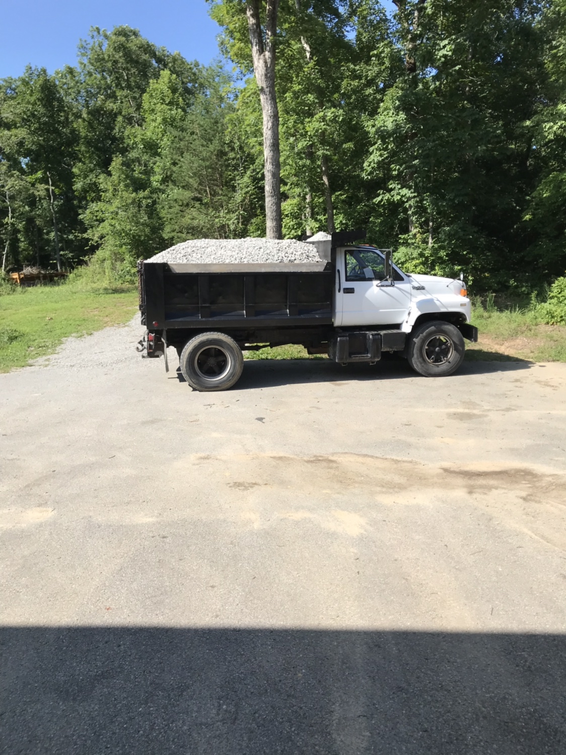

Exactly. Load the curb weight barley 1 ton car like this and let us know how it turns out. Considering that load ( just the load ) weighs 8.3 times more than the Miata I don’t think it’s going to turn out good. View attachment 638804
The REAL question is why are truck differentials SO SMALL. Think about it. They are very small compared to the weights and loads they are required to handle compared to cars. If you add up the weight of the car and its approved load and the weight of that dump truck and its approved load, you will be asking why is the differential in that dump truck so small.

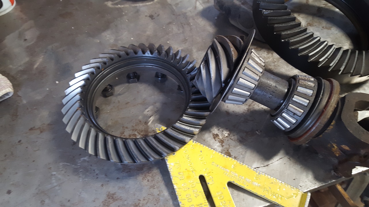

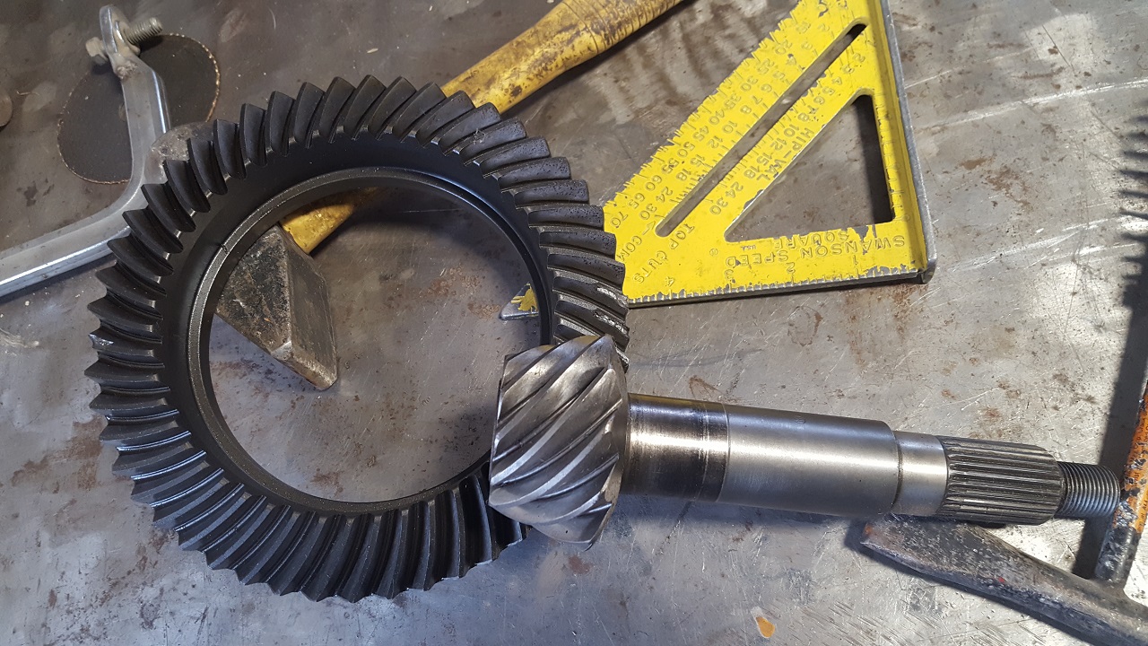

I dug around in my shop and could only come up with two ring/pinion sets. Sorry. This would have been a great thread to display 3 or 4 different sizes.
First is from a Dana 44 differential. It's a common size in 1/2T equipment and actually some autos. This set is 4.56 ratio. The larger the number, the slower the gear ratio. The larger the number, the smaller (less teeth) the pinion gear has and more teeth the ring gear has.
This set failed. They came out of one of my offroad buggies. I'll let you guys see if you can spot the failure.
I laid the T square in the pic to give an idea of size.

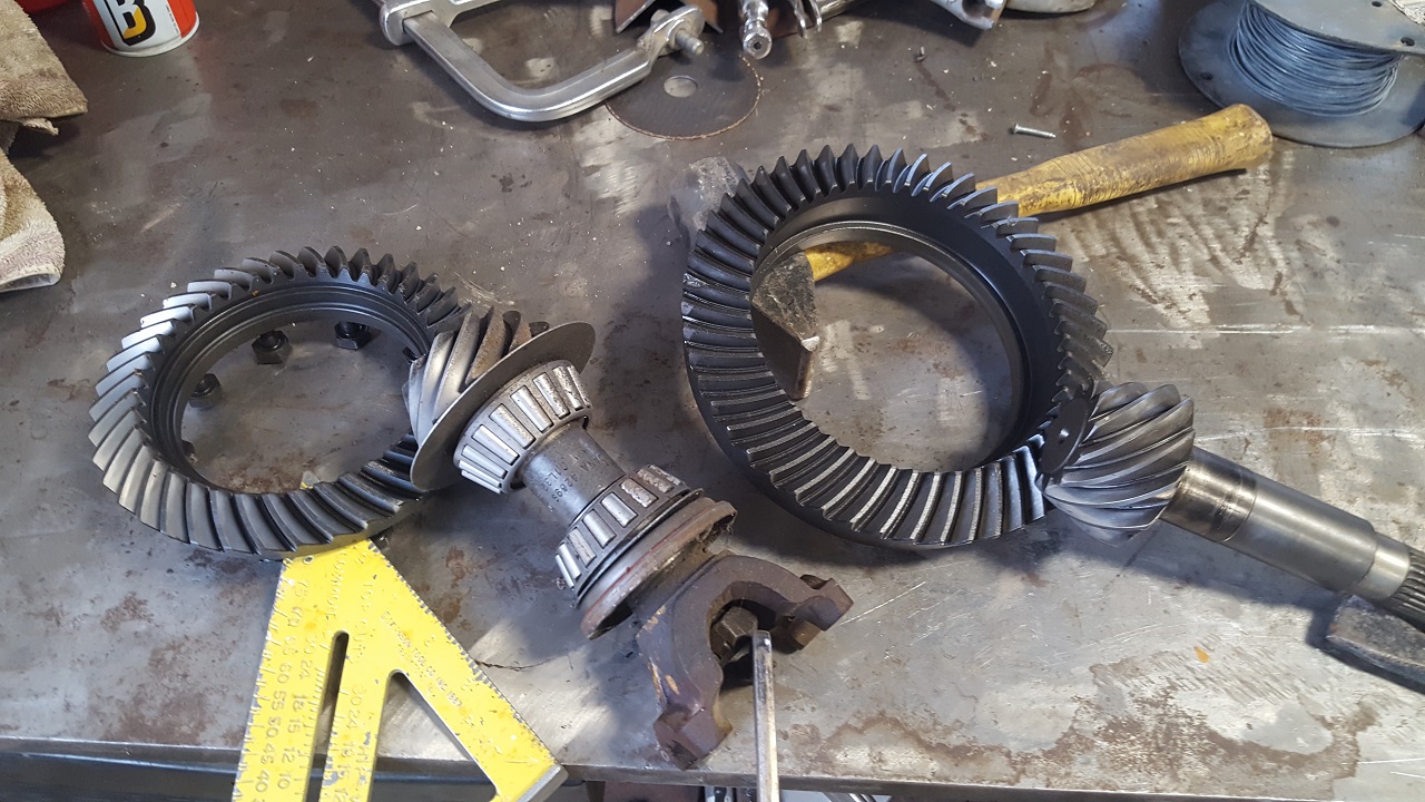

Second is a Dana 30 set. It's commonly found in the front axle of Jeeps and other compact trucks. This set is 3.55 ratio. Notice larger pinion count compared to ring count.
This set was replaced to get a lower ratio, slower vehicle speed, more pulling power.
Here's a comparable pic with both sets. Notice how much larger the 44 is over the 30.
My Son's run Dana 60 axles. Their ring/pinions sets are gigantic compared to these sets. Dana 60 size is what's common in 3/4T or 1T trucks.
Over the road trucks have ring/pinion sets that would make these look tiny.
Hope this helps explain the differences in strength that larger axles have. Wish I had gears from one of the vehicles you listed to show how tiny they are. :)
I see busted teeth all over that ring. Right above the pinion gear and then one directly across from it.

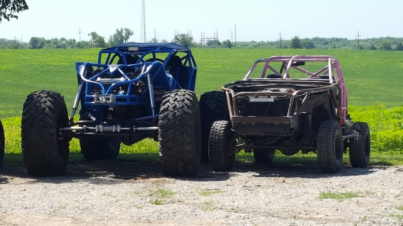

In my modified world here's an example of tire diameter differences. The more stress applied to the differential, the bigger and stronger the differential needs to be.
The larger buggy is on 48" tires and Dana 60 axles. The smaller is on 33" tires and Dana 30 front, Dana 44 rear.
And for those of us who know trucks that really shows perspective!! Esp since my k10 is sitting on 33s I know exactly how big those are!!

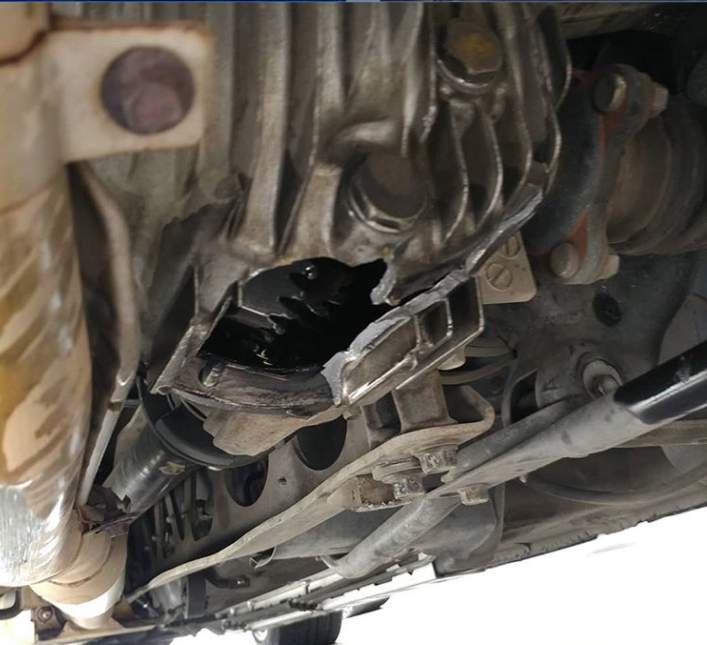

My kid's Miata diff with a hundred enraged squirrels under the hood. :shocked: Screenshot 2020-01-26 at 5.38.58 PM.png
I don't think it would last as long under the RAM with diesel power.
