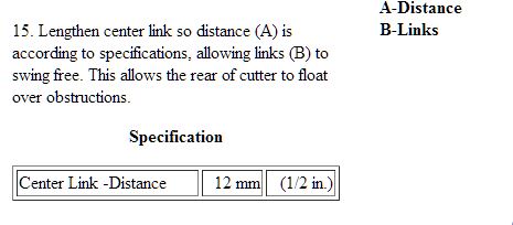

This was snipped from the operators manual you posted.
/ Why doesn't my MX6 suck? #33
Here is the rest of it.

I think we are both right.
http://manuals.deere.com/omview/OMW49246_19/
Manual says to take all the slack out of the linkage but use the rear wheel to support the rear of the mower. I might need to adjust my rear wheel some.
D.
