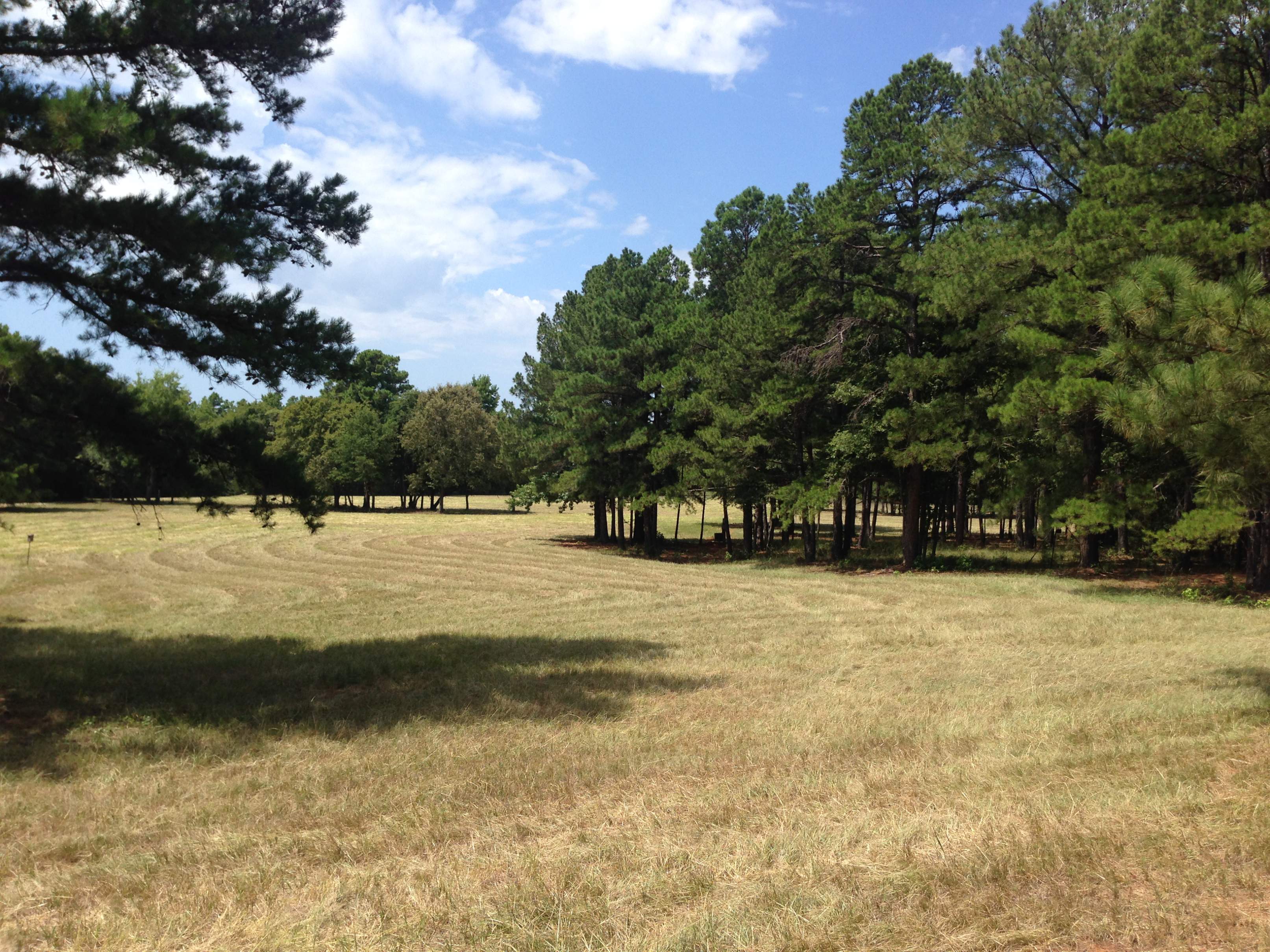

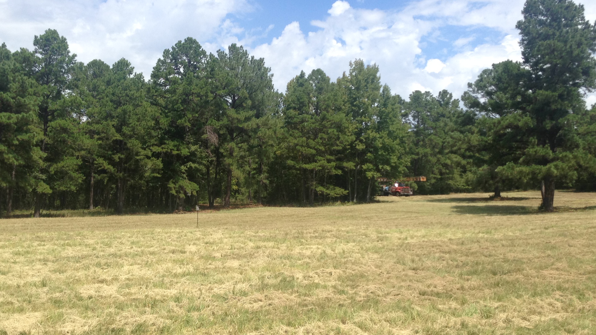

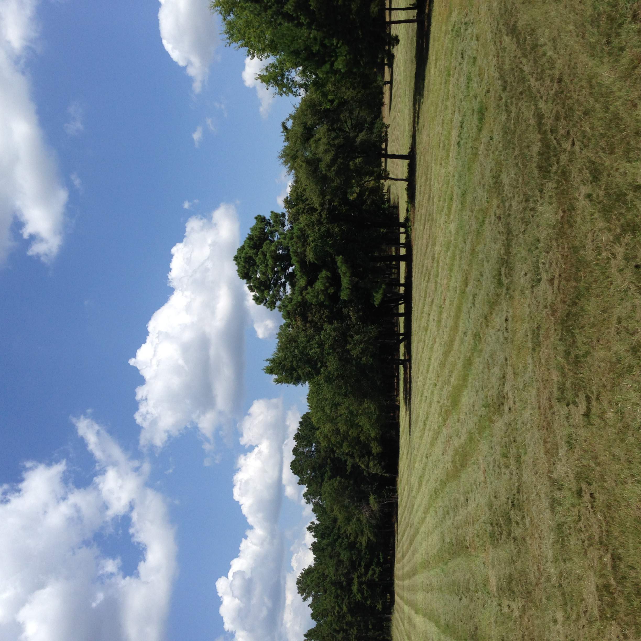

And yeah... my pasture ain't looking that symmetric when I'm done. It doesn't look horrible, but it's noticeable that there's grass that wasn't cut.
Here are a few pics of mine from Sunday. You can see that it looks pretty nice from a distance, but when you zoom in on the pics, you can see it isn't the smoothest cut.

Is the mower level?
Blades bent?
I would try a new set of blades and make sure it is level.

I really don't think they are bent, but they sure could be. I bought some new blades at the beginning of spring, but never put them on. I decided to just sharpen the existing blades instead. I should probably give that a try before I do another round of cutting.
The mower is definitely level, I did check that.
The only thing I could think of that would be causing this - before your good suggestions here - is that I was running the mower too high? But I wouldn't think that would but an issue. Who knows... maybe it is?

Are you running the front of the mower an inch or so lower than the rear?
/ Why doesn't my MX6 suck?
I don't think I am. I'm pretty sure it's very close to being the same height front / rear. Should I be running it lower in front?
/ Why doesn't my MX6 suck? #9
Yes, I don't recall the exact difference that the op manual says, but I like to run an inch or so difference. Your pasture doesn't look too bad, so I think you are close, a little drop in the front might get you where you need to be.
EDIT: I just looked in the manual, and I couldn't find anything on the front being lower. I think that having the front a little lower is just a general rule with a rotary cutter.

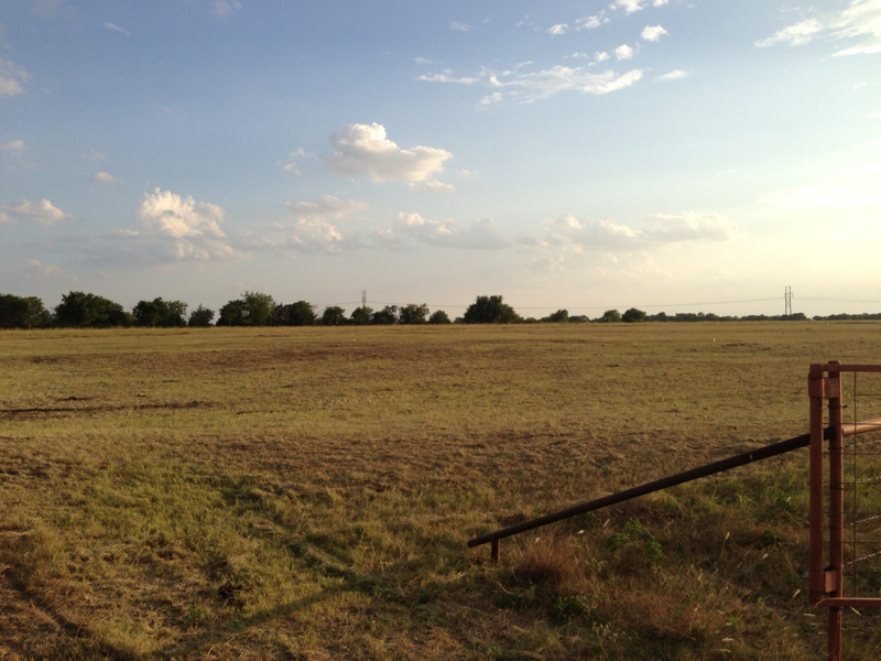

I have really been thinking about that lately, too. This is only about 50% of the grass I am cutting 3-4x per year right now in these pictures. It takes about two full days on the tractor to get it done with the MX6.
I would really love a pull-type cutter like the MX10. I think dual spindles would be a lot more efficient.
The only downside with the MX10 is that I can't trailer it all as easy to cut some of the pastures I have to drive the set-up to 1-2x per year.
Thus, the MX8 has been a little more on my radar than the MX10.

You need to tighten up your 3rd link. Take ALL the slack of those braces.
Looks like you moved the tail wheel down some. Which would make it cut higher. I pretty much dont use the tailwheel much. The manual said something about the height should be where the deck skids are off the ground and the wheel is not touching.
I would put the new blades on it.
Tighten up the 3rd link.
Go from there.
D.
#16
So the idea here is for ALL of the weight of the cutter to be on the 3-point? I have been purposefully leaving slack in the top link so the wheel is almost always on the ground thinking it would deliver a more even cut through the ups and downs. But that's not really how I should be operating her?

Have you tried mowing in the opposite direction than you previously mowed? The direction you mow verses the direction the blades turn gives the blades an opportunity to lift the mashed down grass.
/ Why doesn't my MX6 suck? #20
it may just be a condition with the height of the material, trying to take it from
2-3' down to 6-8" in 1 pass causes too much material to gather under the mower
preventing a good "suck" of all the grass.
I'd be interested to know if it does the same thing if you were to cut from 12-18 inches
down to 6-8 inches....
