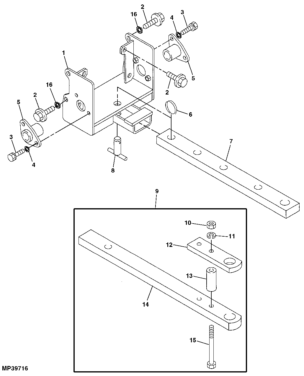

I'm guessing from the replies that BIG tractors must have a large range of side-side motion for their drawbar and that you must be able to pin it, set at different angles. Guessing again this might be a left offset-center-right offset positions.
Totally not the case on my JD2320. The drawbar has a side-side ~1/8" of play. Makes no sense to me what this play serves. :confused2:

You don't have a swinging drawbar. Just a drawbar that has a little play, and will shorten or lengthen.
The "play" is just it being loose enough, so when you adjust the length, it will slide and not be tight.
There really IMO is no more "play" than a trailer hitch that has an insert receiver. And yes, it can rattle a bit. :)

ditto that. less than 1/8" of play and if it gets a lil rust or imperceptable bow.. or a couple extra coats of paint over the years and it will be hard to adjust.. etc.

The draw bars are designed for a loose fit, so that they can be adjusted or removed easily. Anytime there is a possibility of the PTO shaft coming close to contacting the draw bar, I remove the draw bar. I would rather remove the draw bar, than buy a new PTO shaft.
