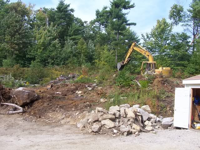

Here is one of my piles, the rocks are much bigger than they look.
All of them pulled by my little backhoe, the excavator in the back is soon to rip up that hill but I will save that story for another thread.

Wow :eek: I think both of your piles of rocks trump mine. How funny is it that there are all these TBN'ers taking pictures of rock piles! Takes a special kind to flourish here doesn't it. :) I have no idea what kind of rocks I was digging up there, but they are all flat (great to build with) and not that dense. Several of them broke in half just tossing them in the FEL. There was only one heavy enough that I couldn't pick it up easily. I need to get a picture of a clean broken edge, very pretty - light grey sparkly. (I'm not a rock hound at all so I have no idea what it is.)

Those rocks appear to be sandstone. The only way to find them in the yard's around here is to purchase them at one of the local rock shoppes. :(
