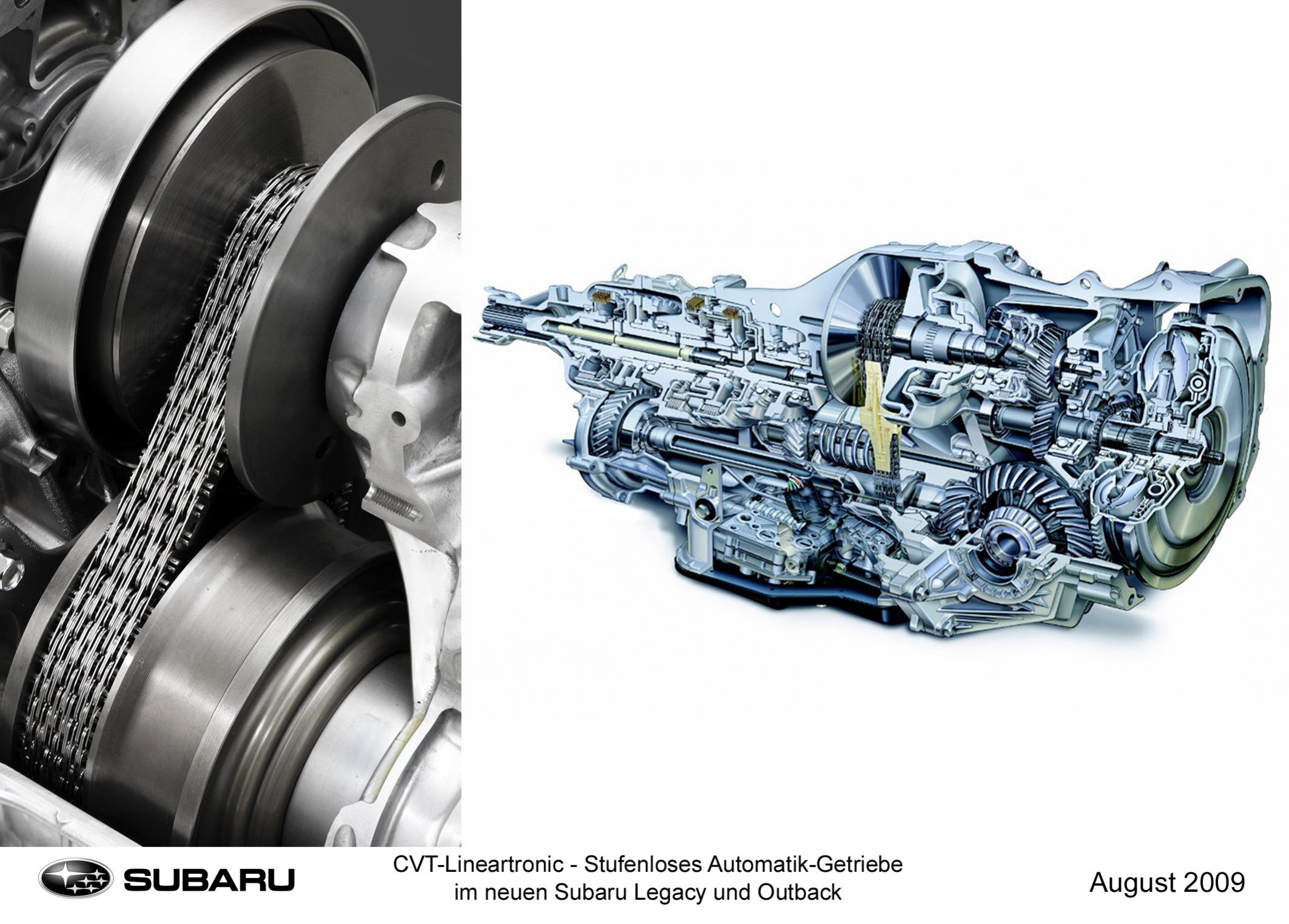

The intuitive CVT continues to prove that it’s one of the best around, and I’m especially fond of the standard shift paddles (a feature missing from our long-term CR-V), but the transmission does hesitate to engage when going from reverse to drive, waiting an annoying second or two to respond to throttle tip-in.
Subaru's CVT is well thought of, with a few quirks. So is its Eyesight system.

I remember when the Subaru Justy came out. It had a steel belt in the transmission and worked like a snow machine. I did a quick search and found this picture. Looks like they still use a belt.
/ Why CVT's are awesome #37
Many transfer cases use a chain also. Amazing the use something so simple.
