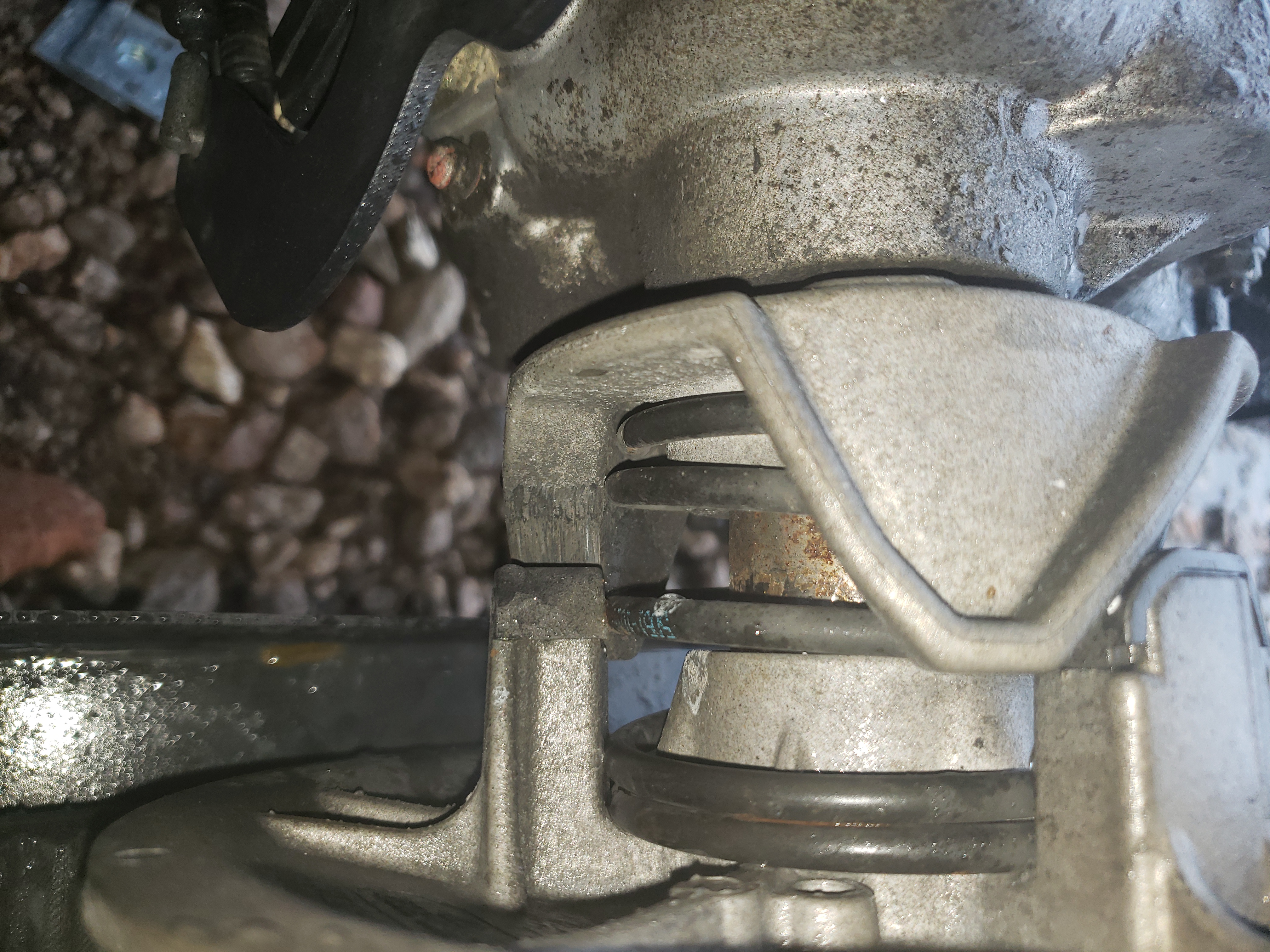

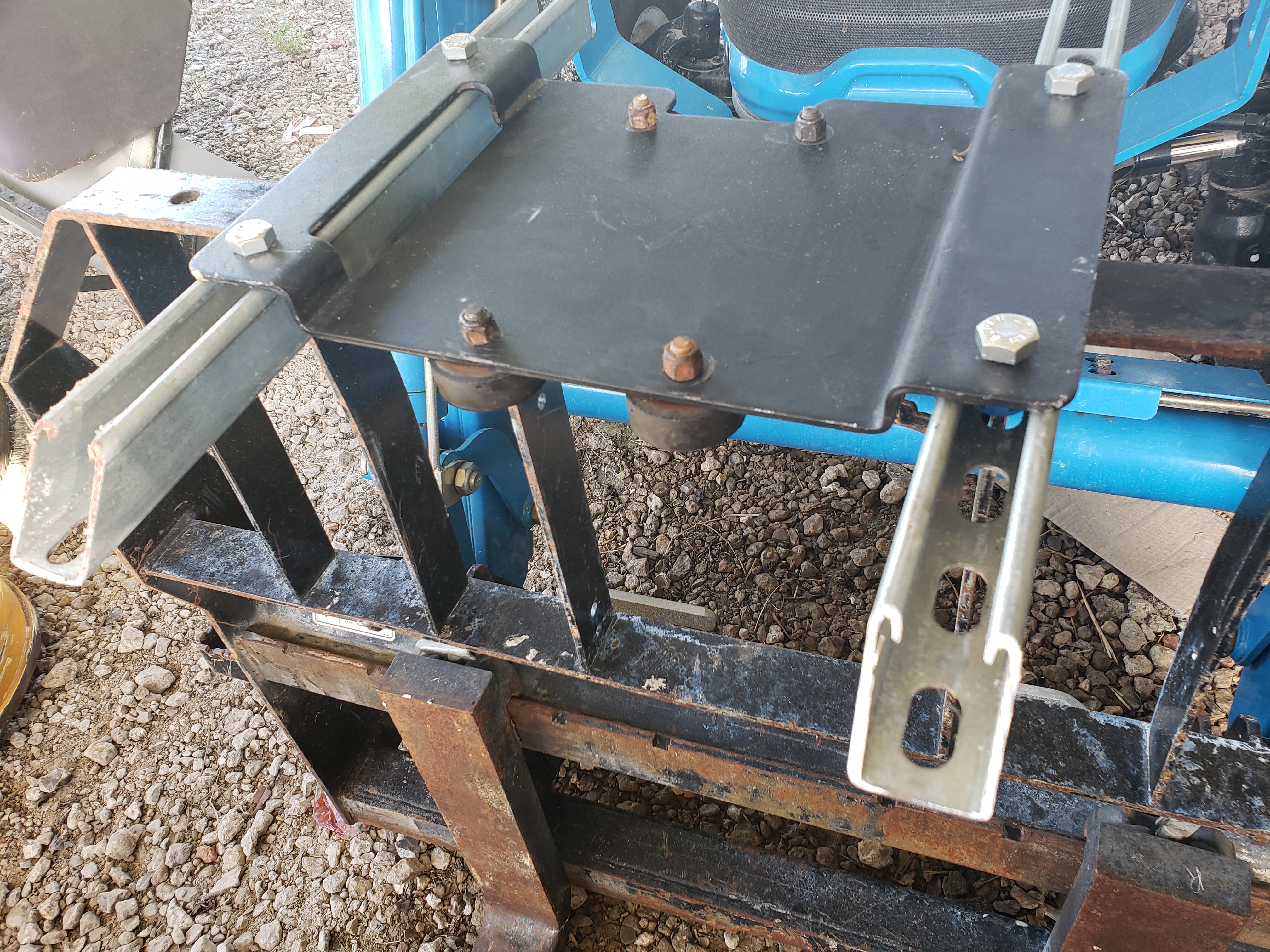

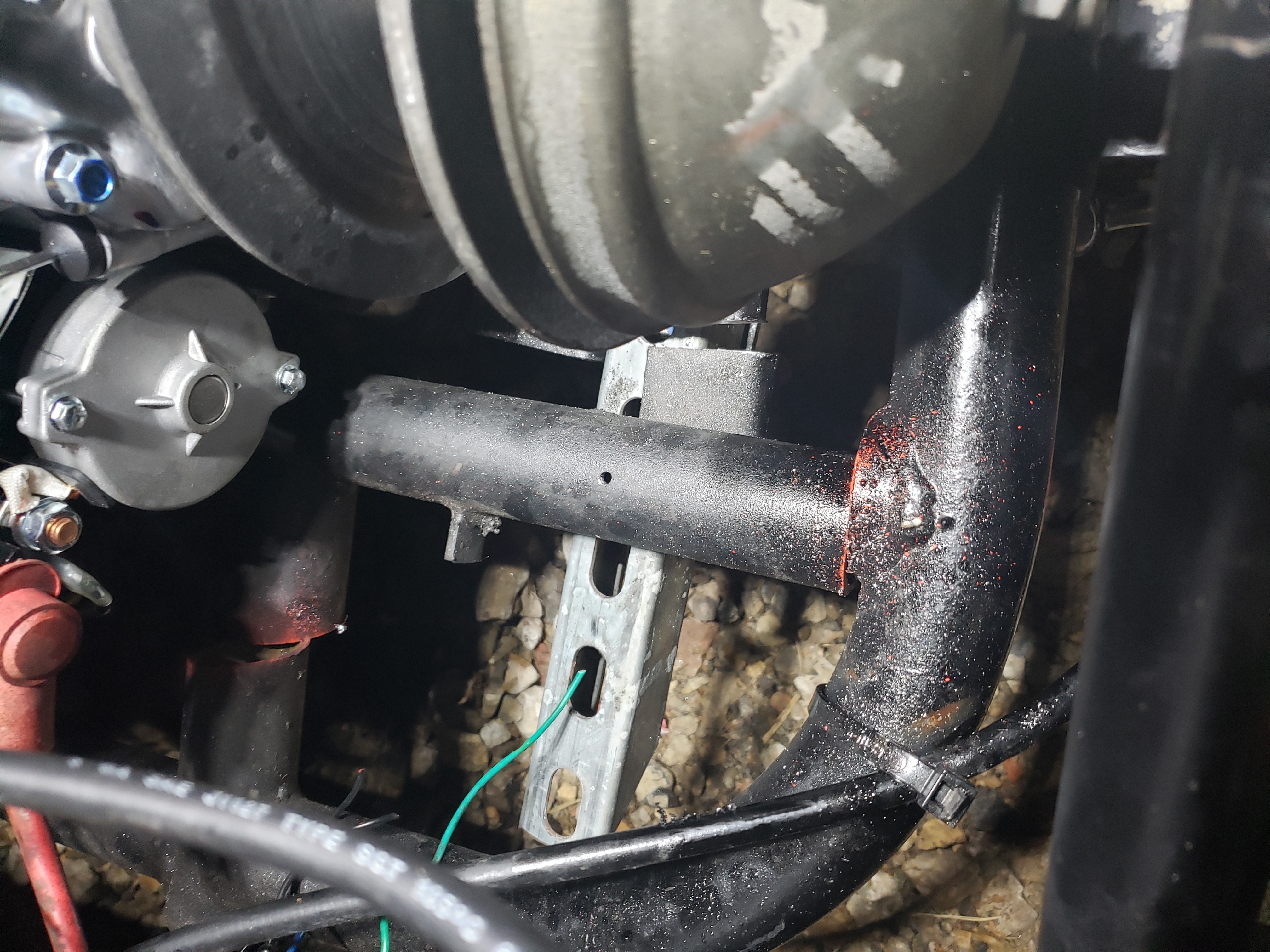

I have purchased a used American Sportworks Bulldog 300 UTV and promptly swapped out the 277cc Kohler engine for a Predator 670cc engine. The previous owner had the engine scooted back pretty far and the belt was very loose, appearing as an oval when the engine was off (this will come in later).
Before doing the swap I researched the other driveline components to ensure they would handle the 250% increase in power. American Sportworks seems to have standardized on a single driveline setup for nearly all their UTVs, so this little "golf cart"-ish putt-putt has the same CVTech series 06 CVT and Dana 265 transaxle as their 700cc LandMaster. Further research indicates that this CVT is used in performance applications up to 60hp and 6500RPM. I say all that to ensure you that I am nowhere near exceeding the capabilities of this CVT.

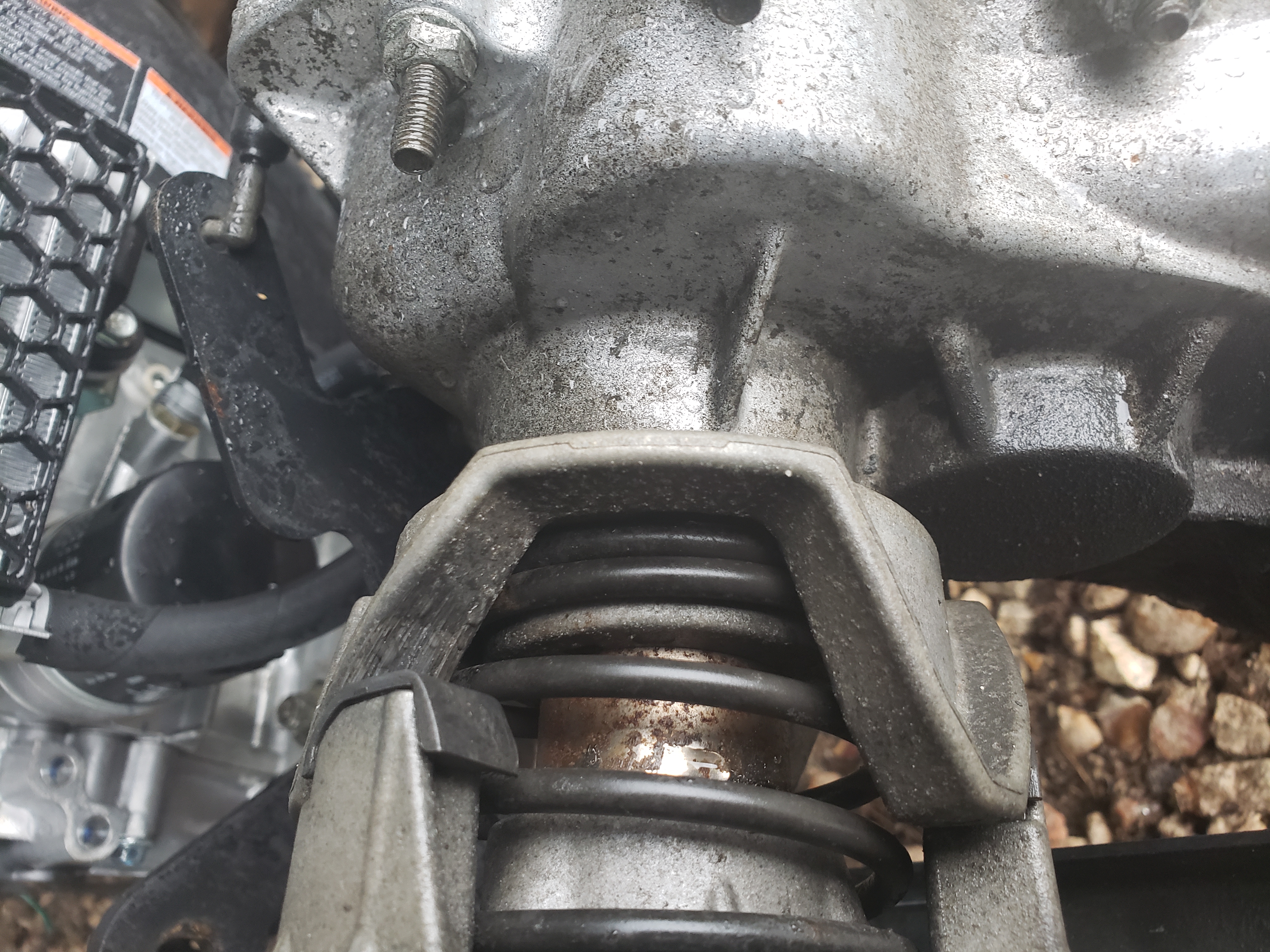

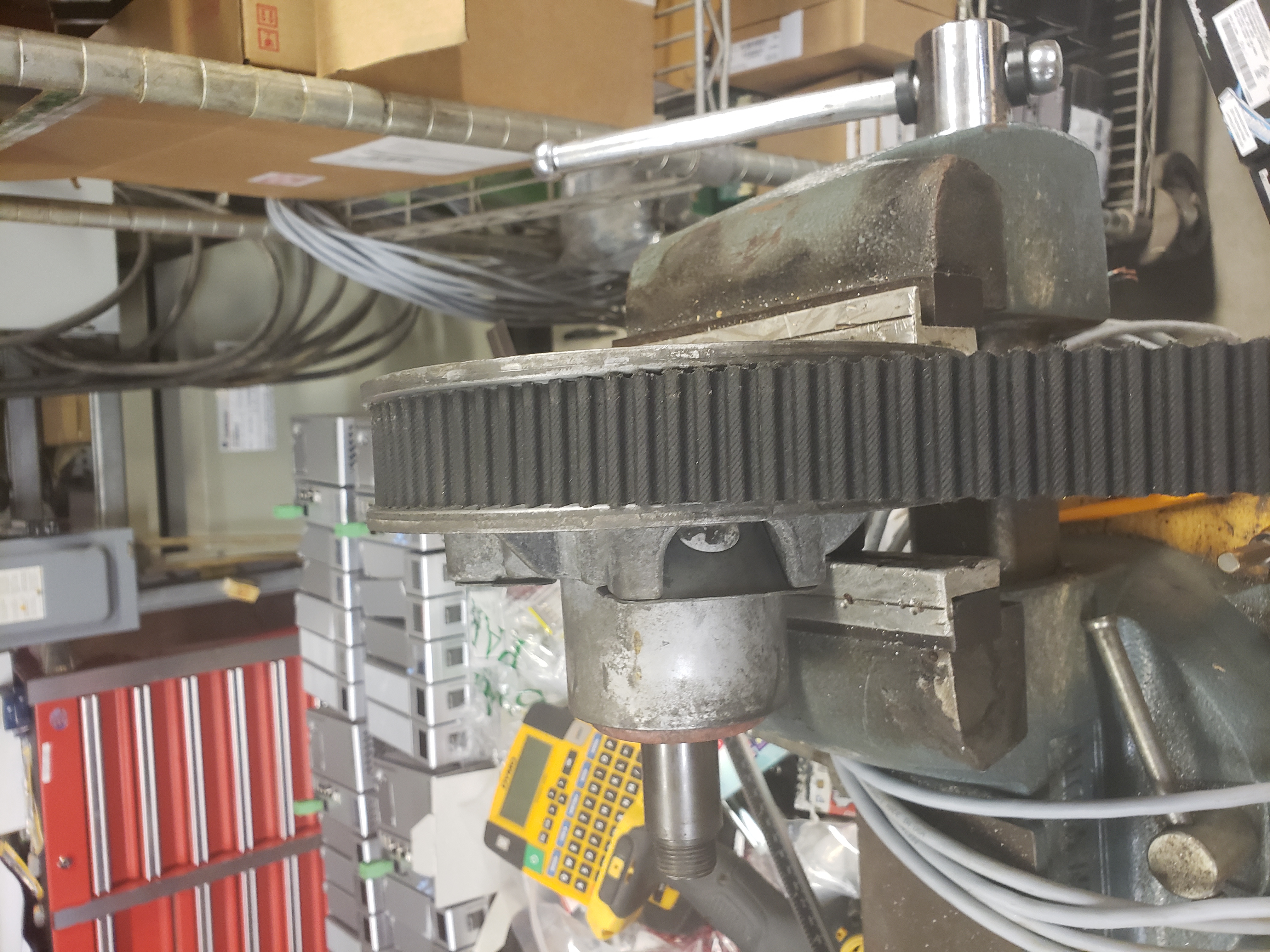

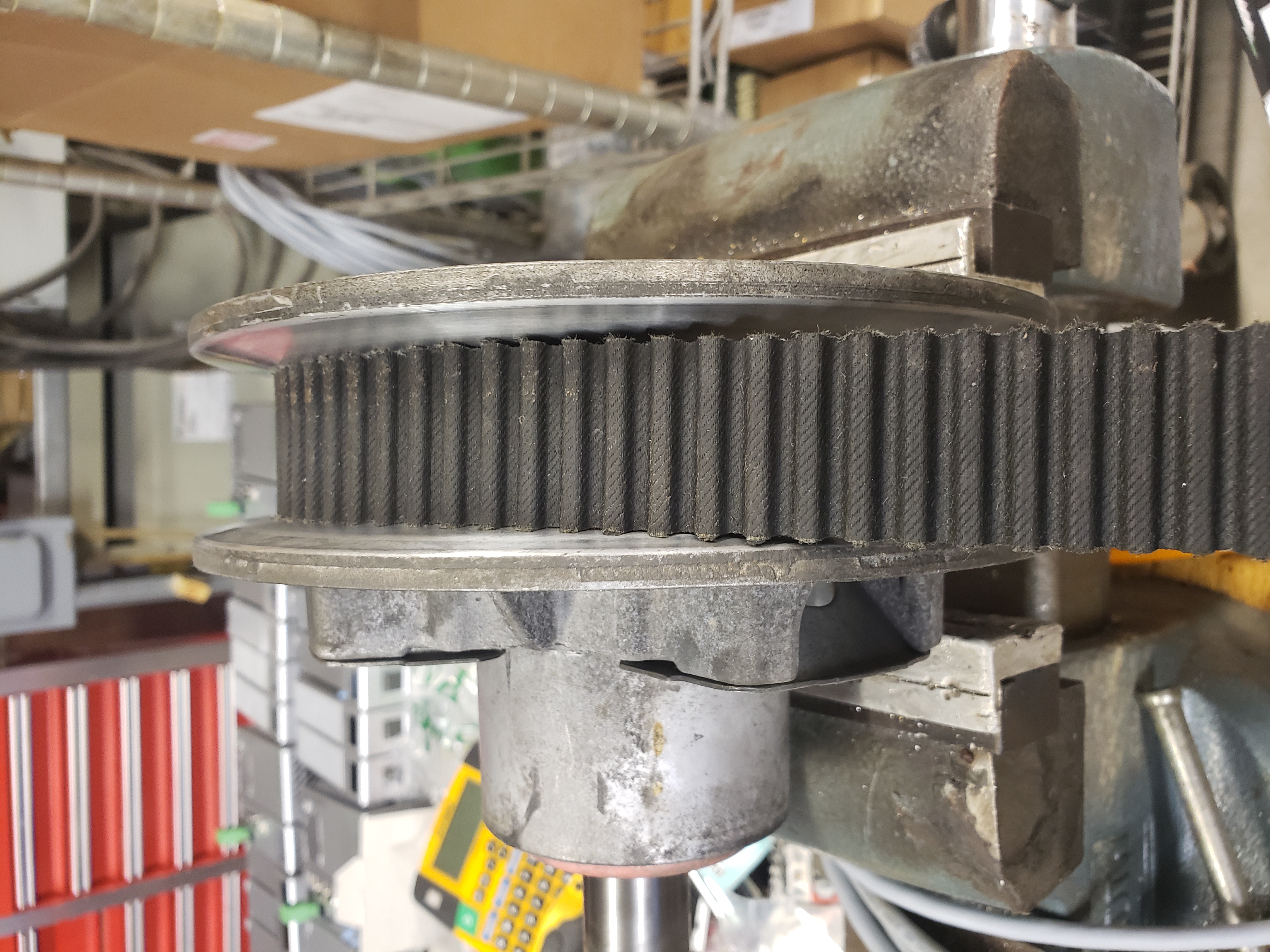

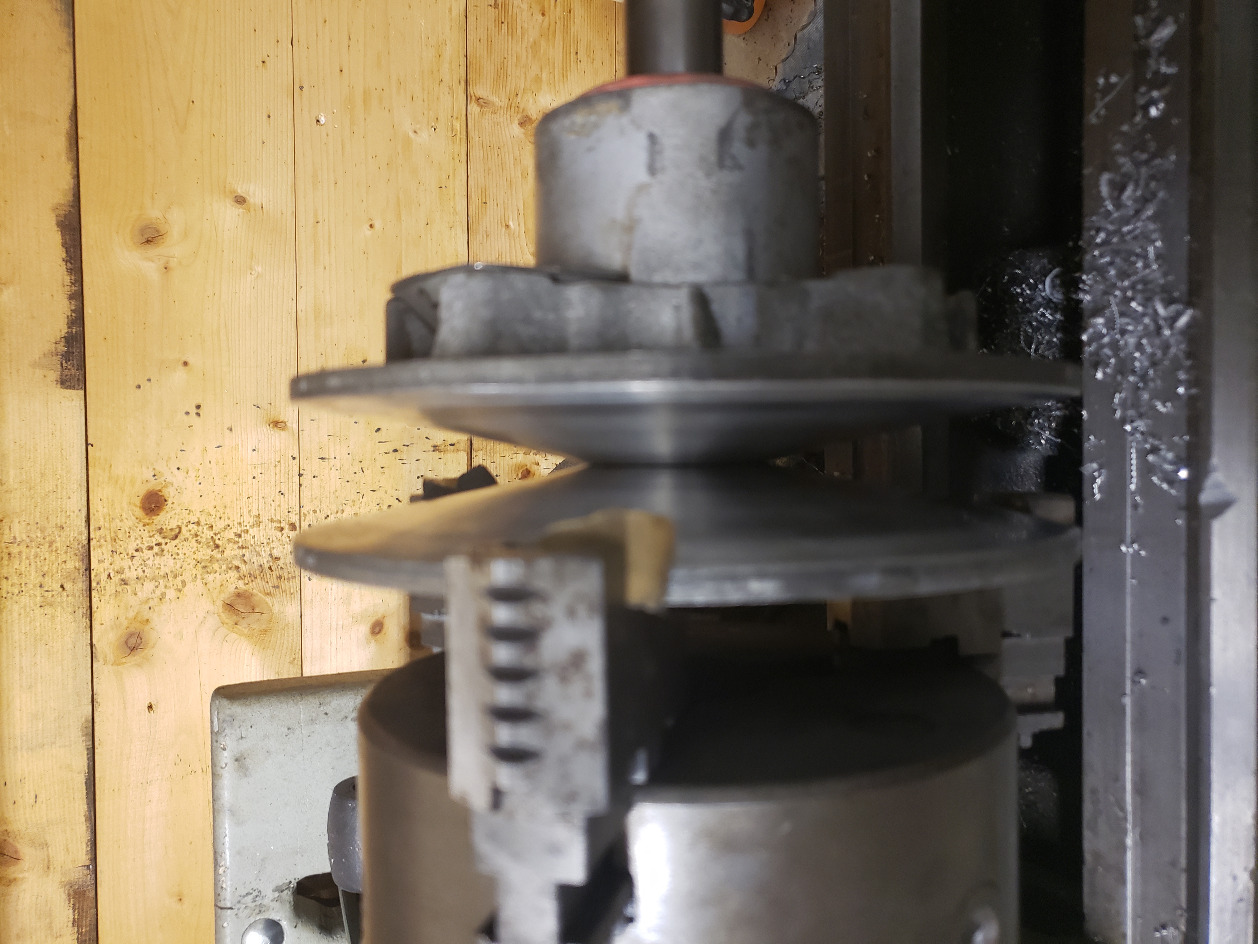

Now the issue, with the old engine it was slow. 17mph max. With the new engine, slightly faster (maybe), haven't clocked it, but still slow. While I drive it down the road, I look back at the CVT and see that the rear pulley is not opening up all the way. You can see in the pictures below just how far it opens up by the surface rust on the shaft and the rubber rub marks on the inclines.
Also, I think maybe the drive pulley is not closing all the way. I don't know exactly how high the belt is supposed to ride on the drive pulley at the highest ratio but I suspect it's all the way at the outer edge, and the polished surface of where the belt rides does not extend that far.
I'm not confident that I fully grasp how a CVT works, so I can't really make a strong educated guess as to the problem. I want to know how to fix my problem but I also have a strong desire to fully understand the workings of this device. Please pardon the following potentially offputting social experiment, but I find that asking questions online generally garners fewer responses than making false statements, so I'm going to act like I know exactly how a CVT works and explain it down to all of you as if you are lowly pupils, and wait for the corrections to come in.

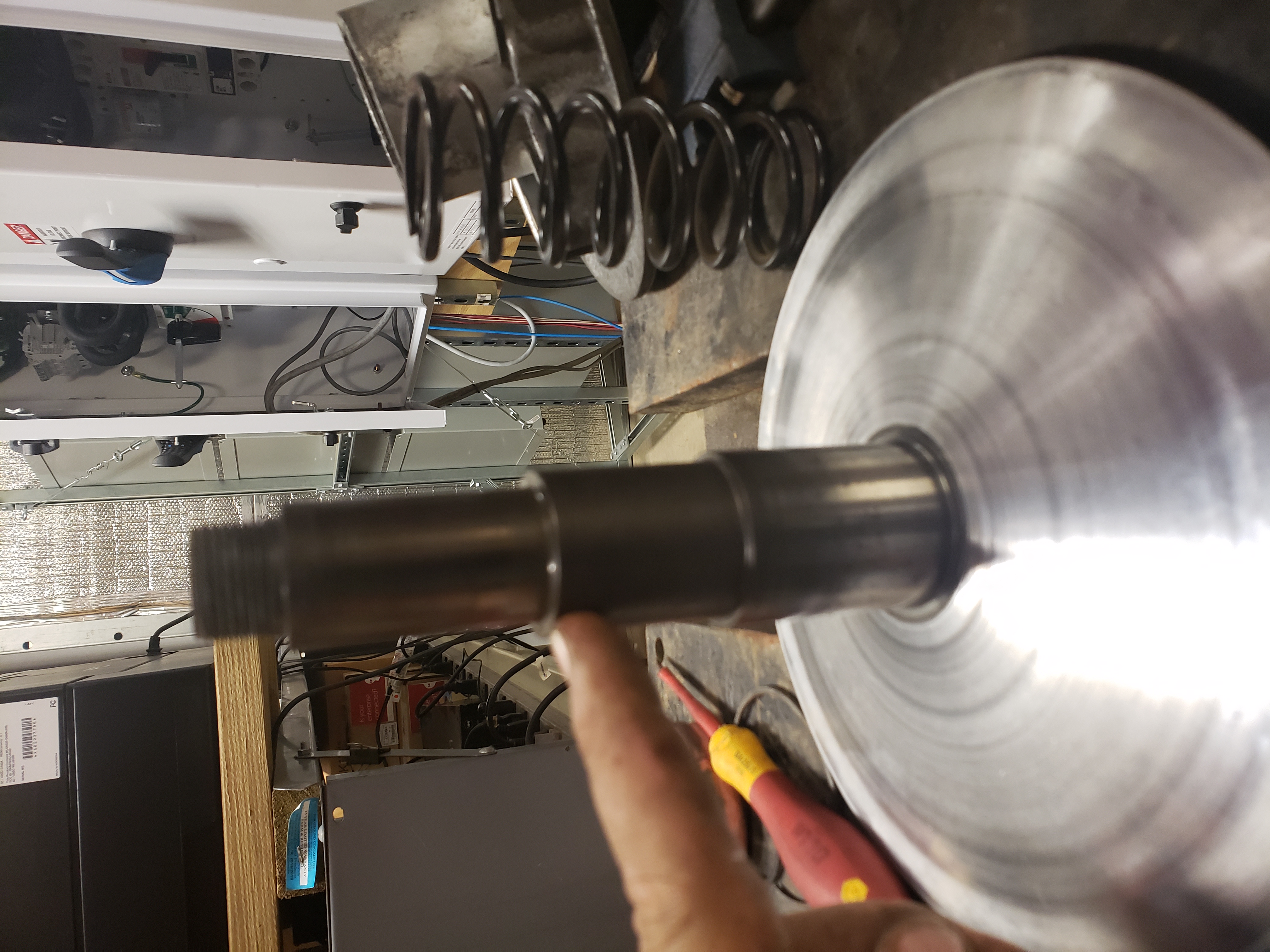

2. [8.C.] The surface rust and dirt in/on/around my driven pulley is inhibiting full range of motion. Previously under-powered engine and too much belt slack [8.A.] caused by improper engine position adjustment by previous owner, resulted in a portion of the driven pulley's range of motion being unused and therefore free to rust & collect dirt. That portion remains unused (unable to be used) now, until it is taken apart, cleaned, and polished.
Corrective actions 100% guaranteed to solve the problem: replace the belt and tear down/clean the driven pulley.
I have a new belt on order and plan to tear down the pulley later and clean it.
