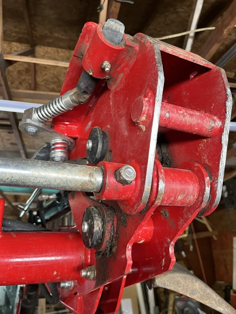

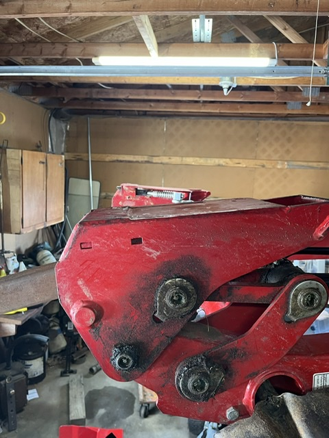

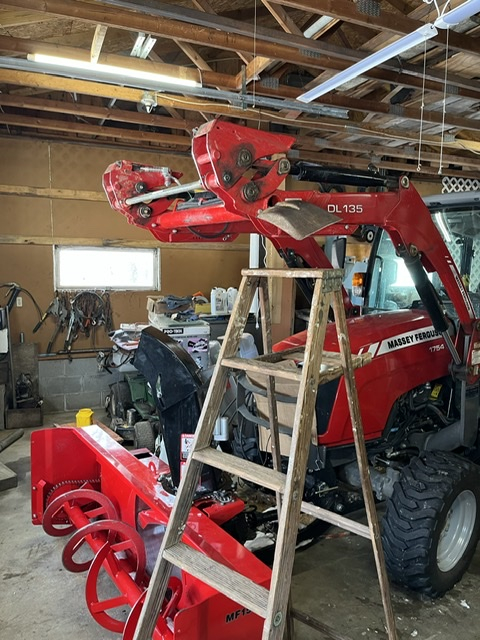

JWR, I'm sure mine works this way. I'll go out and get a few pics of the pivot points. I'll need a ladder, because the front blower is on and I don't remove the loader. I just remove the bucket, raise it up high enough to walk under yet allow the tractor to fit under the upper header on the garage door, then I hydraulic lock the arms in that raised position. The curl hoses are unhooked (they rotate my chute on the blower) so I won't be able to demonstrate any movement.
   / Why are my loader cylinders out of sync? #44
JWR and others:
My humble apologies to JWR for misleading him and any others following this thread.
I DO have a connecting shaft on my SSQA loader. Because the pin bolts are pretty sloppy, it APPEARED that there was no connection.
I will attempt to attach a couple pics showing how far out of plane the arms can get. Not as far out as I had remembered, I guess.

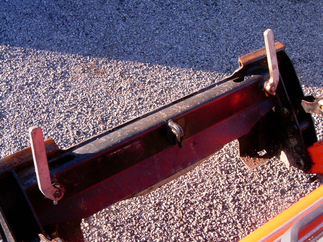

SSQA was an option back 2001 on my Kioti DK.
They were standard equipment on many models by 2005 or 2006.
Picture of the SSQA I got as an option back in 2001
