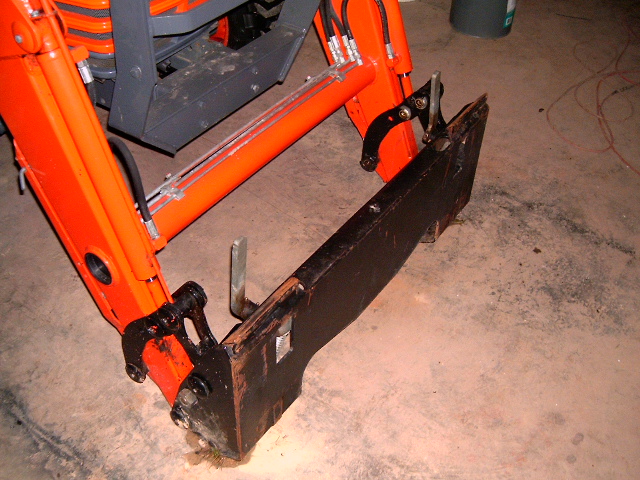

Check it with a straight edge to tell if it's twisted
   / Why are my loader cylinders out of sync? #12
Sounds like the cross member between the lift arms at the quick connect have twisted. It happened to me once when my grapple came loose from one side. I cut the bent tubing out and replaced it with a solid steel bar.

I will go carefully inspect the torque tube ...
   / Why are my loader cylinders out of sync? #14
Some QA torque tubes are made wimpy and twist easy for only 2 reasons, cost and weight. Making them stronger and less like to get twisted/bent will not hurt the loader arms. (The QA tube can't flex/twist when hooked into a bucket)
My QA torque section is built much more solid than a hollow tube, strong enough I welded chain hooks to it and use it for lifting with no fear of twisting a torque tube.

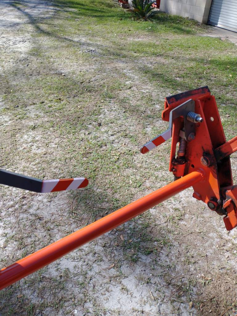

Sounds like the cross member between the lift arms at the quick connect have twisted. It happened to me once when my grapple came loose from one side. I cut the bent tubing out and replaced it with a solid steel bar. View attachment 731608
I like the bright "don't forgetem" paint on the quick attach levers.

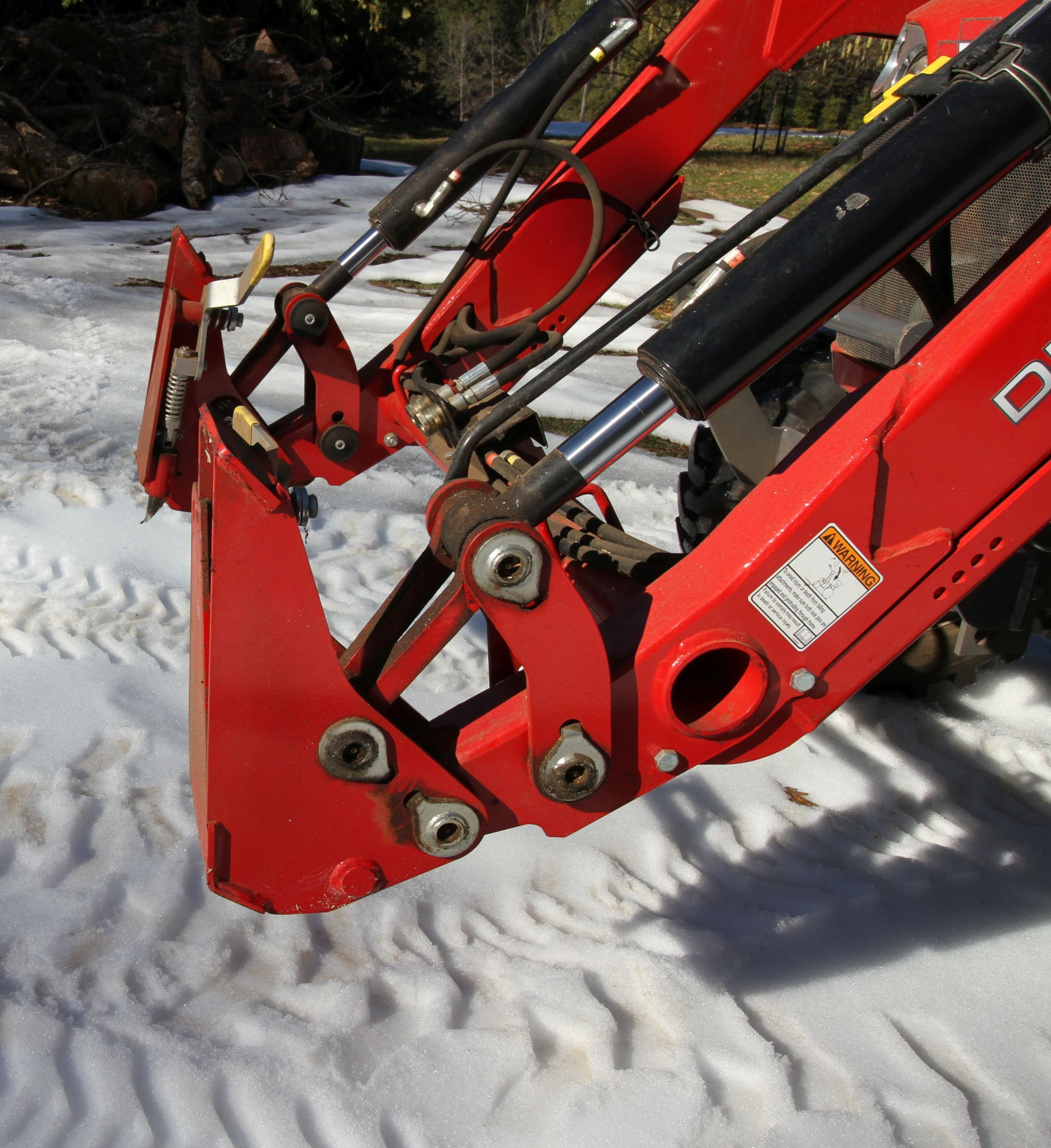

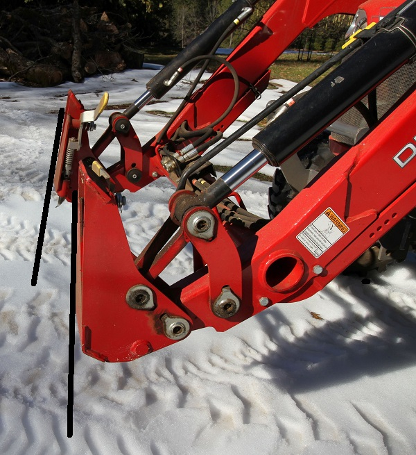

I checked the loader arms, torque tube, etc. I cannot find anything that looks bent or twisted. I'm not sure what exactly to look for other than general alignment. I did put a straight edge along the torque tube, on top and also on the side. It was plumb and not bent. Are there better ways to check for a bent loader arm?
Here is a pix of the two SSQA plates that are misaligned. btw, I measured the "chrome" part of the cylinder that is showing when this pix was taken. It's 2 7/8" of chrome on one side, and 3 1/2" of chrome on the other side. I kind of suspect that is where the problem is, but I don't really know. Seems one cylinder is extending more than the other.
Again, at full travel, both cylinders retract fully, and at full extension, one extends 1/4" longer than the other. So at max travel I have only 1/4" difference, but in this photo, with only partial travel, I have 5/8" difference.

It is a common problem, many threads about it. Here is one, easy to realign the QA using a shim
Thanks-- I will go check the stops on l/r sides.
