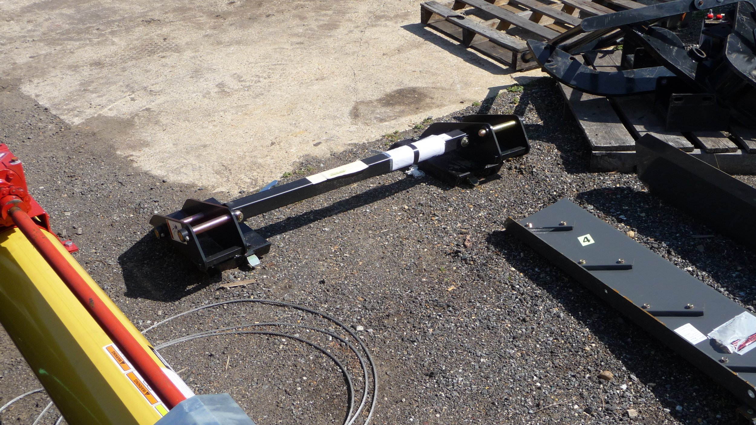

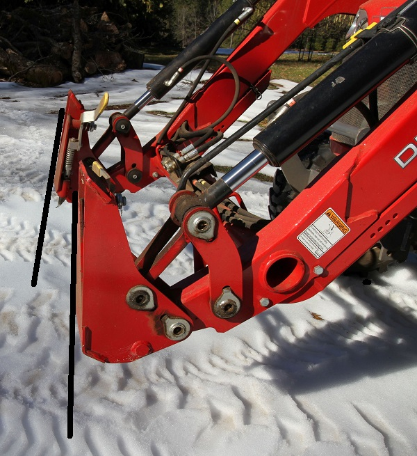

plowhog, It is easy to see that your cross tube is twisted:
Quite true. Whether we can see his torque tube or not, whatever is between the two shoes has to be, and is, twisted. Here is a picture below of my torque tube that goes on an SSQA for a Massey DL250 loader. [Black, with white shipping labels.] Since you cannot see the shoes mating with the attachments from the driver's seat I once caught the left side shoe under the lip of a 1000lb bucket and lifted it with the right one unknowingly not engaged. It bent this square torque tubing so badly I just replaced it since I lack a welder and fabrication tools.
So what the OP needs to do is to get the torque tube straightened (whether cut and rewelded or whatever. If I were you, I would reinforce the tube or replace it with one twice the diameter/thickness.) Once the tube is straight and the two shoes line up at the same vertical angle, his hyd cylinder will have the same "amount of shiny cylinder shaft exposed." The cylinders share equal hyd pressure via a common fitting and are NOT part of the problem. The cylinders are just along for the ride. A big waste of time to worry over or investigate the cylinders.
BUT the plot can thicken (and maybe has in the OP case...??) Besides the obvious torque tube twist, you MAY have a a slightly sprung loader frame. They are very hard to diagnose. Best I can suggest is find a perfectly flat concrete pad, make sure tire pressures are not radically different side to side, and then measure the vertical distance from the concrete to the bottom edge of steel where that 2.5 or 3" cross tube is in your loader frame -- whatever reference point is identical on both sides of the frame. One of those bolt heads? Whatever. If there is more than a half inch or so difference side to side you have a sprung loader frame. [I forgot if you measured this and told us before??] One visual (after fixing the torque tube) is to put a wide attachment with a flat top like a bucket on the loader frame and raise it to where you can barely see the top of the bucket on the far left or right from the drivers seat. At that point you should be able to see any significant twist in the loader frame. If you can't, it isn't worth worrying about.
Yes, I have unfortunate experience there. Involves an old locust tree stump. Suffice it to say the corner of a wide bucket is not the best thing to put huge lifting forces on, full power, 4WD, low gear, etc. You can bend a loader frame... and none of the loader manufacturers specify ANYTHING about torque on their products. Neither does the national tractor testing lab in Nebraska test for any such unlisted specs. If you can't/don't want to live with a sprung loader frame, you have a couple of options which I have described in a post here several years back. 1) You can spend upwards of $500 in a frame straightening rig at a big well equipped auto body shop (plus getting the thing off and back on...) or 2) You can go reverse spring it yourself until it is level. I did number 2 and it works as long as you agree with yourself to take the risk.

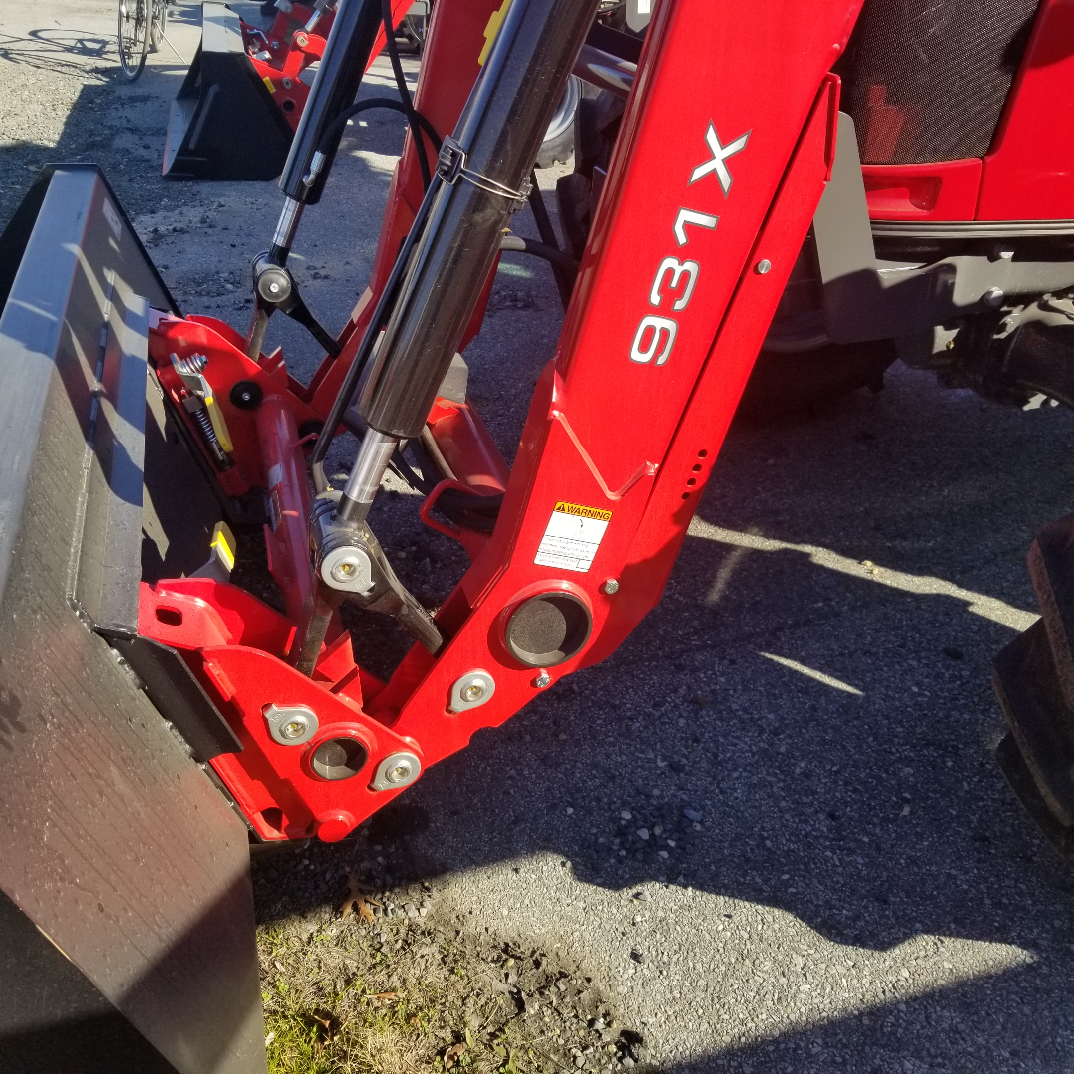

I must have the only orphan SSQA ever made.
Even in this brutal cold weather (0*F) I can simply push one side back, by hand, and the other side comes forward. Pushing on one side forces oil out of one cylinder and into the other. Of curse, the bucket or forks are assumed to be de-mounted.
In other words, my left and right SSQA attaching arms are completely independent of each other, and will float to wherever they need to, to be flush with the backside of the bucket or forks.

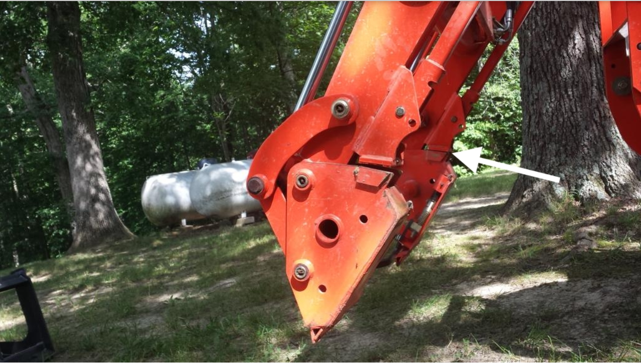

Would it be easier to use shims between the bump stops where the white arrow is pointing, then apply pressure in the dump direction? There will likely be "spring-back" so increasing shim thickness till it remains even when the pressure is released?
hi folks..gravelman here..i put in a shim on one side...fully rolled out bucket arms...it worked... thanks for that advice...
It is a common problem, many threads about it.
Here is one, easy to realign the QA using a shim: Bonehead Move, Need Advice, Loader Quick Attach won't hold
So your SSQA attachment on the loader lacks a torque tube between left and right. I've not seen a MF loader SSQA (in the last 15 years) without a torque tube between left and right. Some more stout than others. Notice this one below is a strong looking welded tube.
Just an opinion: I think that Massey was late coming around to having SSQA's for their loaders and giving in to the obvious truth that skid-steer compatibility is a good long-term advantage to most owners. In the Massey migration to installing SSQAs, I feel they were relatively weak and reflected a reluctance on the part of MF to do it. Dragging feet. Contrast that to Kubota who was way out front in equipping their loaders with skid-steer compatible interfaces long before the rest AND much stronger and looking like it was designed-in too.
